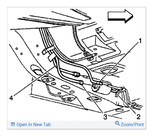

Where is the fuel filter? Normally it's outside the gas tank; someone told me it's inside the gas tank? Thank you!
Jan 15, 2022 at 12:18 PM
  • 110,244 POSTS

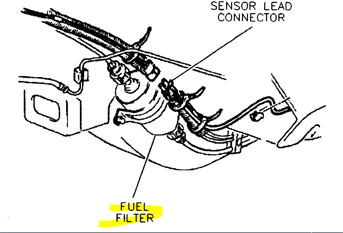

The fuel filter should be along the body/frame rail under the right side of the vehicle. I attached a pic below. Let me know if you find it.

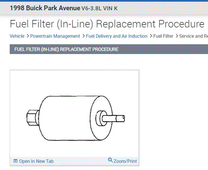

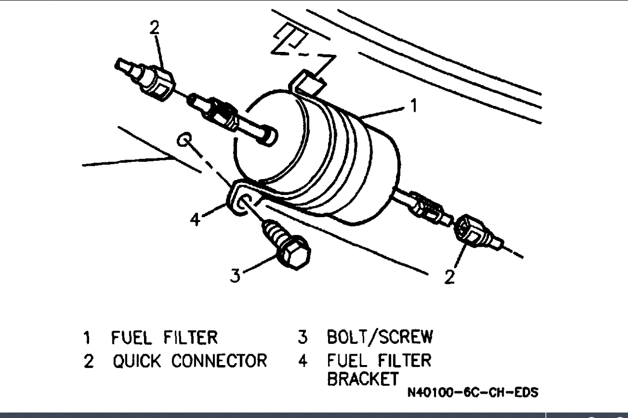

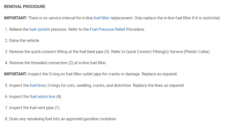

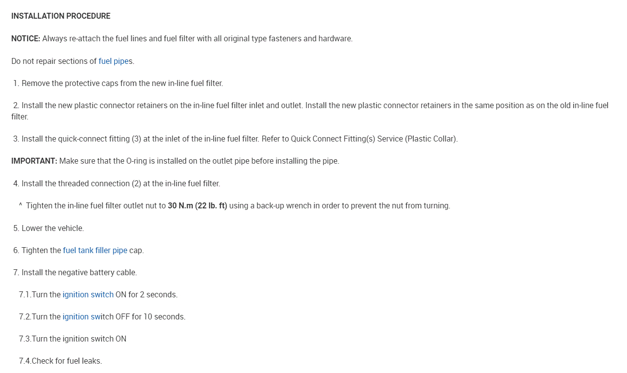

Pics 1 and 2 are to help locate it. The remaining pics are for the removal and replacement of it.
