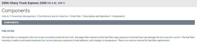

Fuel filter location on 2500.
They sold me one at O'reilly.
Jul 26, 2021 at 1:41 PM
MASTER ASE TECH
  • 82 POSTS

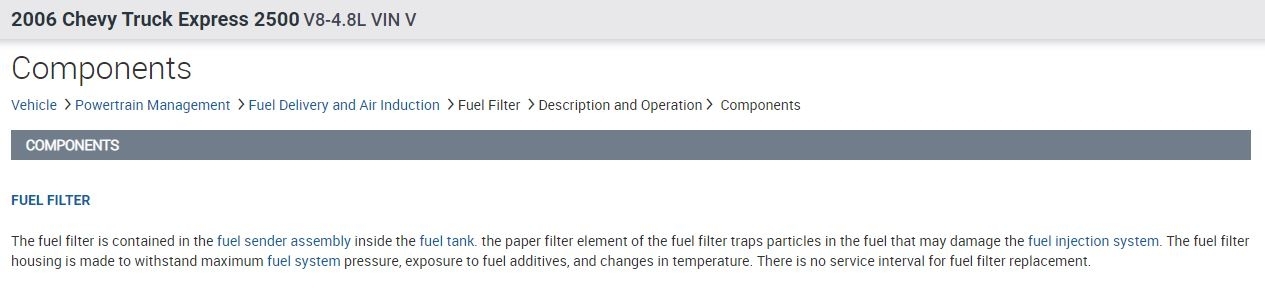

Hi, I'm Dan. The only fuel filter on your van is located inside the fuel tank on the fuel pump module. It's a strainer that usually is only changed during a fuel pump replacement. See the attached paragraph from AllData.
