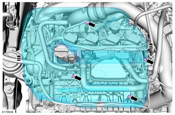

4. Remove the engine cover.
pic 2

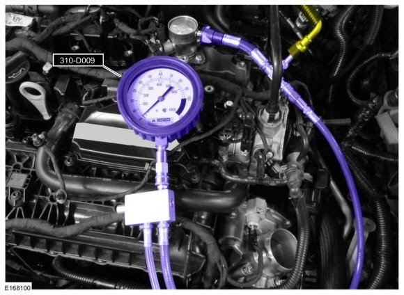

5. Disconnect the fuel jumper tube-to-high pressure fuel pump quick release coupling.
Refer to: Quick Release Coupling See: Fuel Line Coupler > Procedures > Quick Release Coupling (310-00A Fuel System - General Information - 1.5L EcoBoost (118kW/160PS), General Procedures).
6. Install the Fuel Pressure Test Kit between the fuel jumper tube and the fuel tube.
Use Special Service Tool: 310-D009 (D95L-7211-A) Fuel Pressure Test Kit.
pic 3
