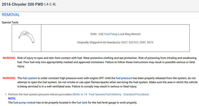

The fuel filter is inside the fuel tank and is meant to last the life of the fuel pump, here is how to change it out in case you still want to change the fuel filter.
Perform the fuel system pressure release procedure (Refer to 14 - Fuel System/Fuel Delivery - Standard Procedure).

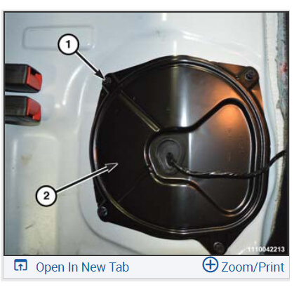

Remove the screws (1) that secure the fuel module cover (2) to the floor.

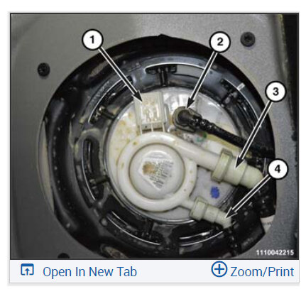

Lift up on the fuel pump module access cover and disconnect the wire harness connector (1).
Disconnect the fuel tank vapor lines (3, 4) from fuel pump module.
Disconnect the fuel line (2) from the fuel pump module.

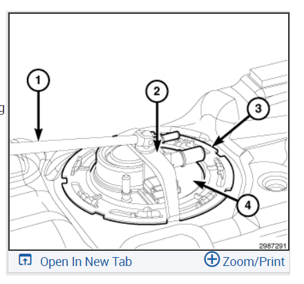

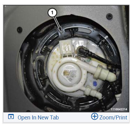

Position the lock-ring remover/installer (2) 9340 or into the notches on the outside edge of the lock-ring (3).
Install a 1/2 inch drive breaker bar into the lock-ring remover/installer.
Rotate the breaker bar counterclockwise and remove the lock-ring (1).

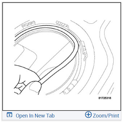

Remove and discard the rubber O-ring seal.
