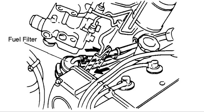

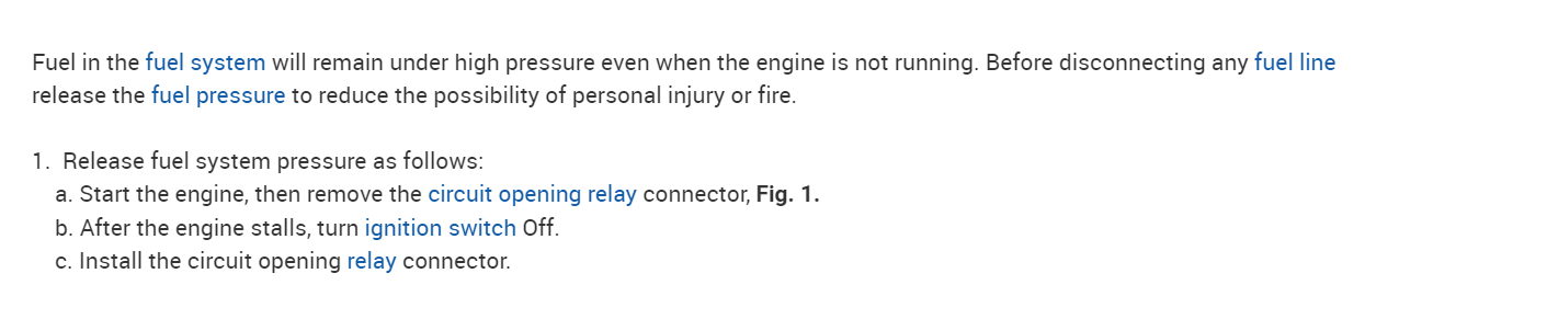

Looking for fuel filter location.
Jul 5, 2019 at 12:06 PM
SCGRANTURISMO
  • 4,897 POSTS

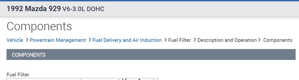

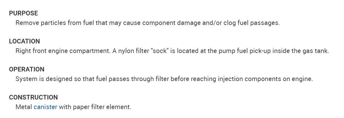

The fuel filter is located in the right front of the engine. I have included a diagram along with the description of the location in the diagrams down below. Please get back to us with how everything turns out, or if you have any other vehicle related questions.

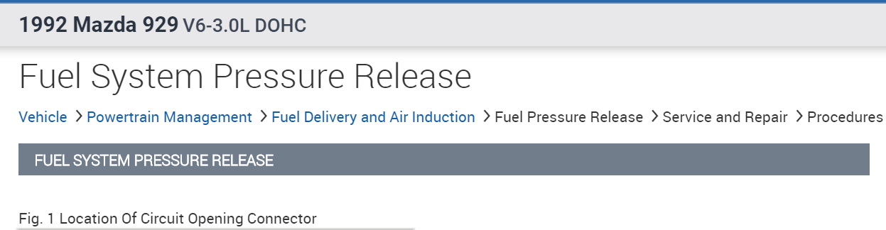

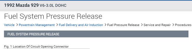

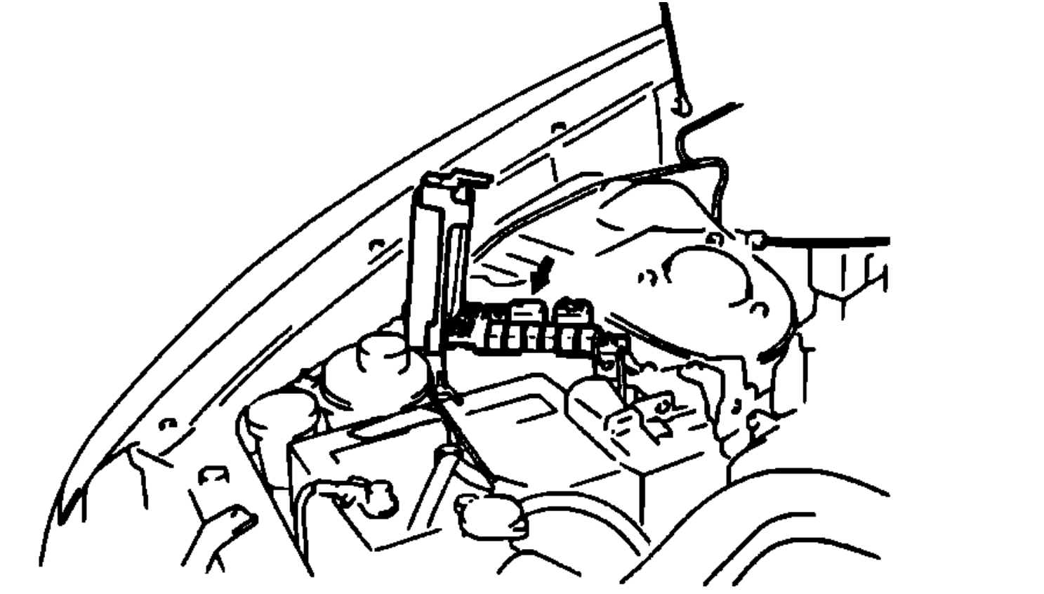

Where is the Schrader valve for the fuel located?
Jul 5, 2019 at 1:40 PM
SCGRANTURISMO
  • 4,897 POSTS
Hello again,
There isn't a schrader valve for your vehicle's fuel system. In the diagrams down below I have included the instructions for relieving the fuel pressure from your vehicle's fuel system.
