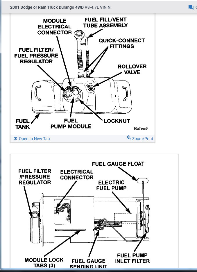

I have the vehicle listed above I would like to know where my fuel filter is?
Sep 23, 2020 at 11:14 AM

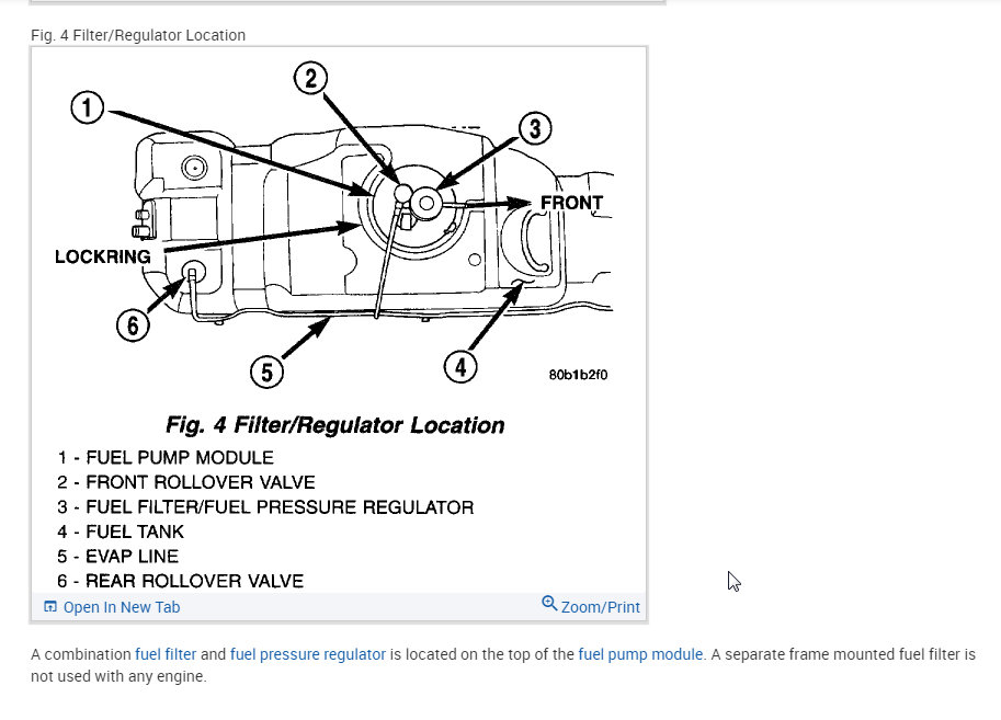

I attached the info for this filter. It is located in the tank as part of the pump. It does not require replacement unless you have another reason to replace it like the pump fails or you drop the tank for something else.
Let us know if you need other info. Thanks
