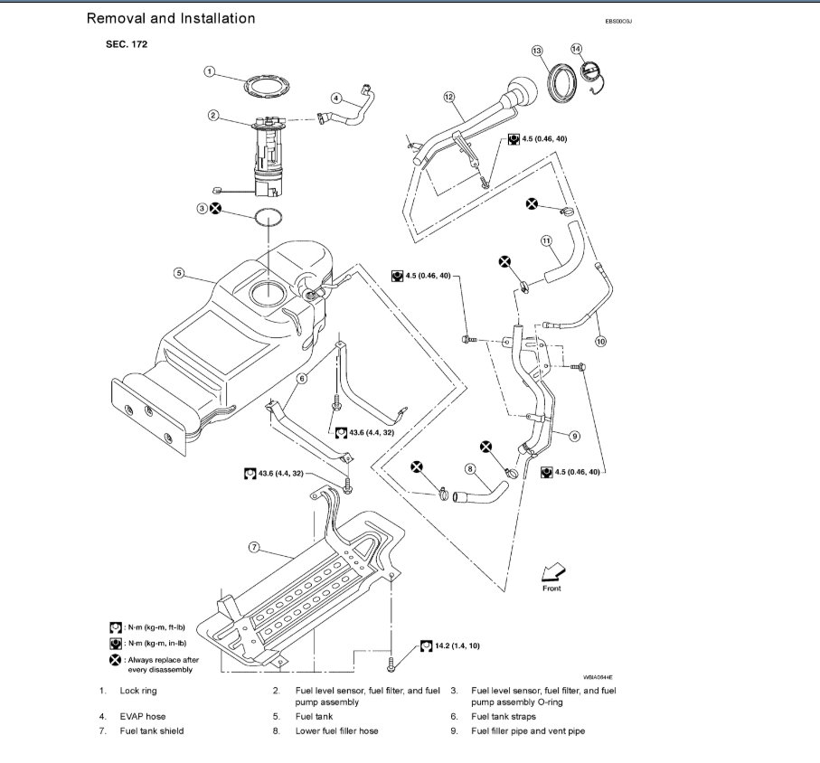

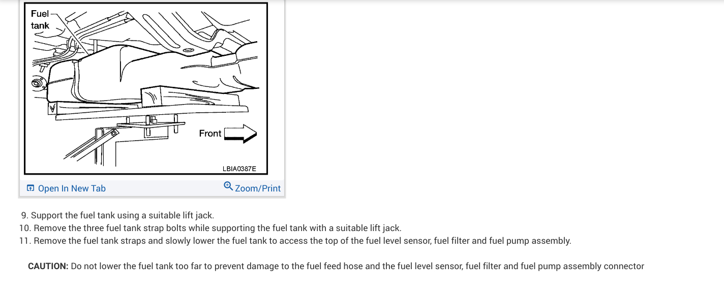

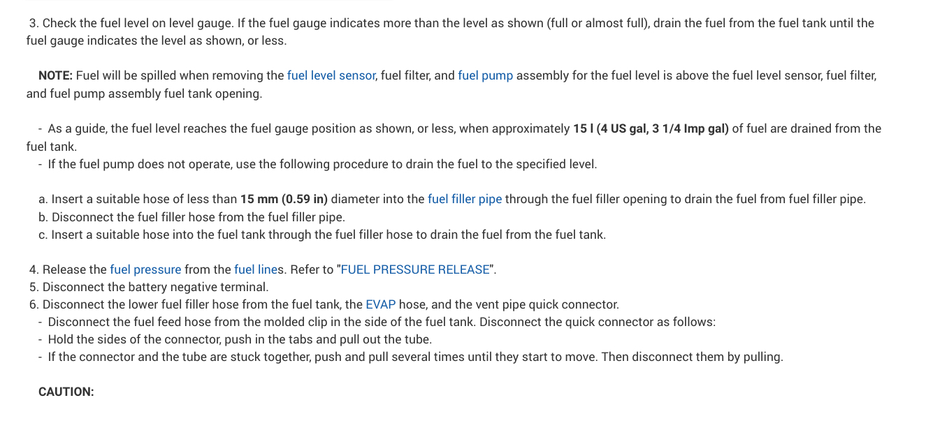

Hi, i would like to know where is the fuel filter is?
Dec 8, 2019 at 2:31 AM
SCGRANTURISMO
  • 4,897 POSTS

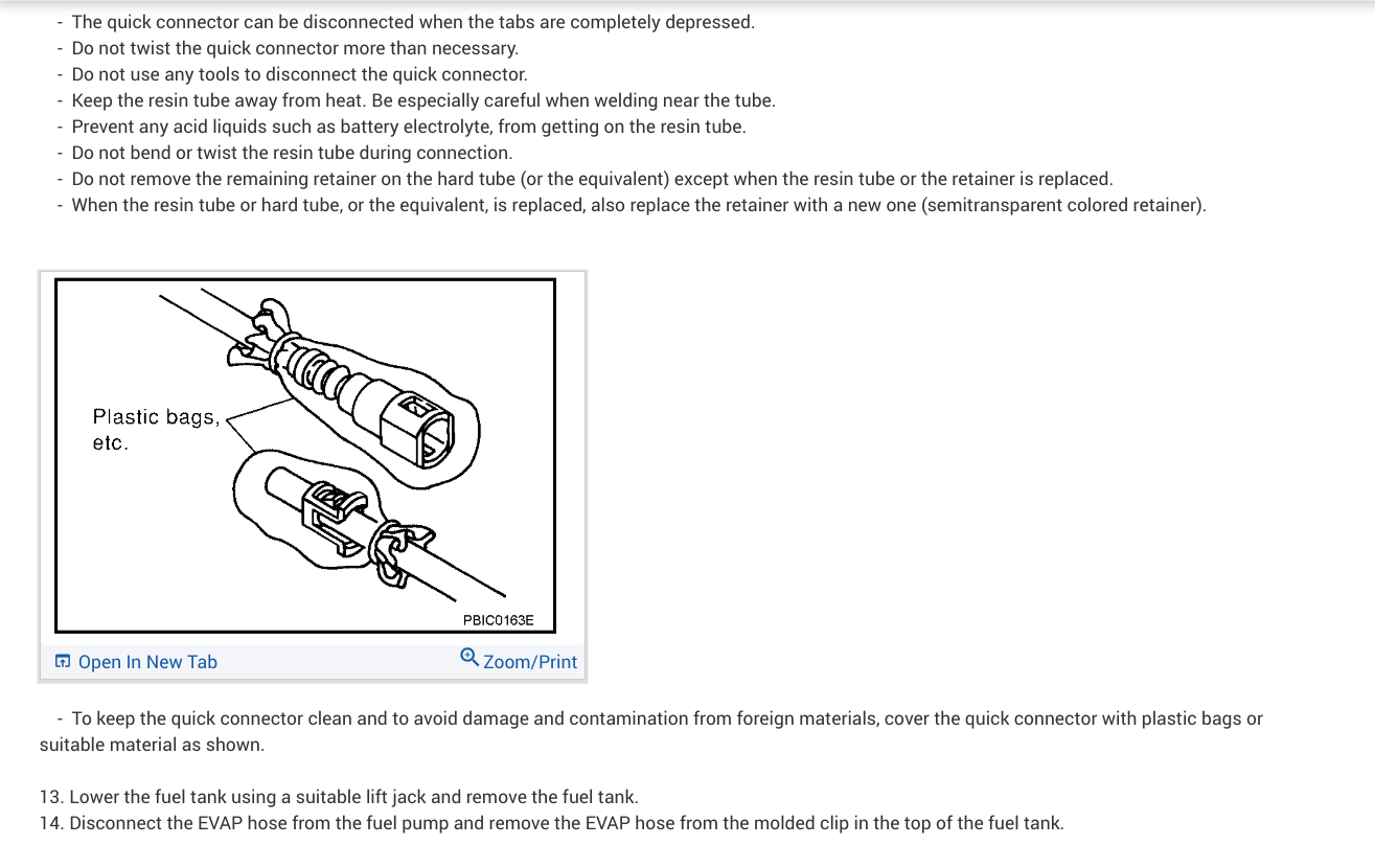

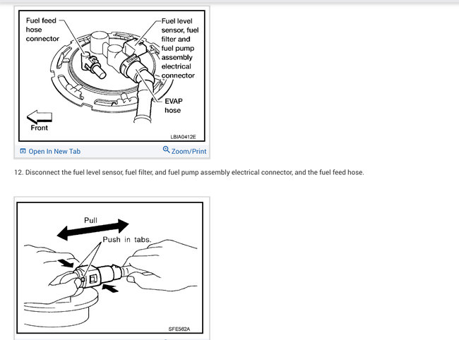

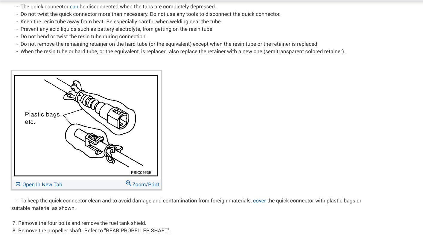

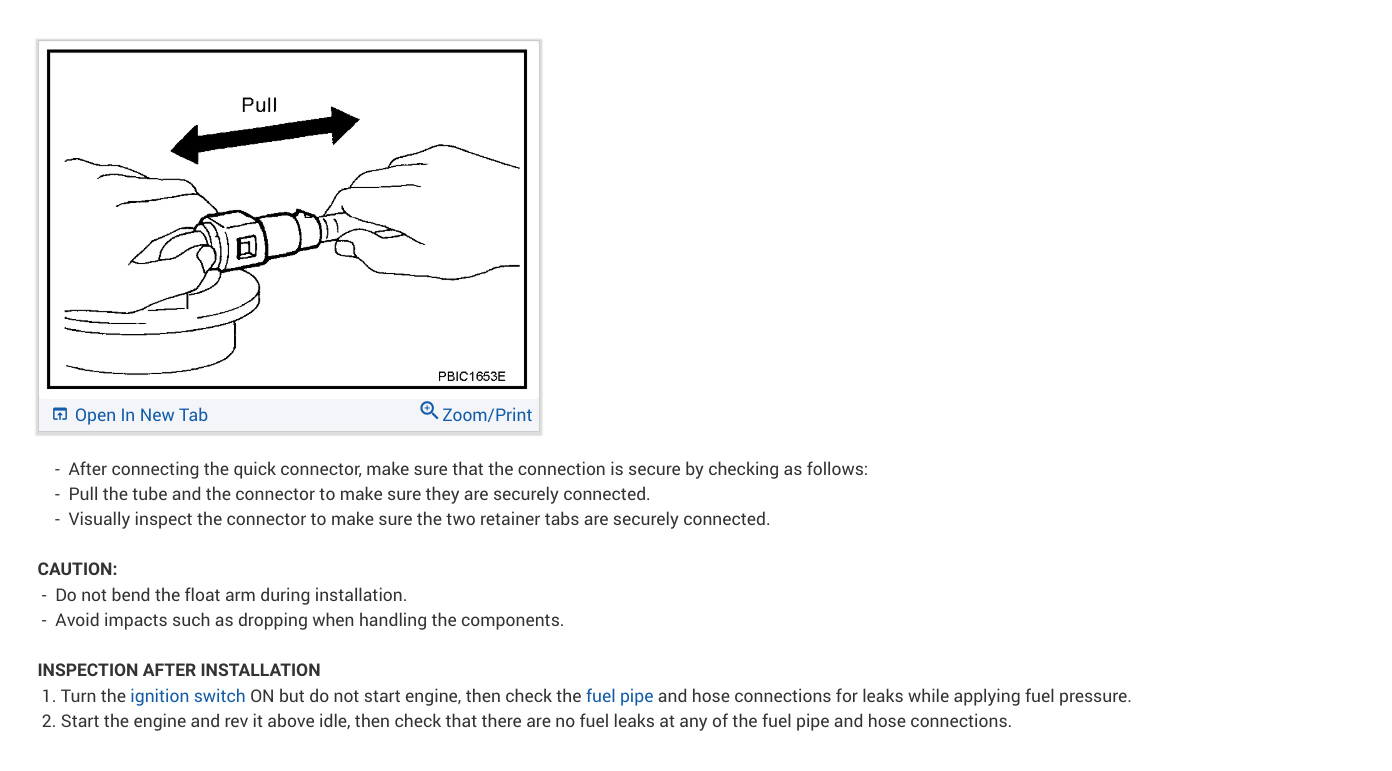

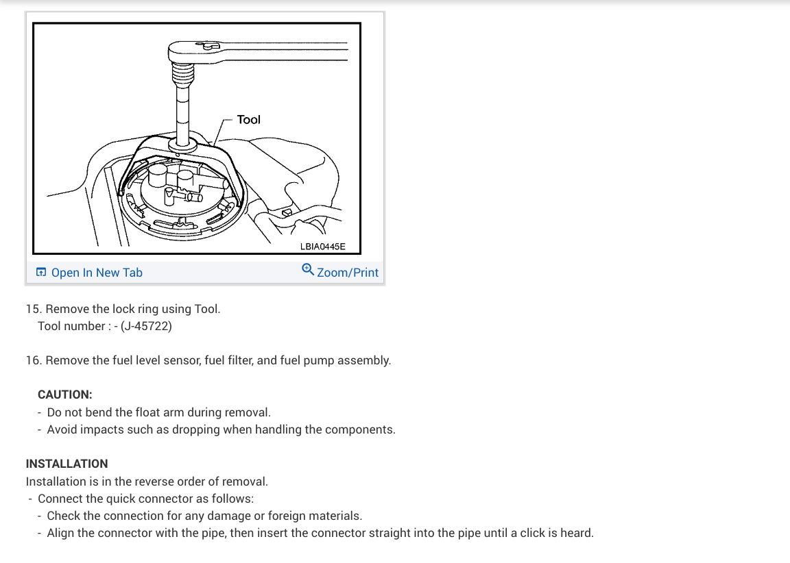

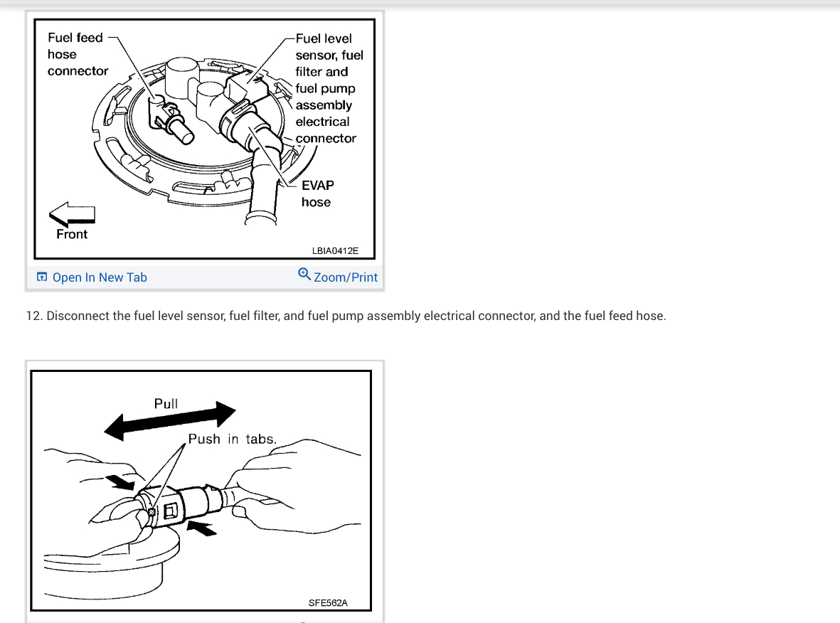

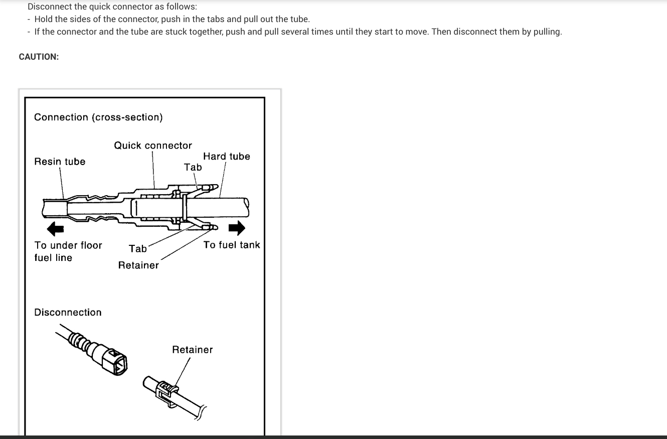

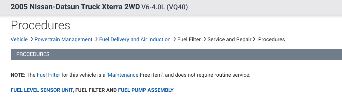

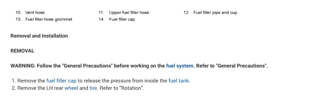

The fuel filter is an integral part of the fuel pump assembly on your vehicle. Here is a link below with a generic guide explaining how to change a fuel filter:
https://www.2carpros.com/articles/how-to-change-a-fuel-filter

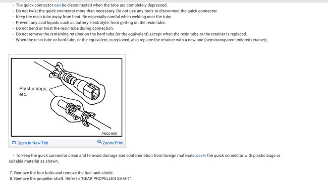

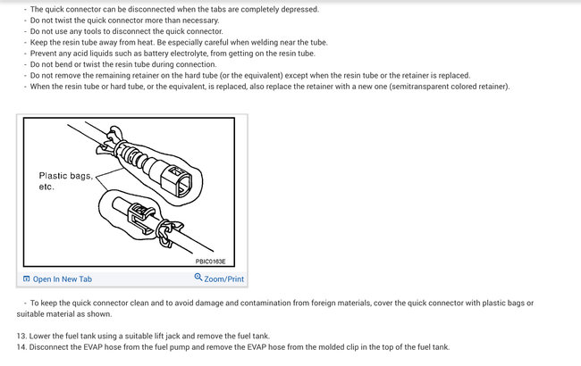

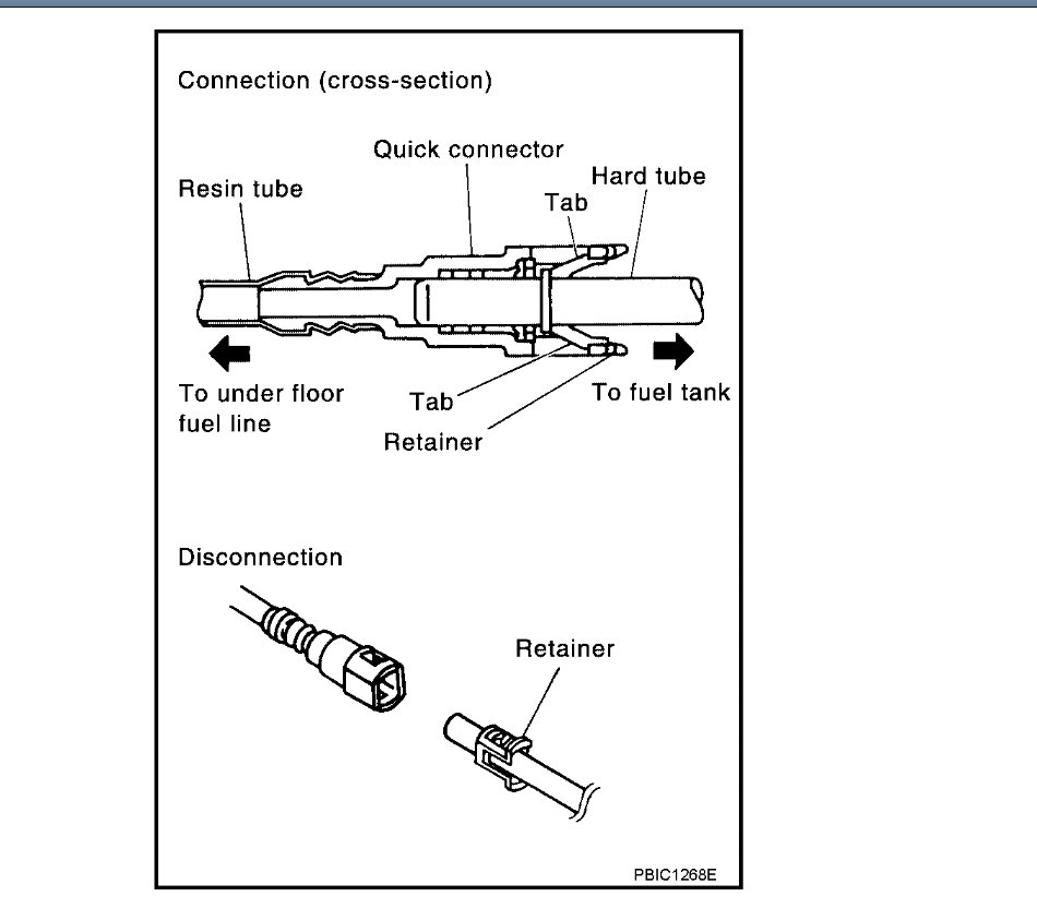

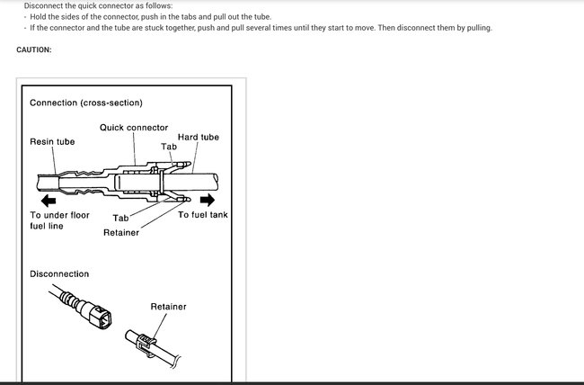

In the diagrams down below I have included the step by instructions for the removal and installation of the fuel filter in your specific vehicle. Please go through these guides and get back to us with how everything turns out.
