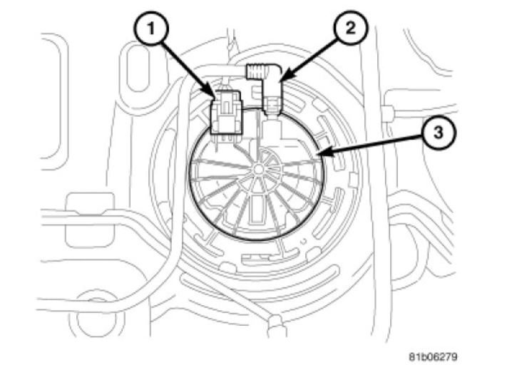

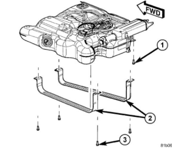

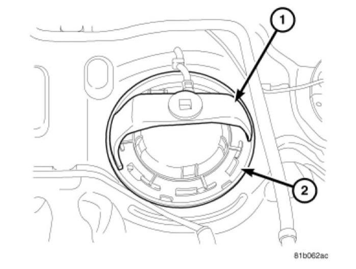

I attached pictures of the module for you below.
REMOVAL
1. Remove fuel tank,See: Fuel Tank > Removal and Replacement > Fuel Tank - Removal.
2. Disconnect electrical connector (1) from fuel pump module (3).
3. Disconnect fuel line (2) quick connect from fuel pump module (3).
CAUTION: Clean the area around fuel pump module prior to removal. Make sure this area is free of dirt. Failure to clean fuel pump area prior to removal may cause dirt to get into the fuel system causing damage to the fuel system and/or engine.
4. Clean the area around fuel pump module with suitable cleaner and dry with low pressure filtered compressed air.
5. Install fuel pump module lock ring tool 9340 (1) and turn counter-clockwise to remove the fuel pump module lock ring (2).
6. Remove the fuel pump module as an assembly from the fuel tank.
