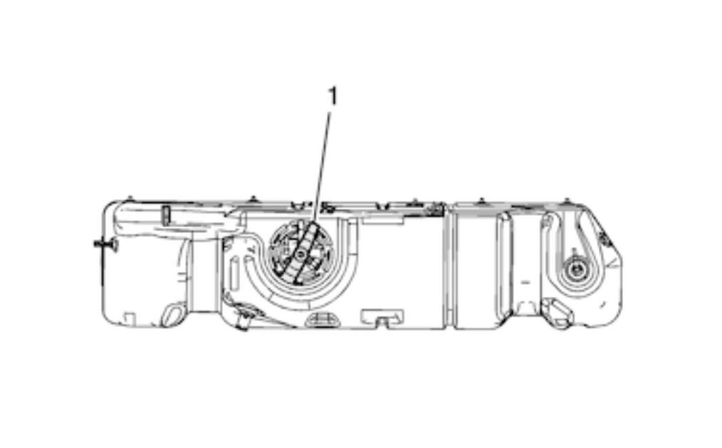

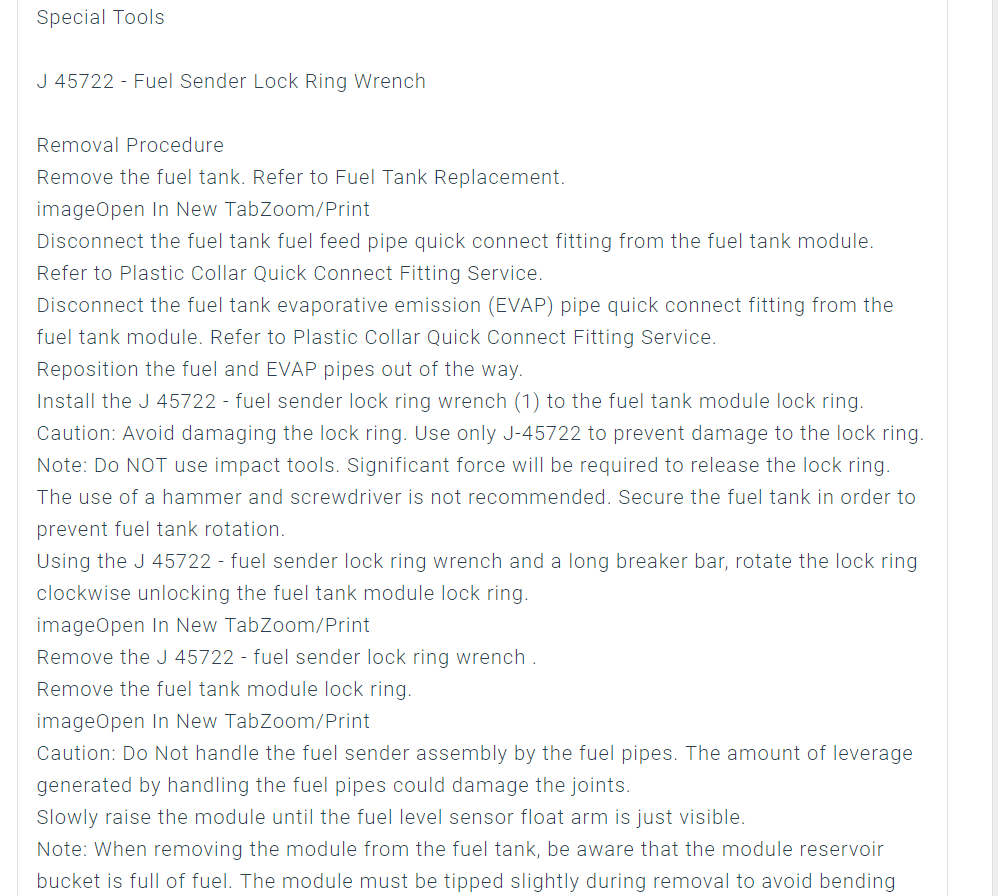

My truck listed above 1500 LT model has been cranking funny like it’s not getting enough fuel. I want to replace the fuel filter if possible. Just don’t no where it’s located.
Dec 3, 2020 at 3:48 AM
Good afternoon,

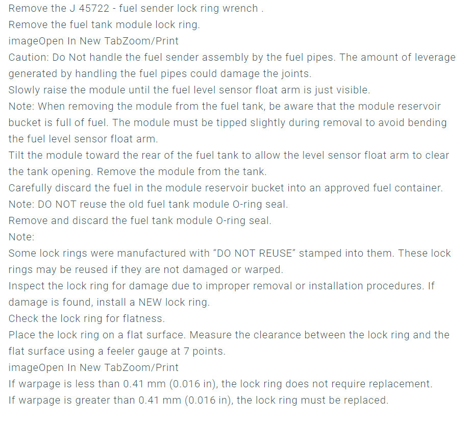

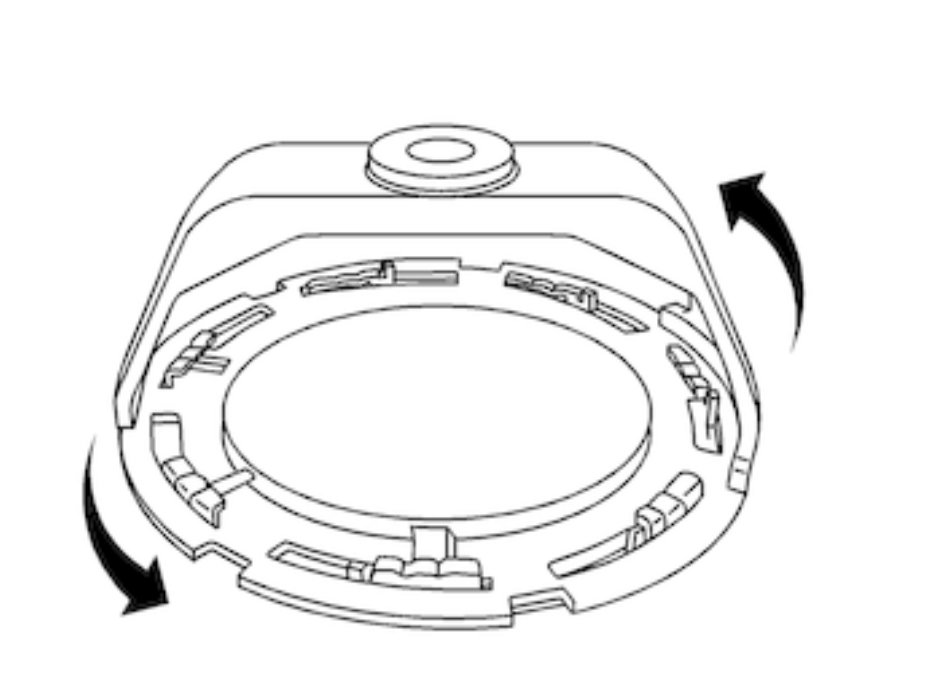

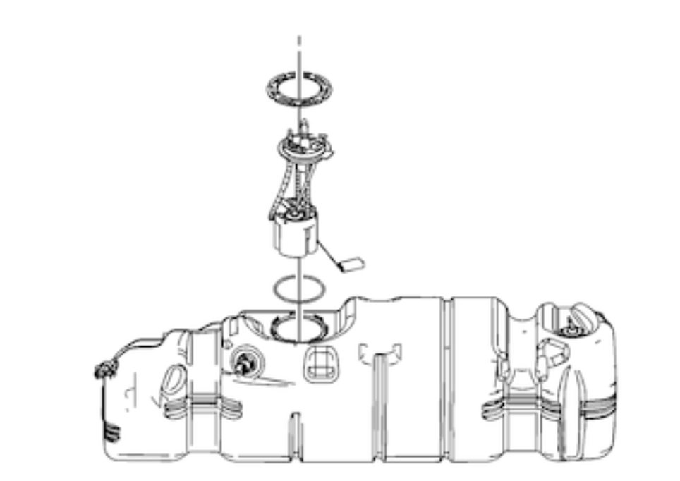

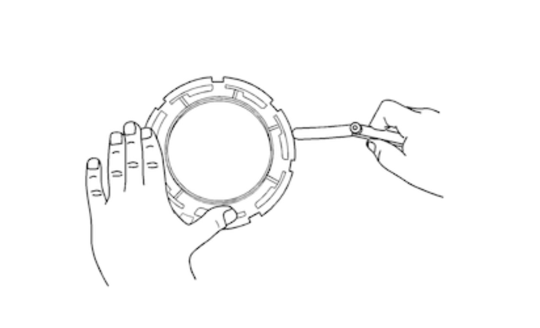

The filter is part of the fuel pump module in the tank. They no longer offer external fuel filters.
https://www.2carpros.com/articles/how-to-change-a-fuel-filter
I attached the procedure for the replacement below for you. Let us know if you have any other questions.
