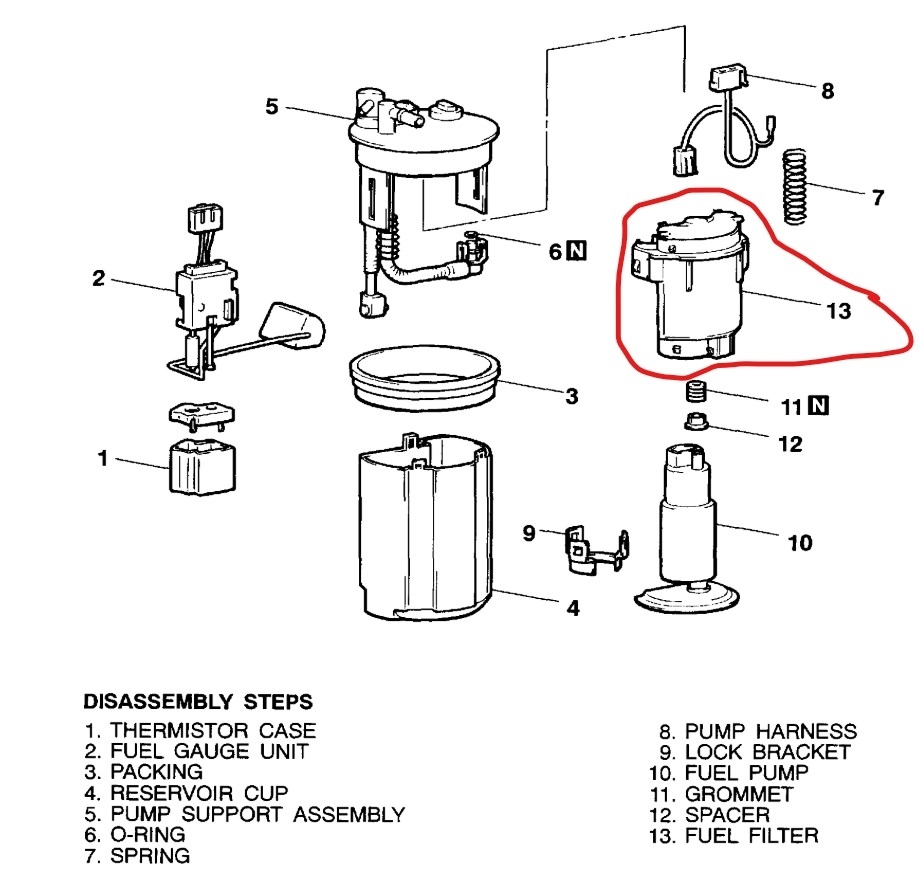

Where is the fuel filter located

It is inside the gas tank as part of the fuel pump assembly. It is replaceable MR431089 but if you are going to pull the pump it's generally faster and easier to replace the complete assembly if it has a lot of miles on the vehicle.
