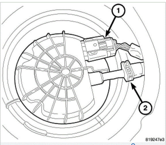

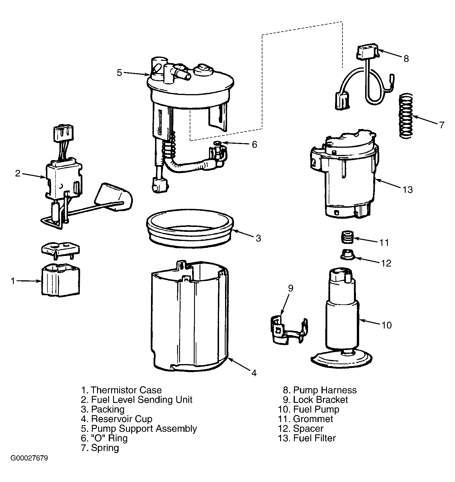

Trying to locate the fuel filter.
Jul 18, 2020 at 1:14 PM
  • 110,240 POSTS

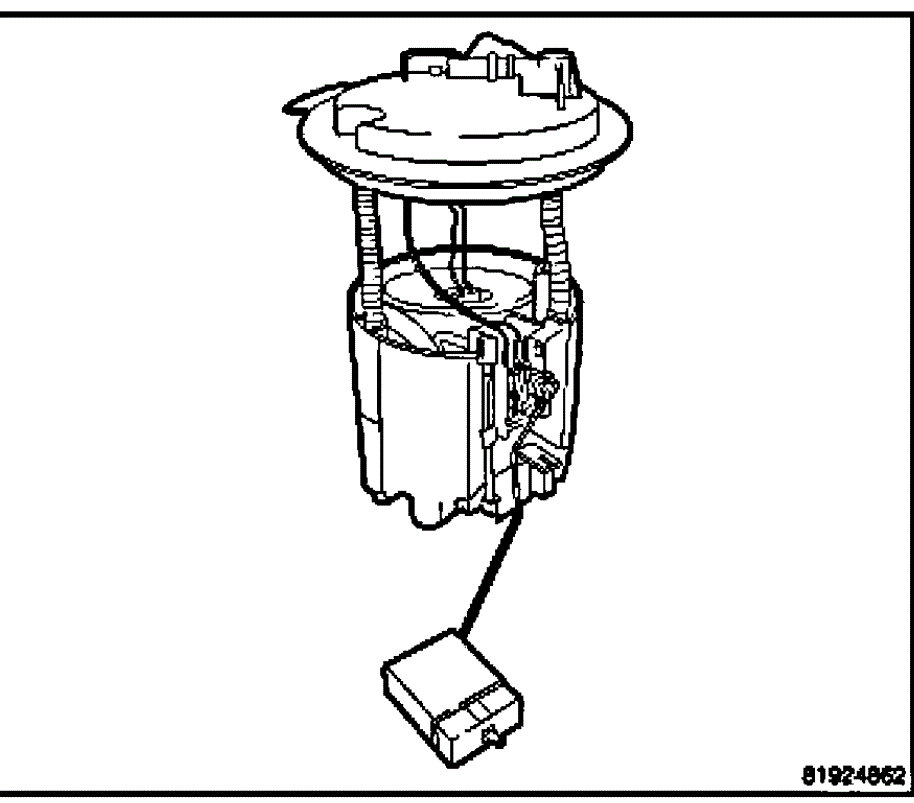

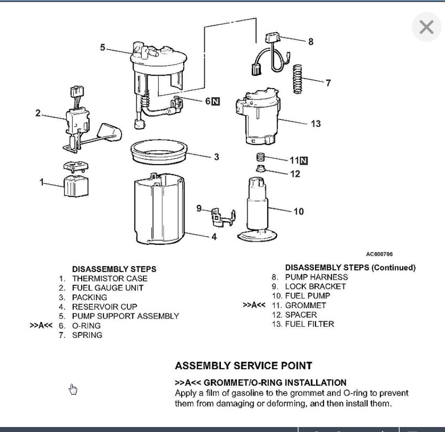

The fuel filter is located in the fuel tank and is part of the fuel pump module which includes the pump, fuel level sending unit, and fuel pressure regulator. I attached a pic of the module below. The filter can't be seen in this pic, but fuel is drawn through it by the pump and then distributed to the engine.
To replace it requires removal of the fuel pump module and replacement of the filter / regulator. Here are directions for removal of the fuel pump assembly. The remaining pics correlate with these directions.
__________________________________________
2007 Chrysler Sebring Sedan L4-2.4L
Removal
Vehicle Powertrain Management Fuel Delivery and Air Induction Fuel Pump Service and Repair Removal and Replacement Fuel Pump Module Removal
REMOVAL
REMOVAL

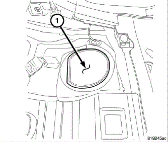

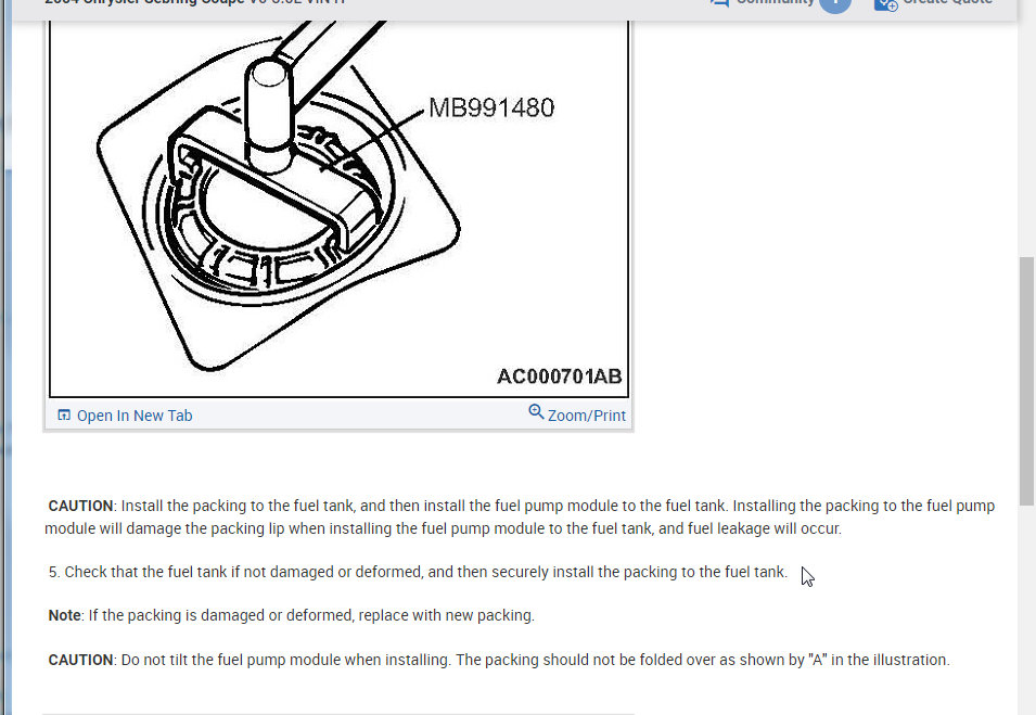

pic 2
1. Release fuel pressure.
2. Remove Fuel Tank.
WARNING: The fuel reservoir of the fuel pump module does not empty out when the tank is drained. The fuel in the reservoir will spill out when the module is removed.

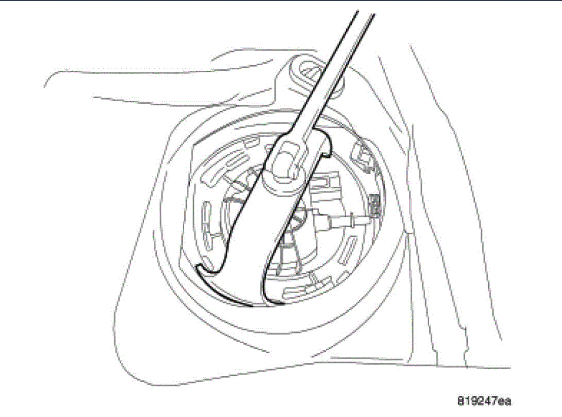

3. Disconnect fuel line from fuel pump module by depressing quick connect retainers with thumb and fore finger.
4. Slide fuel pump module electrical connector lock to unlock.
5. Disconnect the electrical connection from the fuel pump module, by pushing down on connector retainer and pulling connector off of module.

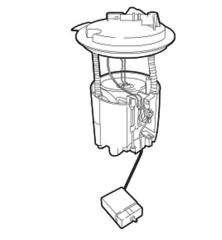

pic 3

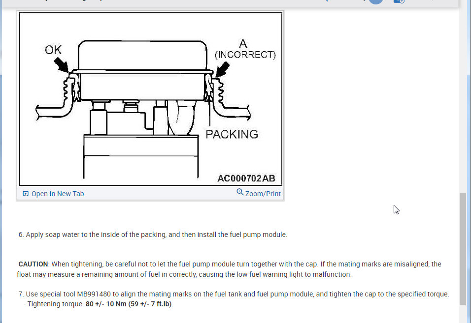

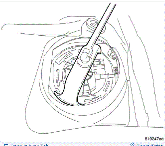

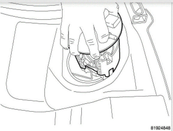

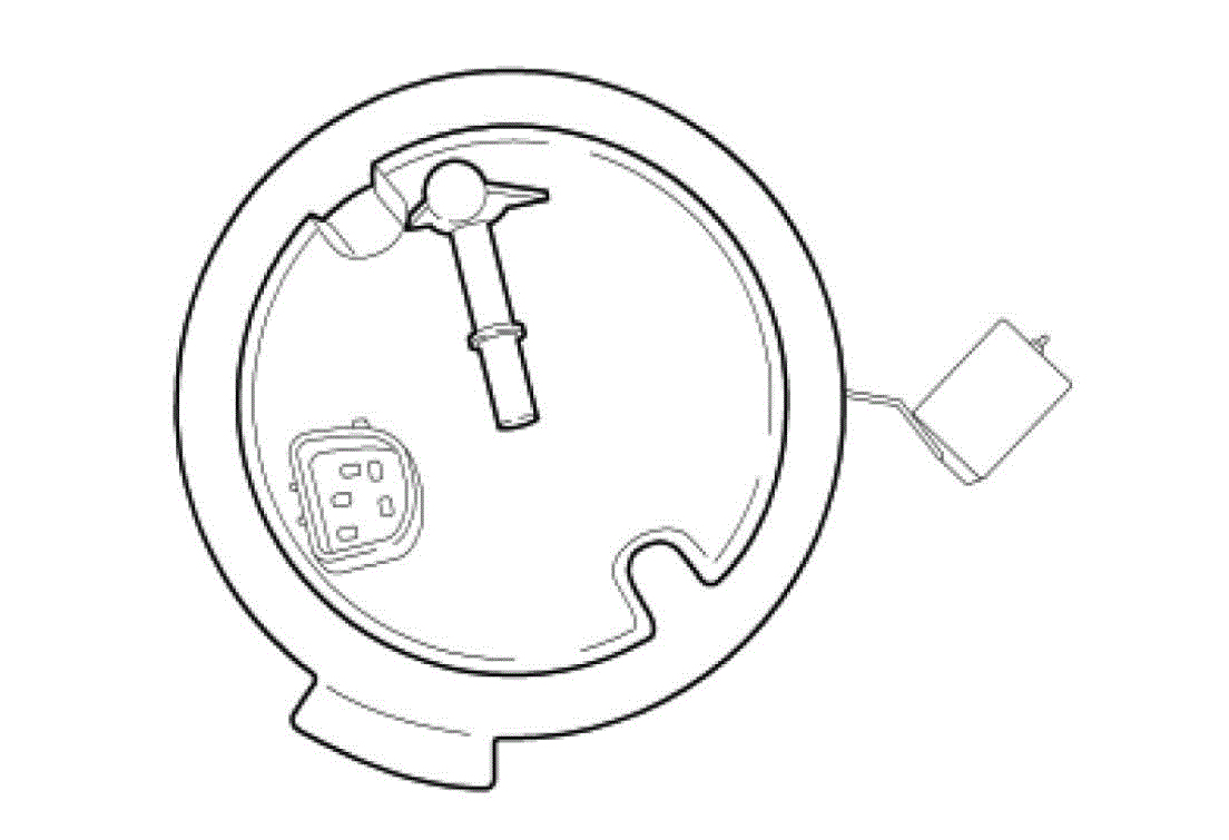

6. Mark fuel pump location.

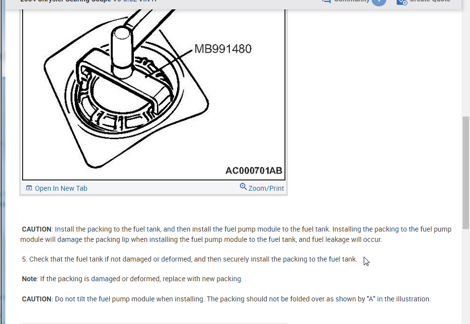

pic 4

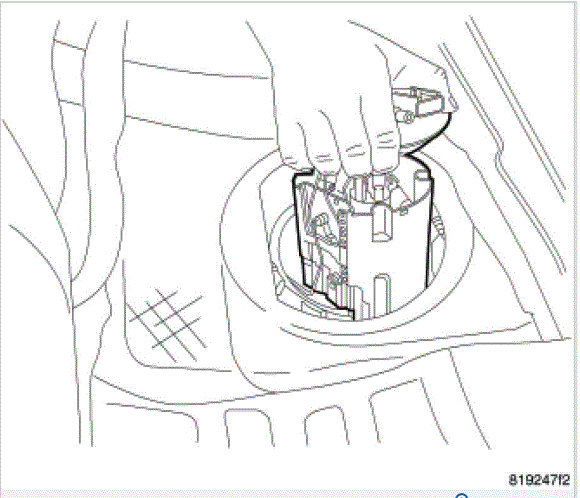

7. Use special tool 9340 to remove module lock ring.

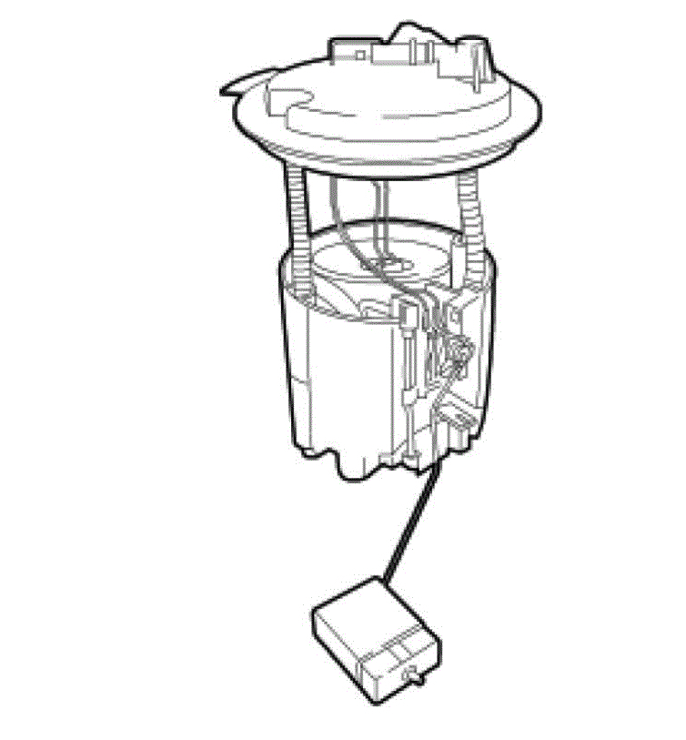

pic 5
8. Remove fuel pump and O-ring seal from tank. Discard old seal.

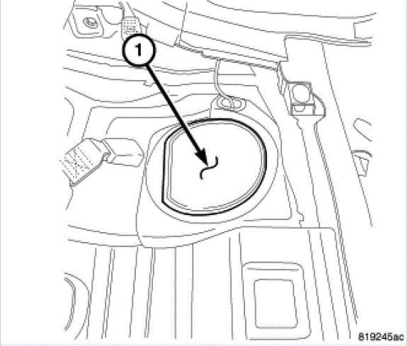

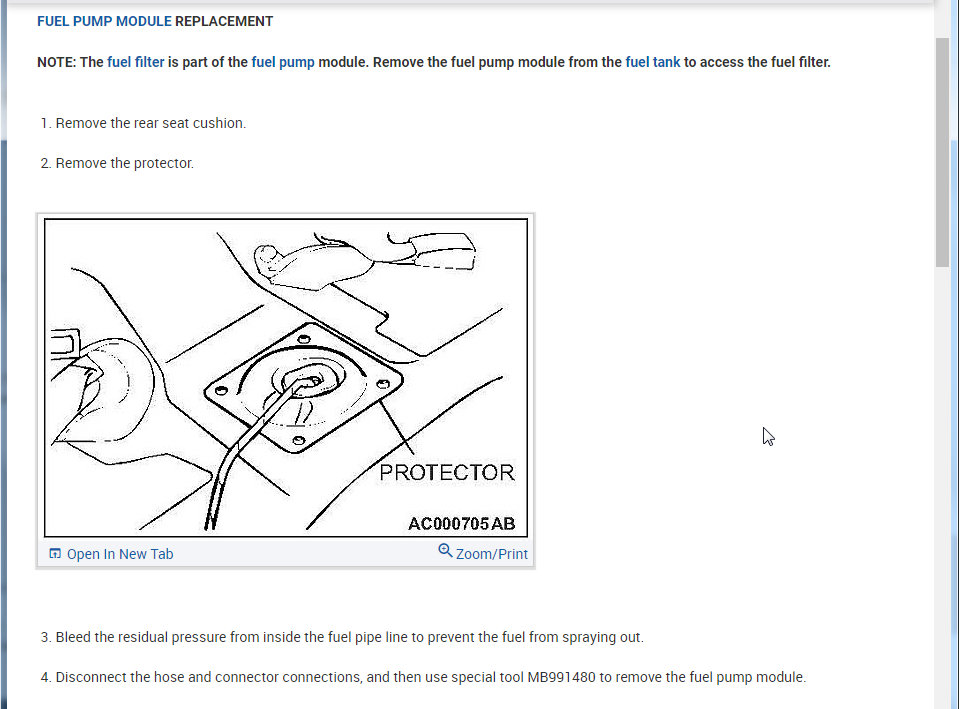

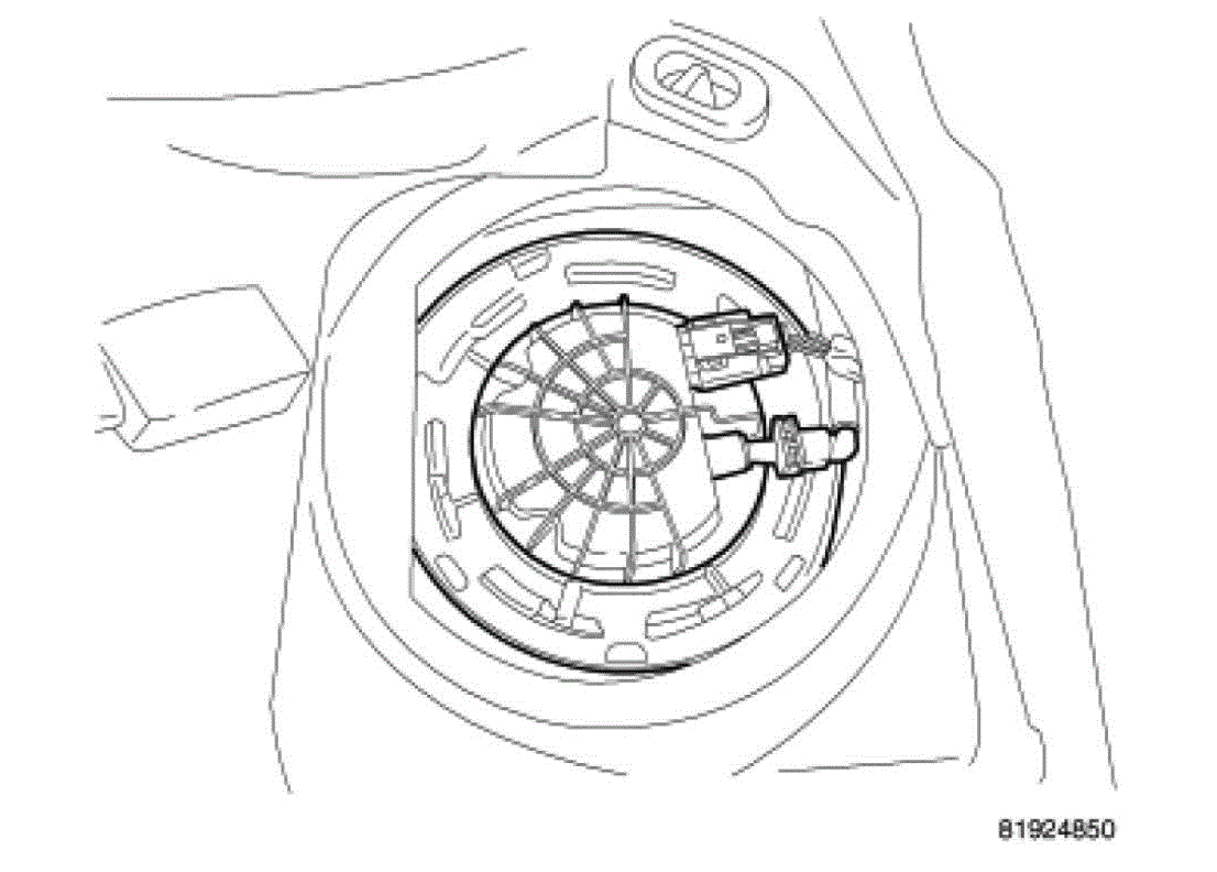

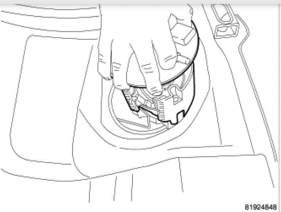

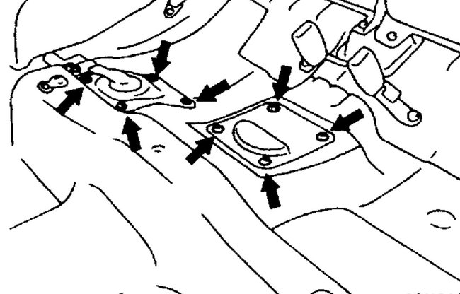

Note that it says remove the fuel tank (number 2 above). The fuel pump module is accessible through a service port under the rear seat. Here are the directions for that .
REMOVAL
WARNING: Release fuel system pressure before servicing fuel system components. Service vehicles in well ventilated areas and avoid ignition sources. Never smoke while servicing the vehicle. This may result in personal injury or death.

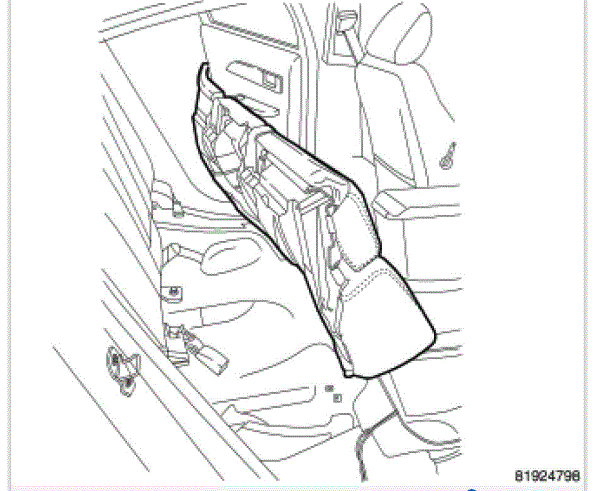

pic 6
1. Remove fuel filler cap and perform Fuel System Pressure Release procedure.
2. Disconnect negative cable from battery.
3. Remove the rear seat cushion.
pic 7
4. Remove plastic cover.
pic 8
5. Clean top of tank to remove loose dirt and debris.
6. Slide fuel pump module electrical connector lock to unlock and disconnect electrical connector. Remove fuel line connector from pump module.
pic 9

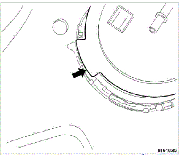

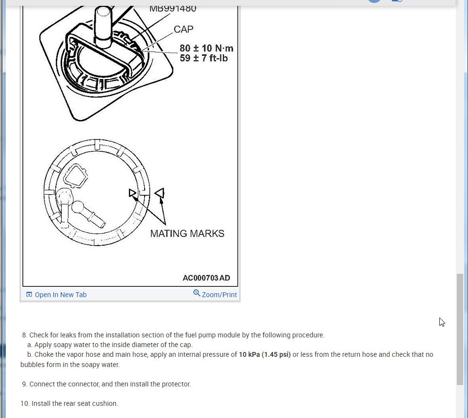

7. Use special tool Spanner Wrench #9340 to remove module lock ring.
pic 10
8. Note the fuel pump location on the top of the fuel tank.
NOTE: The pump has to be properly located to the tank for the fuel gauge to work properly.

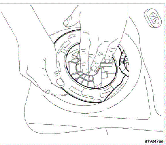

pic 11
9. Push down on fuel pump module and remove lock ring.
pic 12
10. Pull module up out of fuel tank, make sure that you do not spill fuel inside of vehicle.
pic 13
11. Drain fuel from fuel pump module. Do not spill fuel in interior of vehicle.

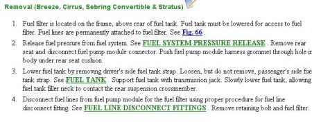

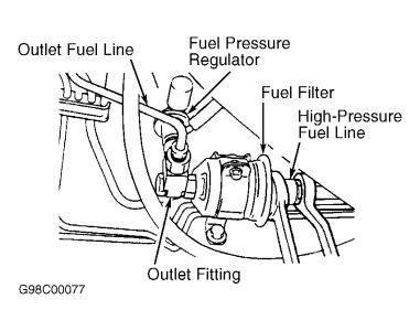

SHEILA63
Six cylinder two wheel drive automatic 100,000 miles. Where is the fuel filter located on the above make/model vehicle?
Jan 29, 2021 at 3:08 AM (Merged)

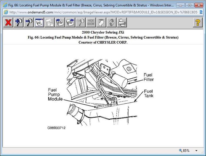

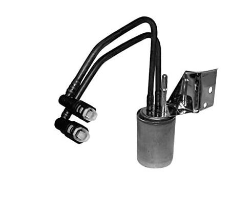

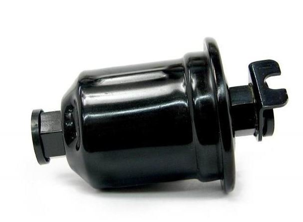

ZACKMAN
  • 4,202 POSTS
https://images.2carpros.com/forum/automotive_pictures/55316_00sebringlxifuelfilter_1.jpg
https://images.2carpros.com/forum/automotive_pictures/55316_00sebringlxifuelfilter_2.jpg
https://images.2carpros.com/forum/automotive_pictures/55316_00sebringjxifuelfilter1_1.jpg
https://images.2carpros.com/forum/automotive_pictures/55316_00sebringjxifuelfilter_1.jpg
https://images.2carpros.com/forum/automotive_pictures/55316_00sebringjxifuelfilter2_1.jpg

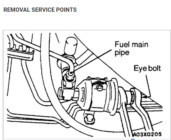

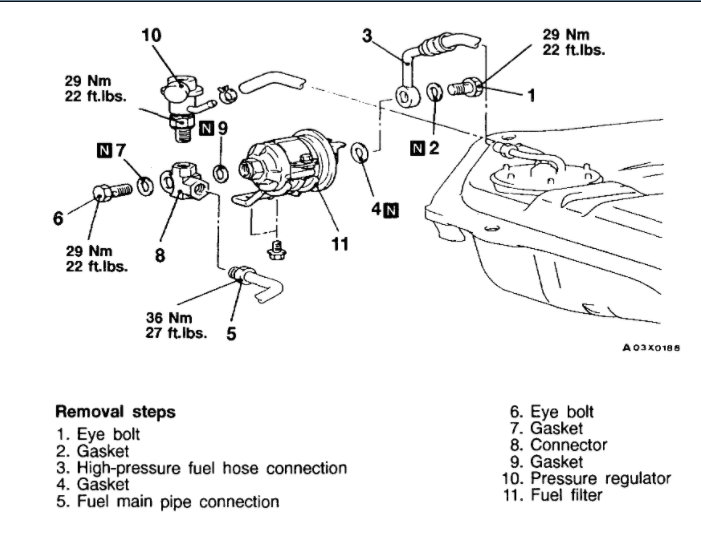

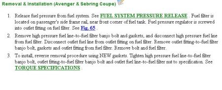

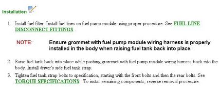

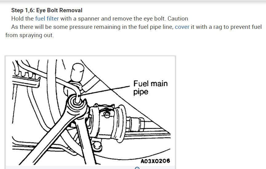

LIONKINGCMSL
Where the devil is the fuel filter on the vehicle?
I have a Haynes manual and the official Chrysler service manual and the fuel filter is "not" located on the rear frame rail/cross-member. I see where it should be mounted, but it is not there.
Thanks for any assistance.
DANNY L
  • 5,648 POSTS
Hello, I'm Danny.
Here is a tutorial showing how to replace a fuel filter:
https://www.2carpros.com/articles/how-to-change-a-fuel-filter
I've attached picture steps below showing the location and how to replace the fuel filter on your car. Hope this helps and thanks for using 2CarPros.

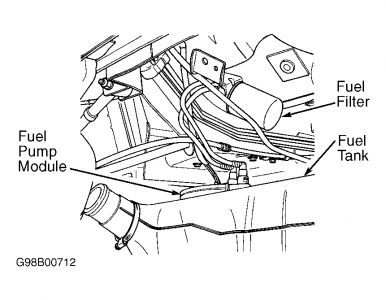

LIONKINGCMSL
Unfortunately, you did not answer my question of where exactly the fuel filter is located.
Why do I have the sinking feeling the fuel tank will have to be dropped?
STEVE W.
  • 15,340 POSTS
Both the convertible and the coupe used a frame mounted fuel filter. On the coupe it was normally mounted just in front of the tank as the above shows and looks like the first image. On the convertible it is stuffed between the top of the tank and the frame rail at the rear of the tank near the filler neck and looks like the attached image.
Other than the Sebring name the two cars share no other parts. If neither filter is there then somewhere along the line the fuel system was modified to omit the external filter and it is only using the in tank strainer. In that case you are correct and you would need to get to the pump module to change the strainer.
On the coupe you can do that without dropping the tank, there is an access panel under the rear seat. On the convertible the tank has to come out, but it also needs to be lowered at least on the driver's side to replace the filter.
