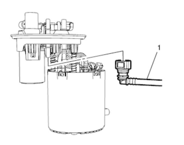

Hello there,
Anyone know where is the fuel filter located in the car listed above?
Thanks!
Jay
Apr 24, 2020 at 11:10 AM
Good afternoon,

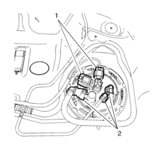

GM no longer has an external fuel filter. The filter is now part of the fuel pump assembly itself.
This guide should help
https://www.2carpros.com/articles/how-to-change-a-fuel-filter
It is not recommended to be changed unless the fuel pump itself is being replaced.
Please check out the diagrams below. Roy
