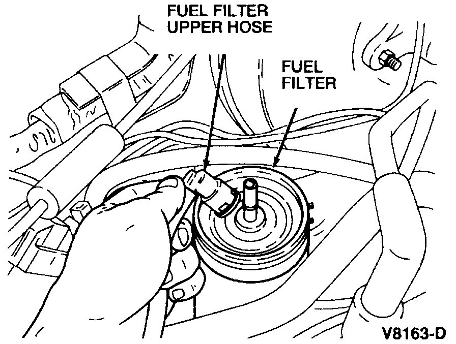

Want to change fuel filter.
Mar 12, 2021 at 10:56 PM
  • 110,248 POSTS
The fuel filter is under the hood near the brake master cylinder. See pic 1.

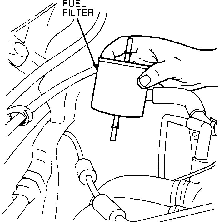

Fuel Filter
pic 2

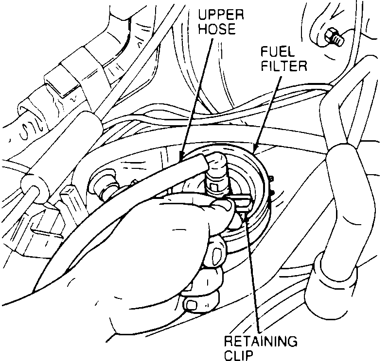

4. Remove the retaining clip from the filter upper hose.
Fuel Filter
pic 3
5. Disconnect the upper hose from the filter and drain any excess fuel into the container. Plug the hose.

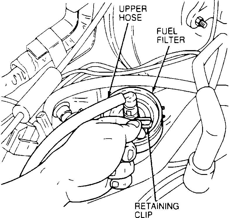

6. Loosen the fuel filter mounting clamp.
7. Raise the vehicle.
8. Remove the retaining clip from the lower filter hose.
9. Disconnect the lower hose from the fuel filter and drain any excess fuel into the container. Plug the hose.
10. Lower the vehicle.
Fuel Filter
pic 4
11. Remove fuel filter.
