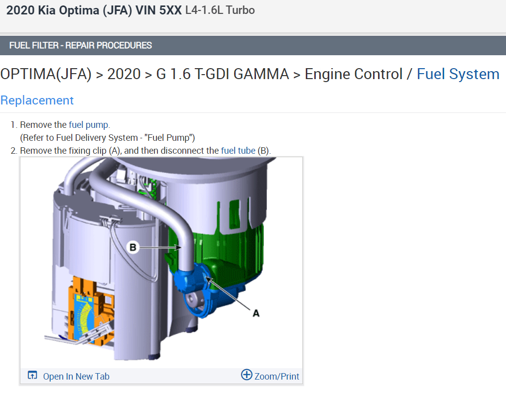

Where is the fuel filter located?
2020 KIA OPTIMA
39,000 MILES • 1.6L • 4 CYL • TURBO • 2WD • AUTOMATIC
THATMETAL
Where is the fuel filter?
Sep 30, 2024 at 9:05 PM
  • 54,832 POSTS

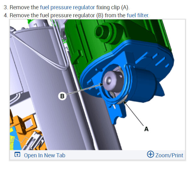

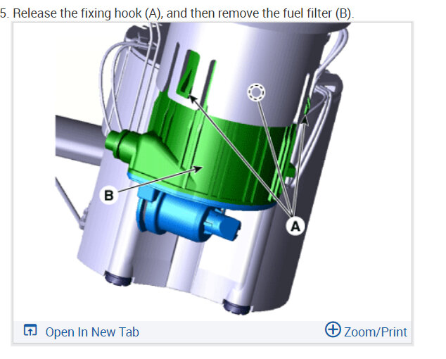

The fuel filter is attached to the fuel pump inside the fuel tank, they relay don't use a fuel filter anymore it is more like fuel strainer and is meant to last a lifetime of the car. Check out the images (below). Let us know if you need anything else.
