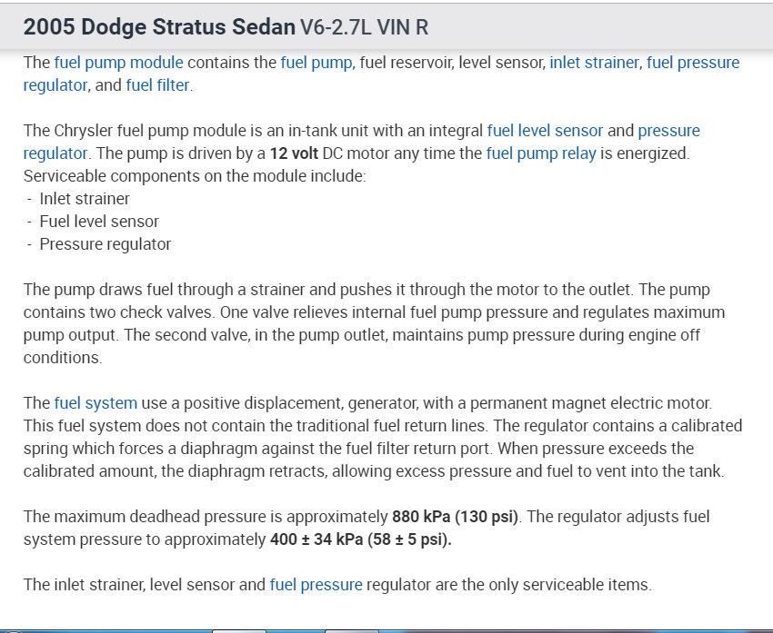

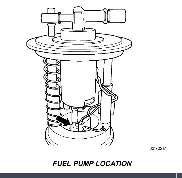

Where is the fuel filter and when should it be replaced?
May 2, 2019 at 6:04 AM
SCGRANTURISMO
  • 4,897 POSTS
The fuel filter on your vehicle is located on the fuel pump hanger in the fuel tank. There is no regular service interval for it, it only needs to be replaced when it has failed. I have included a diagram and description for you in the diagrams down below. If you should have any other vehicle related questions, please, feel free to ask. We are here for them 24/7.
