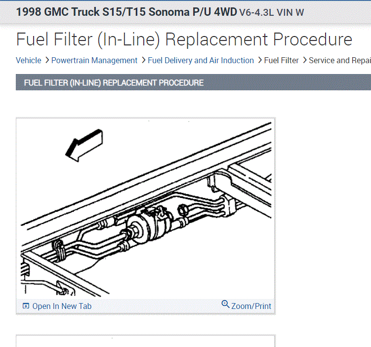

When I changed my fuel filter gas continued to pour out of the rear fuel filter line. It was not a trickle. Is this occurrence normal?
Aug 16, 2021 at 10:45 AM
  • 110,194 POSTS

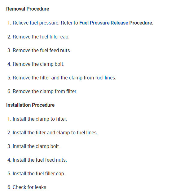

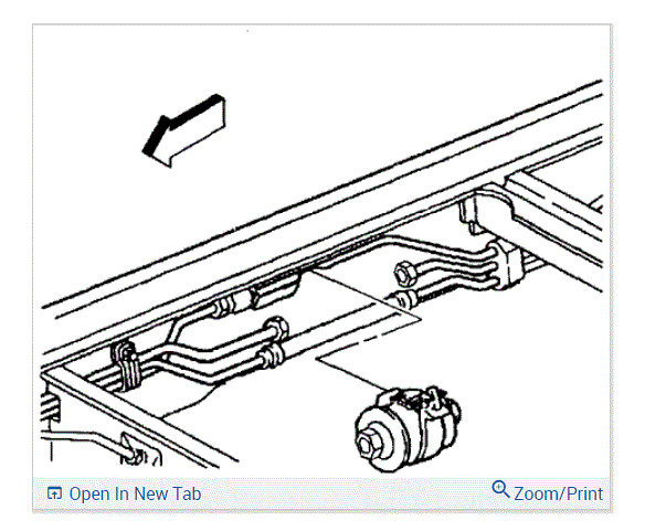

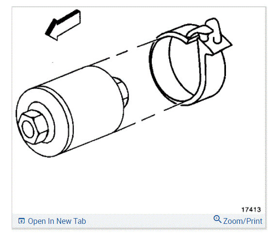

The system was under pressure. It isn't uncommon for this to happen because it starts a siphon and the fuel will continue draining.
I attached the directions below for you and a link showing in general how it's done. Look through them to make sure everything was done correctly. As long as there are no leaks now, you should be okay.
https://www.2carpros.com/articles/how-to-change-a-fuel-filter
Let me know if there is something I can do to help.
