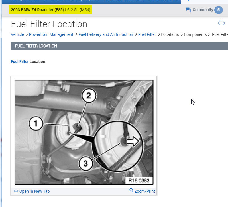

Fuel filter for my 4USBT33483LS426759.
Jan 12, 2020 at 9:17 AM
  • CAR REPAIR CONTRIBUTOR

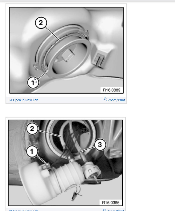

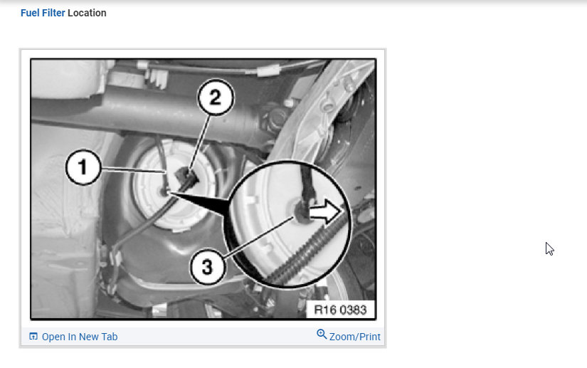

The fuel filter for this vehicle is in the fuel tank and part of the fuel pump assembly. See the attachments. The only time it requires changing is when the fuel pump is removed or there is another issue that has you take it out.
Let me know if you have other questions about this. Thanks
