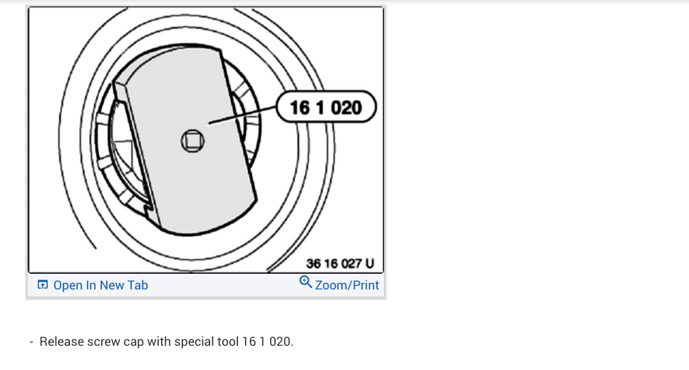

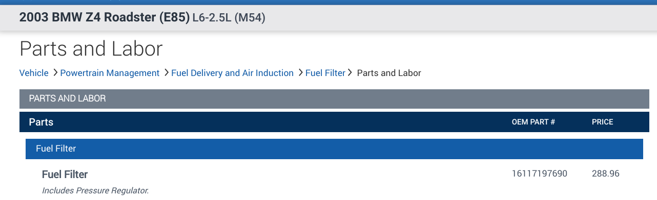

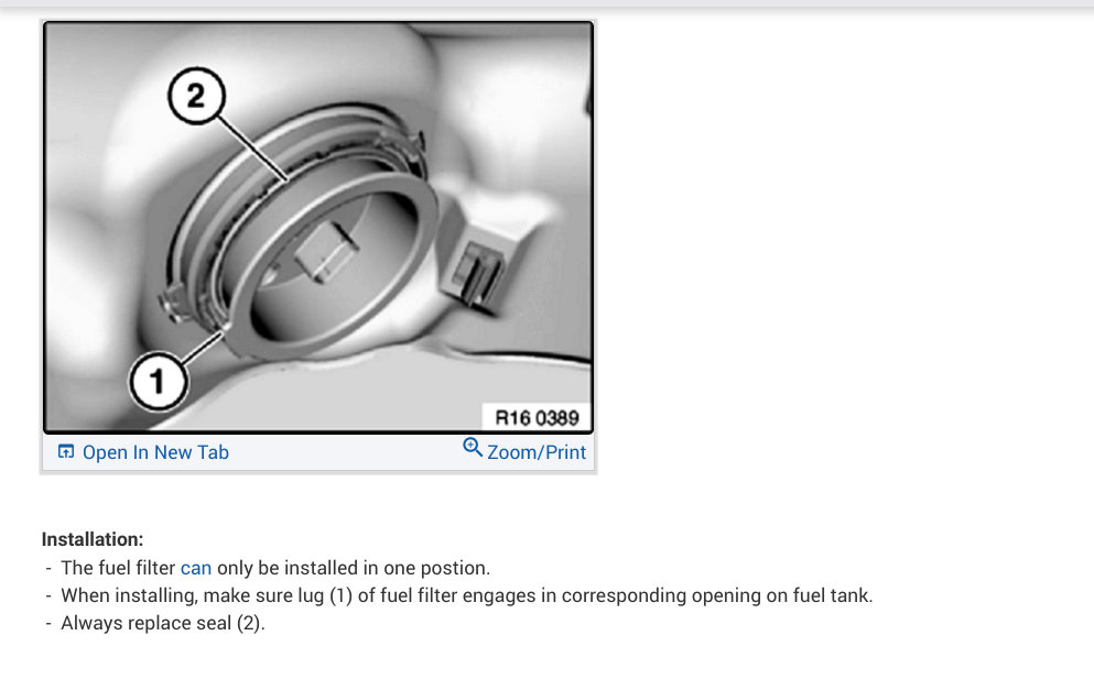

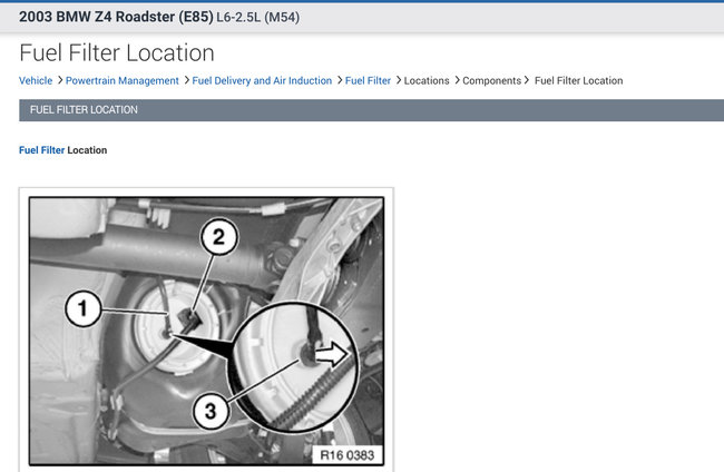

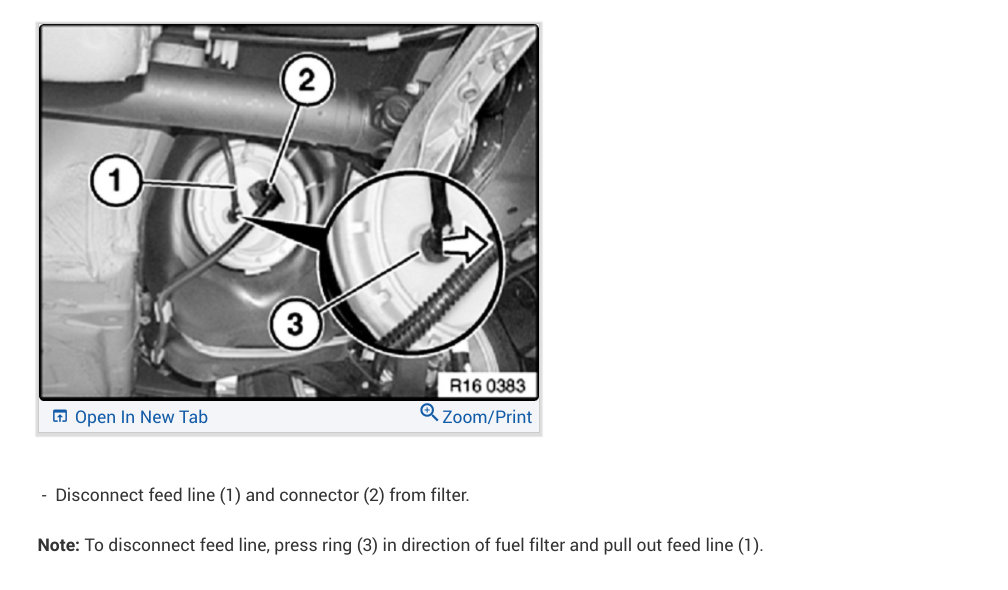

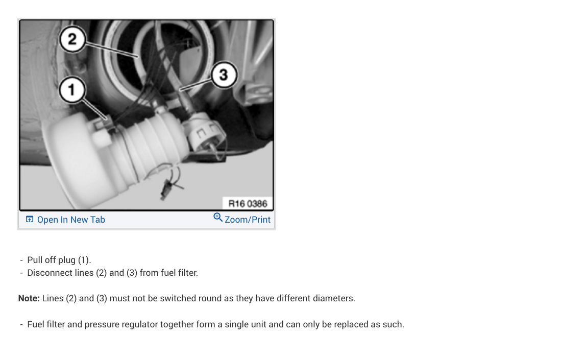

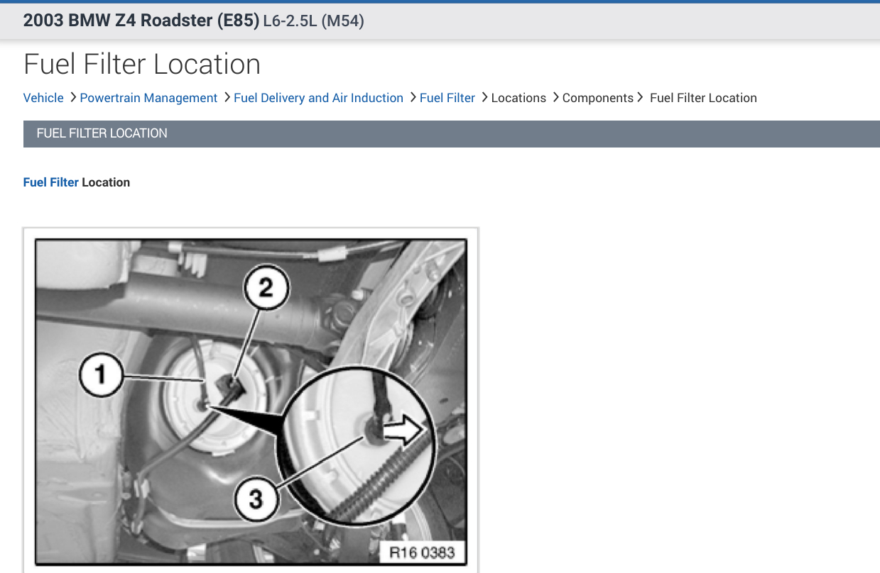

Cannot determine whether the filter is an under body style or an in-tank style. can you tell from the VIN? 4usbt33483l542659
Jan 1, 2020 at 7:09 AM
SCGRANTURISMO
  • 4,897 POSTS

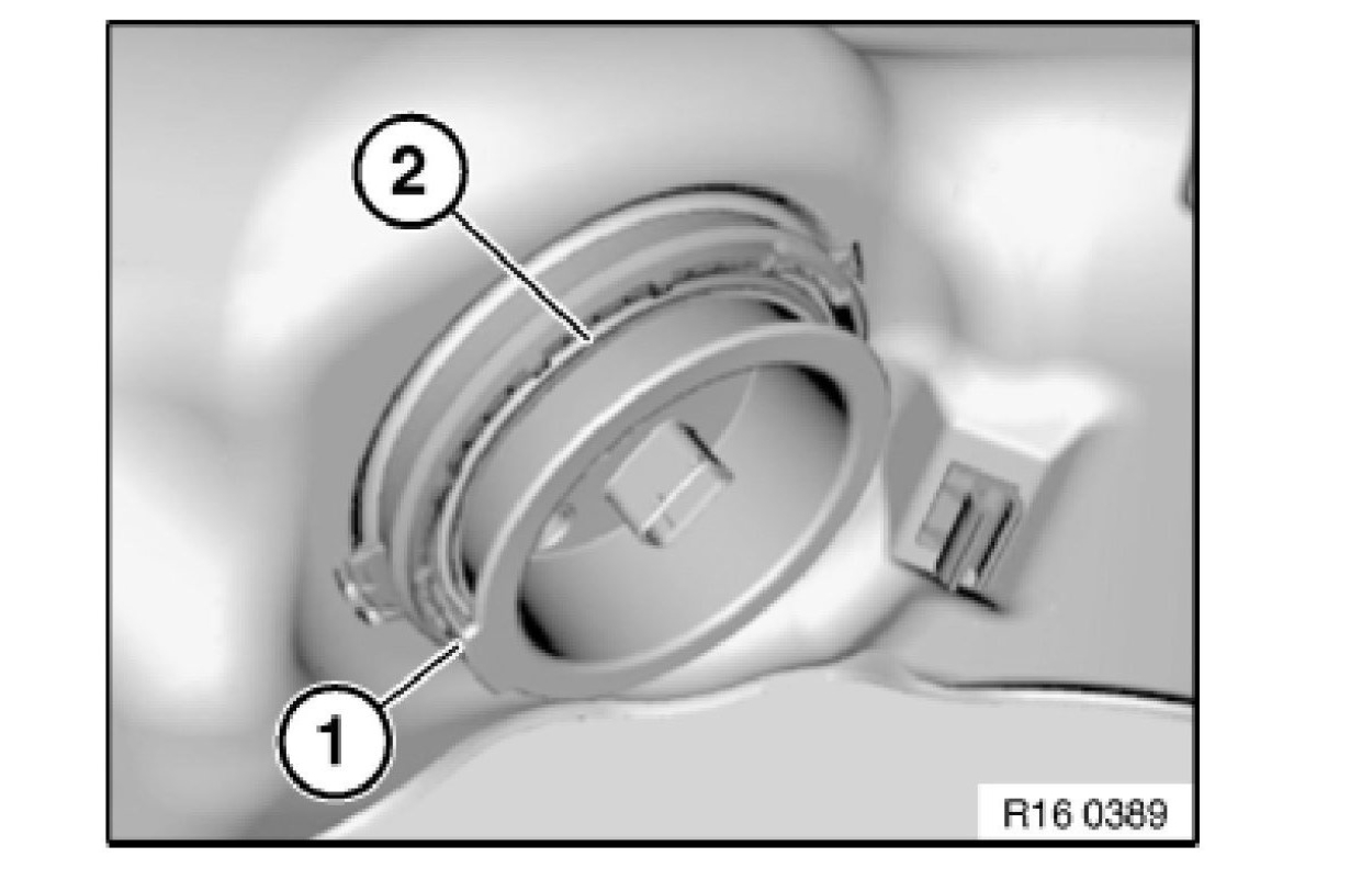

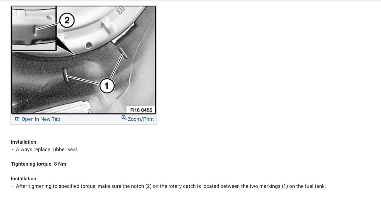

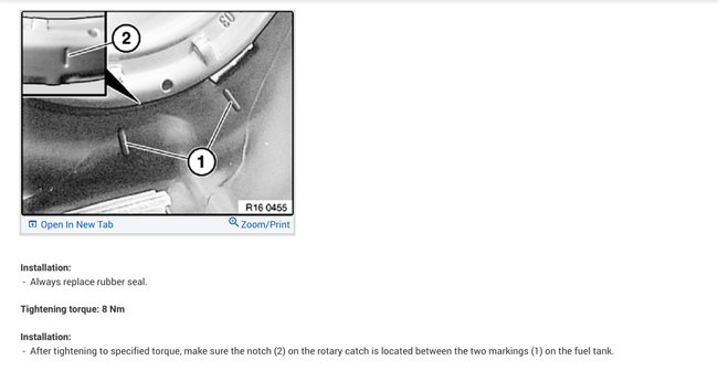

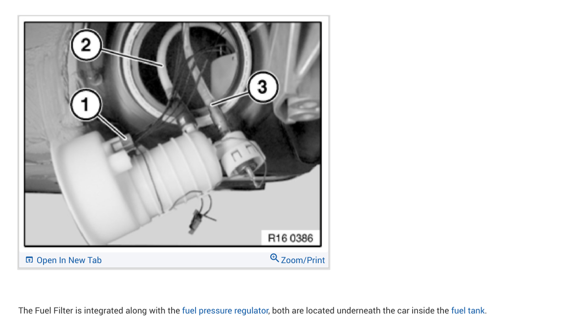

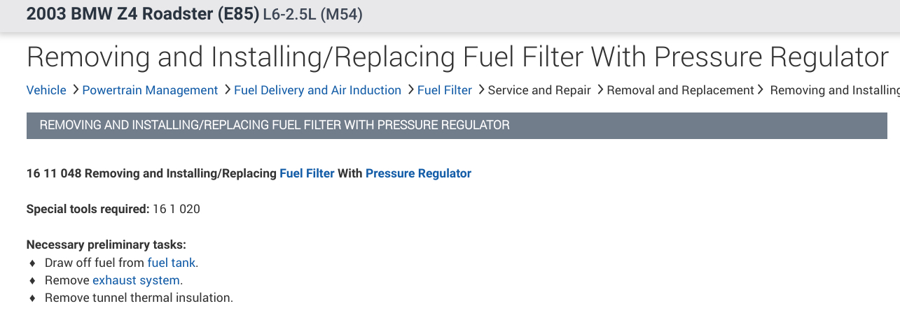

The fuel filter is located in the fuel tank of your vehicle. In the diagrams down I have included the location, Original Equipment Manufacturer[OEM] part number for your reference and the instructions for the removal and installation of the fuel filter for your vehicle. Please go through these guides and get back to us with how everything turns out.
