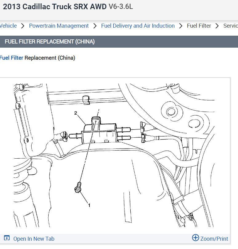

Where is the fuel filter located for the car listed above?
Aug 5, 2024 at 9:10 AM
  • 55,594 POSTS

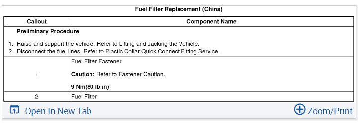

The fuel filter is a strainer inside the fuel tank and typically does not need to be replaced on American cars. Here is the location for vehicles in China which looks like it is under the car in the rear by the fuel tank and driveshaft. Check out the images (below). Let us know if you need anything else.
