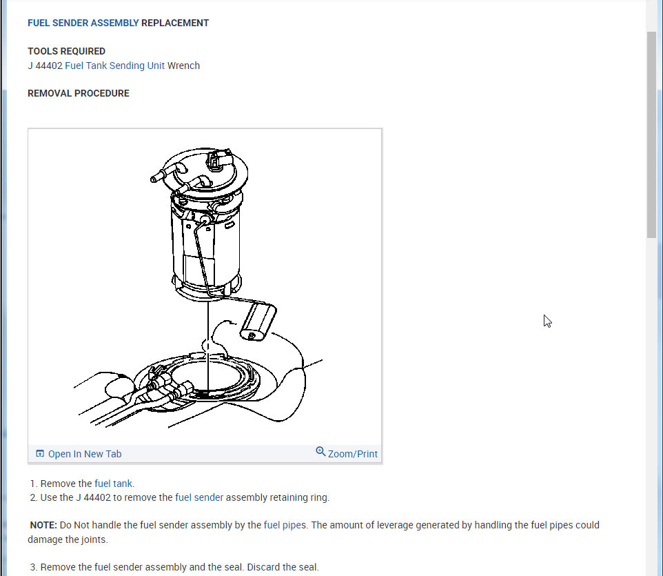

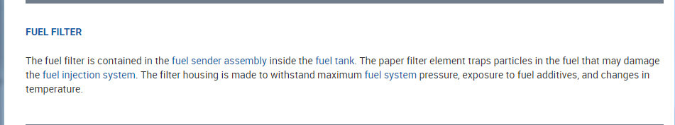

Since the fuel filter is in the tank or above the tank, does this model have a trap door to get to it or will i need to drop the fuel tank? (the mileage should be 160,000)
May 11, 2021 at 1:33 AM

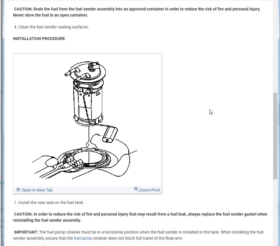

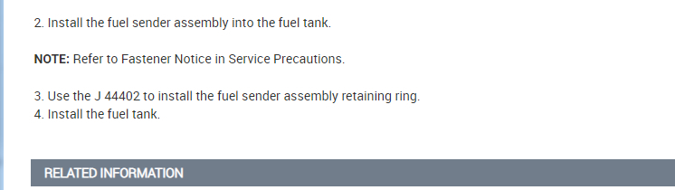

Unfortunately it does not. Step one in the process says to remove the tank.
Here is a guide that will help with this:
https://www.2carpros.com/articles/how-to-replace-an-electric-fuel-pump
Below is the process from the manual on how to do this as well.
Please let us know if you need more info. Thanks
