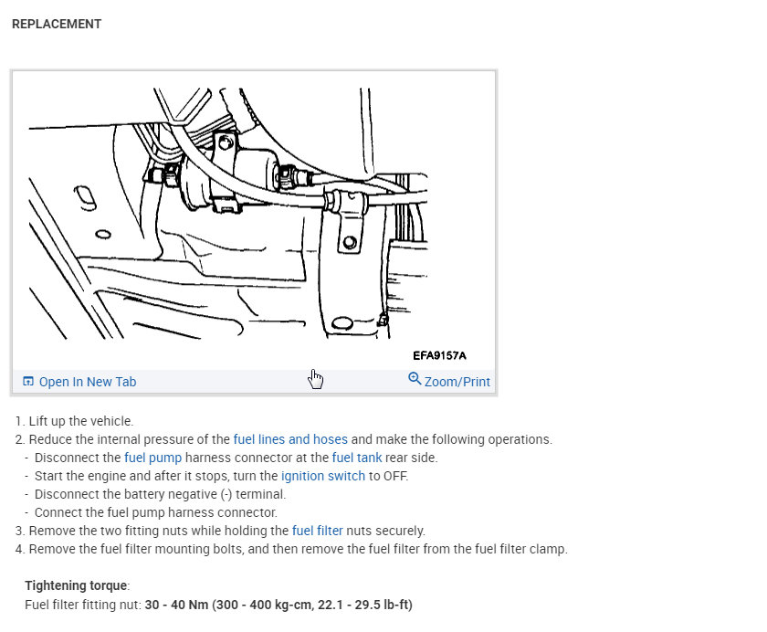

How to change fuel filter?
Oct 22, 2019 at 11:56 AM
I attached the process on how to replace the filter. I also attached a video that shows how to get this off. It appears you have filter nuts which are a little different then other fuel lines. Clearly the vehicle is different but the process is the same.
Let me know if you have questions. Thanks.
