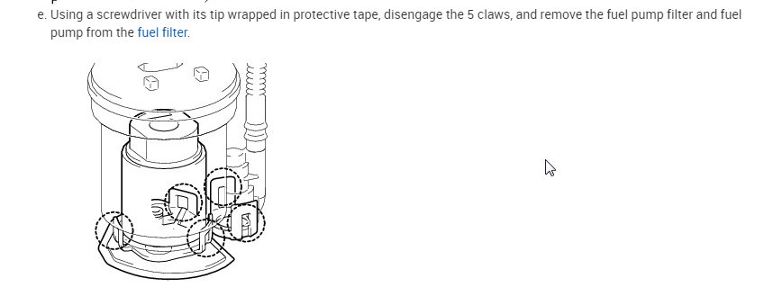

Where is the location of the fuel filter in my car listed above?

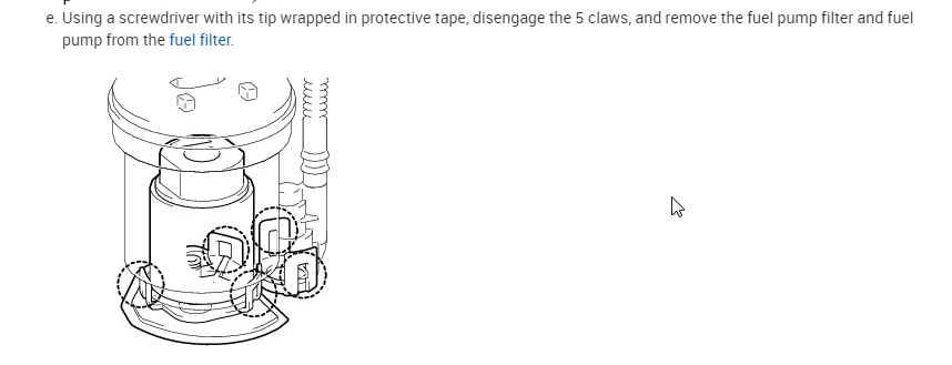

The fuel filter on these vehicles is part of the fuel pump in the tank. They are lifetime filters of the pump. Basically, you don't replace them unless there is an issue with the fuel (contamination) or the pump and then you replace the filter or the replace it with the assembly.
A lot of times people add an inline filter on their own so I would just follow the lines from the rear of the tank up to the rail and see if there is one added. However, it does not have one from the factory.
Hope this helps. Thanks
