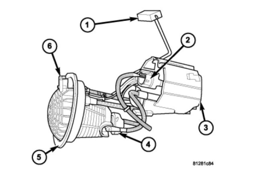

want to replace where is it located?

Good afternoon,
The filters are in the fuel tank itself and are part of the pump assembly.
Two fuel filters are used. One is located at the bottom of the fuel pump module. The other is located inside the module.
Image (Click to enlarge)
