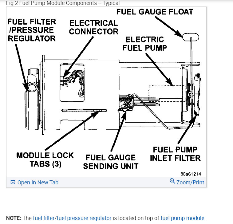

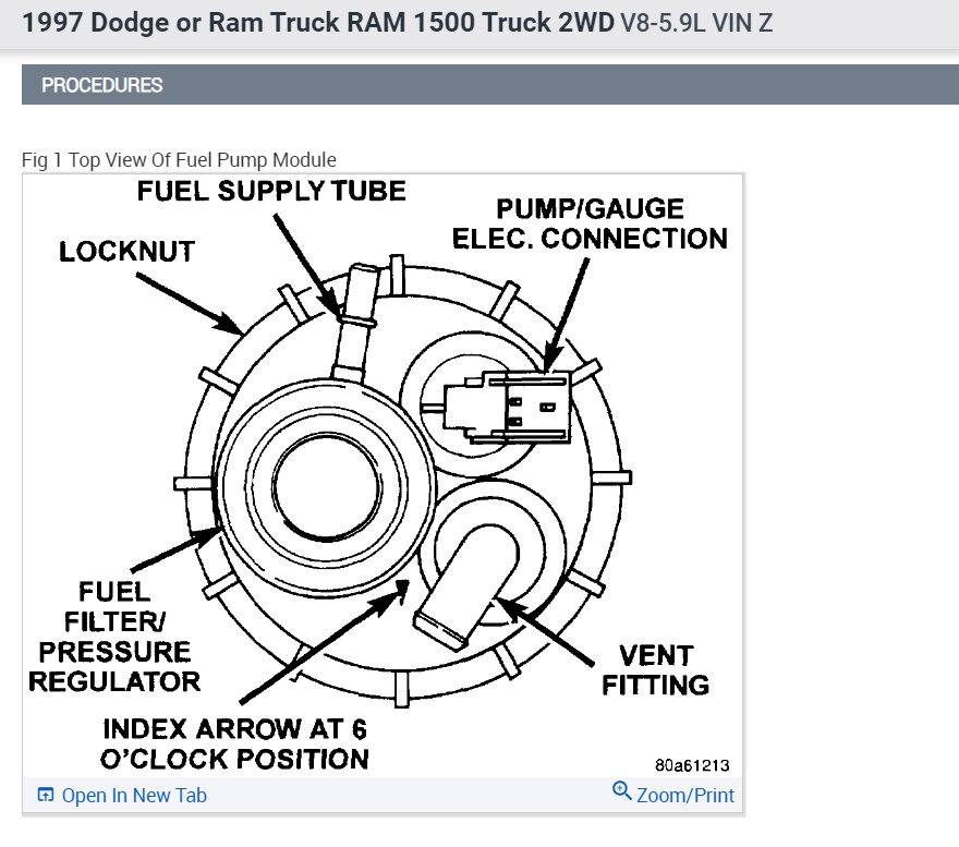

Where is the fuel filter and fuel pressure regulator located?
1997 DODGE RAM
200,000 MILES • 5.7L • V8 • 2WD • AUTOMATIC
ACSPARKS
Trying to find a fuel filter and fuel pressure regulator, where is it?
Jul 31, 2023 at 11:48 AM
  • 55,456 POSTS

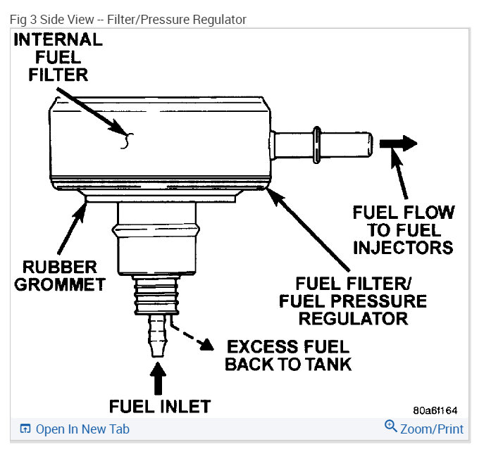

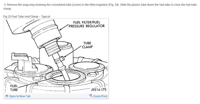

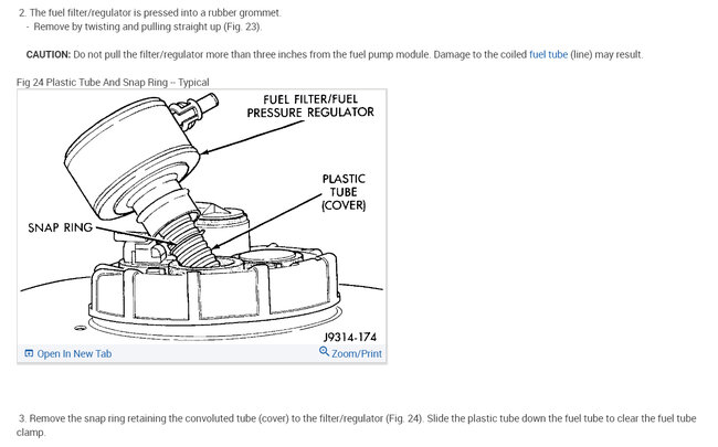

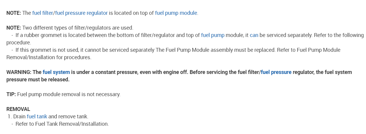

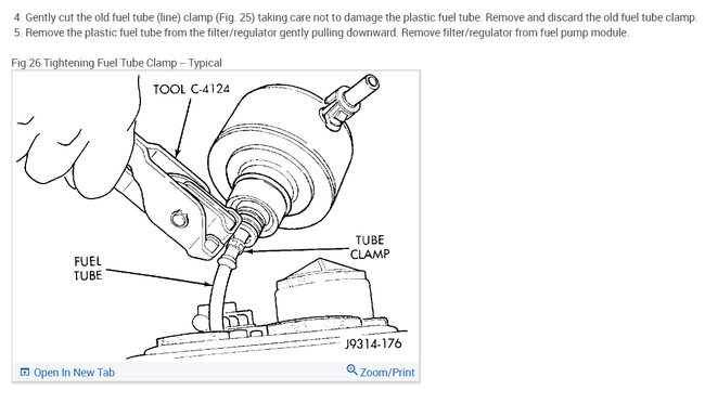

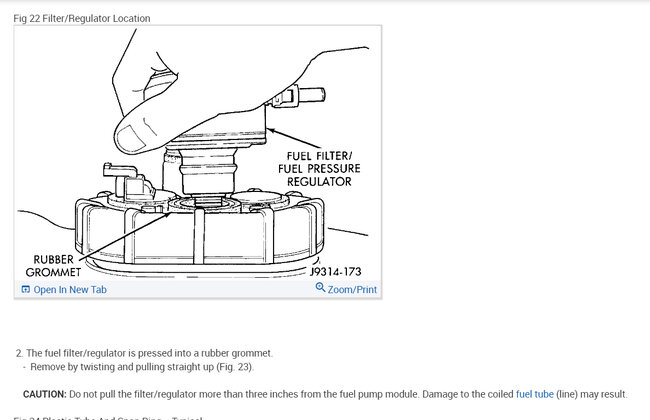

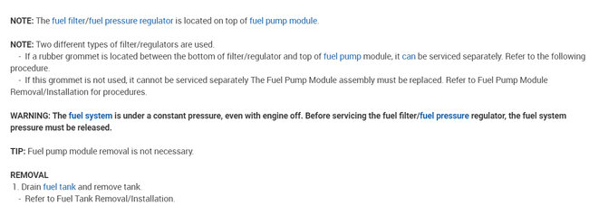

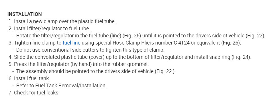

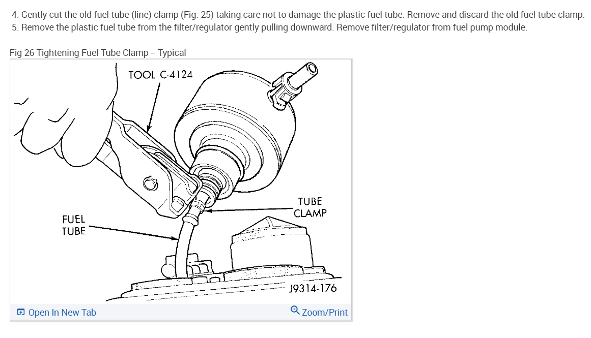

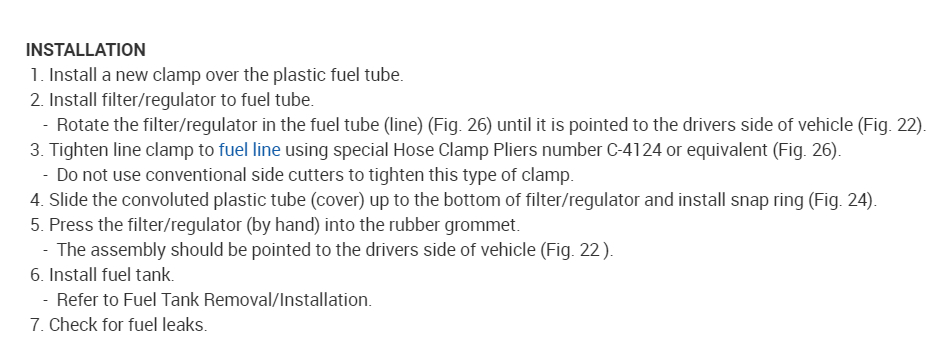

The fuel filter and pressure regulator is on top of and inside the fuel tank, please check the images below to see what I am talking about. Please let us know if you need anything else to get the problem fixed.
