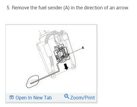

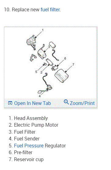

Where is the fuel filter located?
200,000 MILES • 1.6L • 4 CYL • 2WD • AUTOMATIC
FARR2007
  • 244 POSTS
And how do I replace it?
Mar 18, 2022 at 11:03 AM
  • 110,248 POSTS

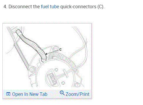

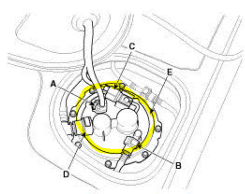

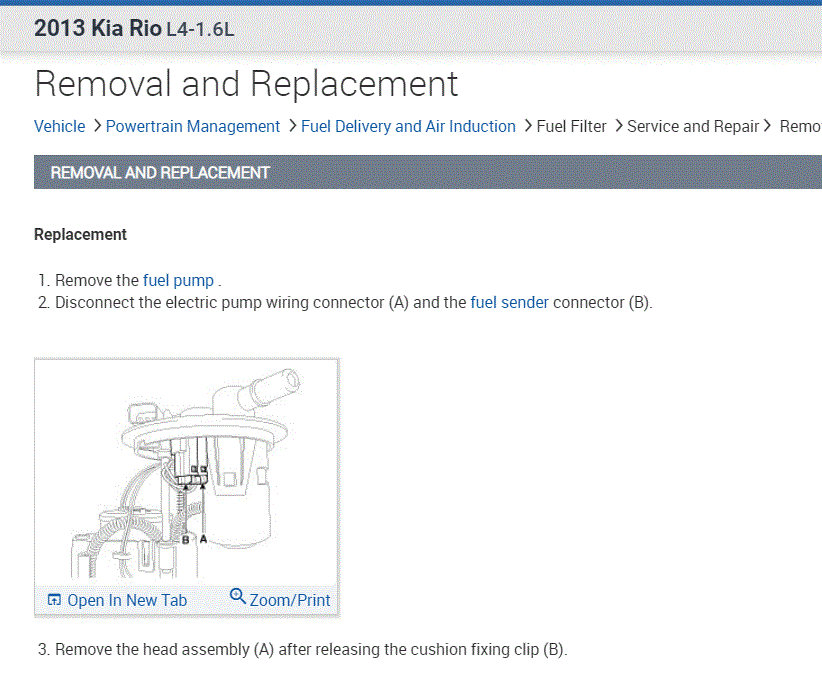

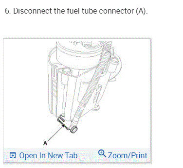

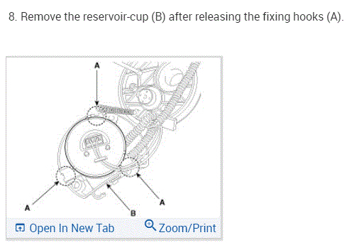

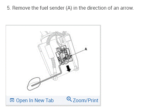

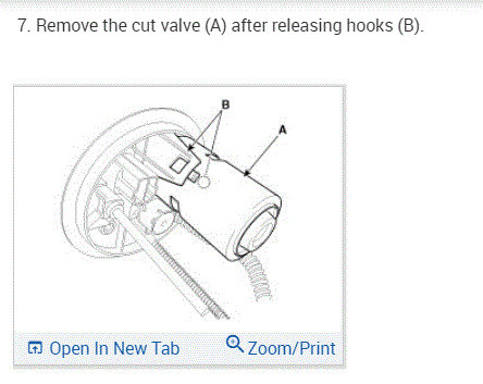

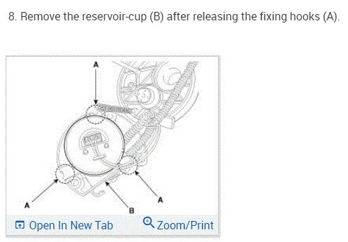

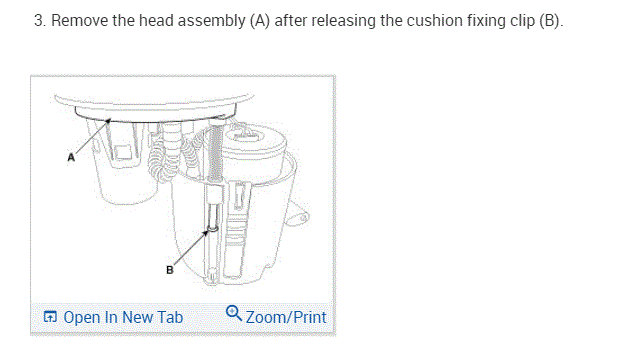

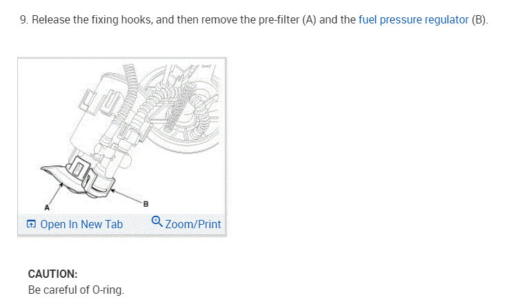

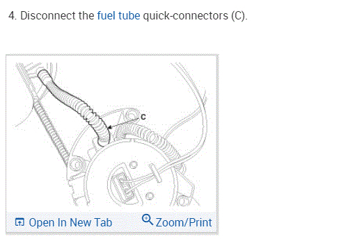

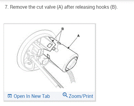

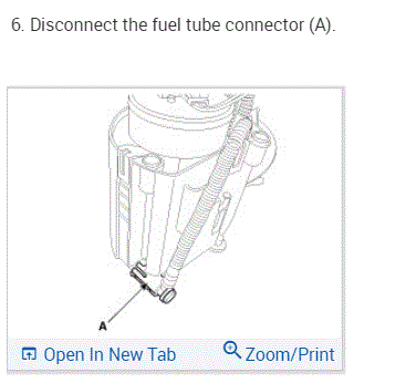

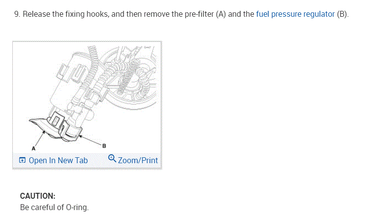

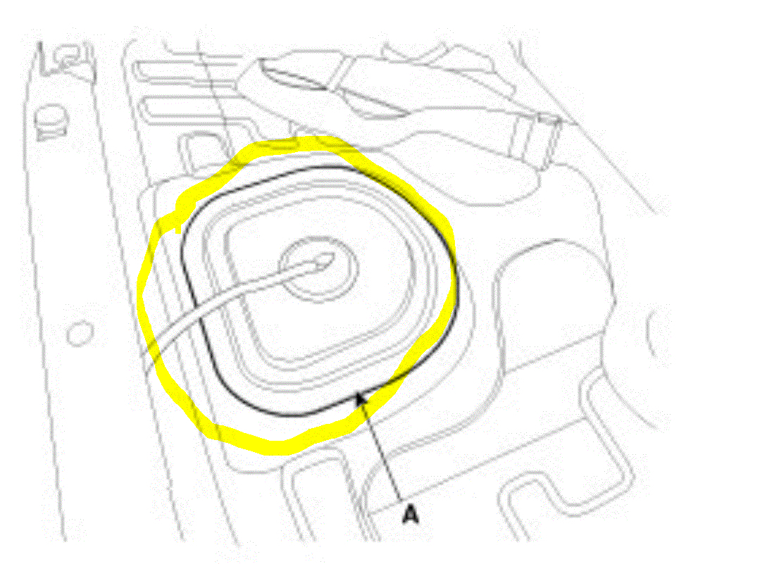

The fuel filter on this vehicle is mounted on the fuel pump in the fuel tank. If you look at the pics below, I included the directions for the removal and replacement of the pump and filter.
To access the fuel pump, you first need to remove the rear seat. Under the seat is a service port. See pics 1 and 2. Remove the cover to access the pump.
Remember, the fuel is under pressure, so use caution when disconnecting the fuel lines. The remaining pics are the filter replacement procedures.

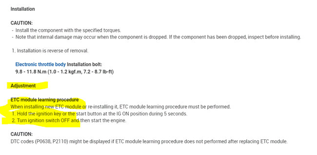

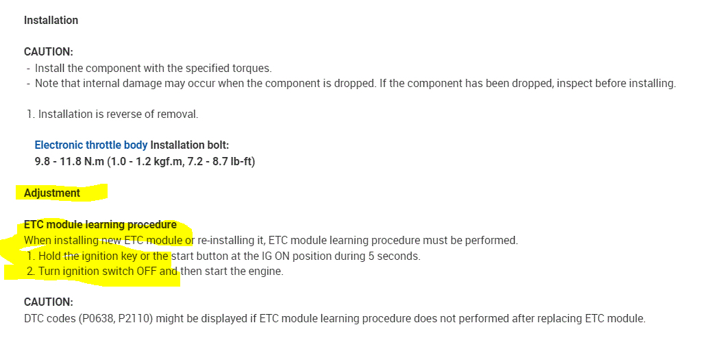

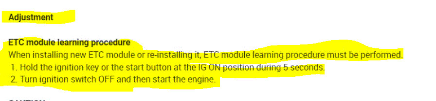

Also does the throttle body need to be reprogrammed after replacement?
Mar 19, 2022 at 7:37 AM
  • 110,248 POSTS
Do you mean the replacement of the throttle body or the fuel filter? If you are referring to the filter, no reprogramming is needed.
If you are replacing the throttle body, see the directions below in the attachment.
See pic below.

I put a used throttle body on the vehicle. are you sure it needs reprogrammed and how do I do it?
Mar 19, 2022 at 12:26 PM
  • 110,248 POSTS
It may not. However, the directions are really simple. If you find there are any drivability issues, try the relearn process listed below.
All it requires is the following.
Turn the key to the run position (engine off) for 5 seconds. Turn the key off and then start the engine. See pic below.

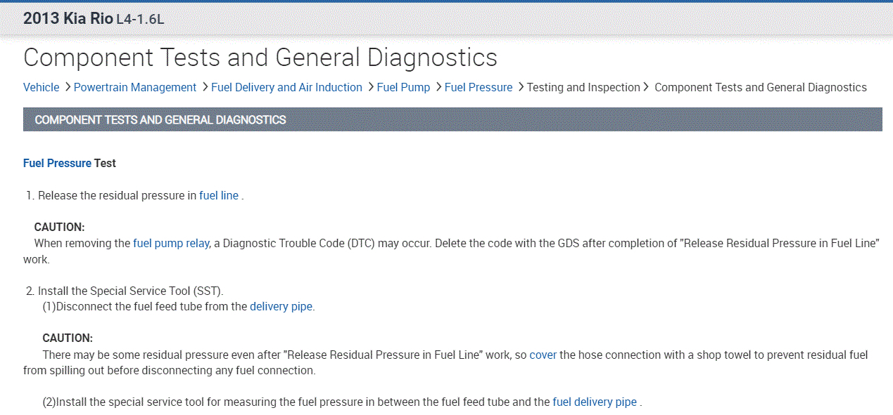

Right now, I have no codes, and I replaced the fuel pump with a used one and I replaced the throttle body with a used one. Still no response. it starts idles badly and shuts off. I cannot figure out why. I’m stumped. Could it be the high pressure pump under hood?
Mar 20, 2022 at 8:42 AM
  • 110,248 POSTS
Yes, that can be an issue. Have you checked fuel pressure? There could be an issue with the pressure regulator. However, I would think that would set a code for either a lean or rich fuel mixture.
Tell me this. When it's running, do you see any dark smoke from the exhaust or odd odors?
Also, can you record it running and upload it for me to hear? That may help me. Also, you indicated "no response" above. Do you mean there was no change with the different parts or is there no response when you press the throttle?
Mar 20, 2022 at 12:36 PM
FARR2007
  • 244 POSTS

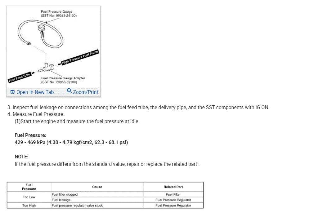

The symptoms are the same with replacement parts. It’s trying to run but won’t respond to the pedal and I put it to the floor, and it shuts off. It revs up a little if I push on the gas pedal but shuts off. And what code would be for regulator it may have? I'm stumped.
Mar 20, 2022 at 12:57 PM
  • 110,248 POSTS

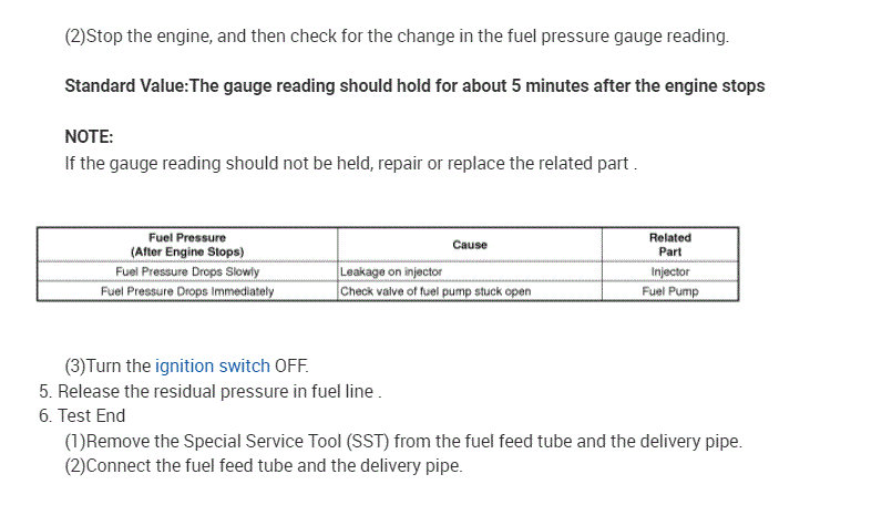

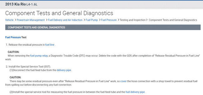

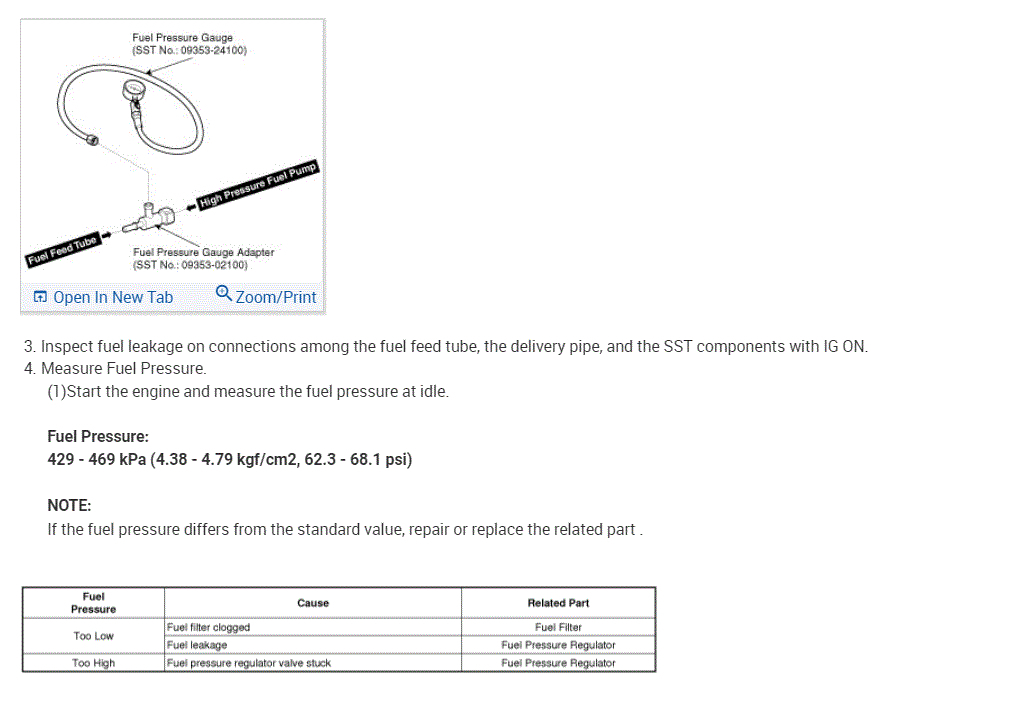

At this point, you really need to check fuel pressure. That will tell us if there is an issue with pressure regardless of the cause.
Here is a link that explains in general how it's done:
If you look below, I have attached the directions specific to this vehicle. The manufacturer's fuel pressure specifications are included in the directions.
Let me know what you find. The idea that it shuts off the harder you press the throttle leads me to think exactly like you. It sounds like a lack of fuel.
Take care and let me know the results.

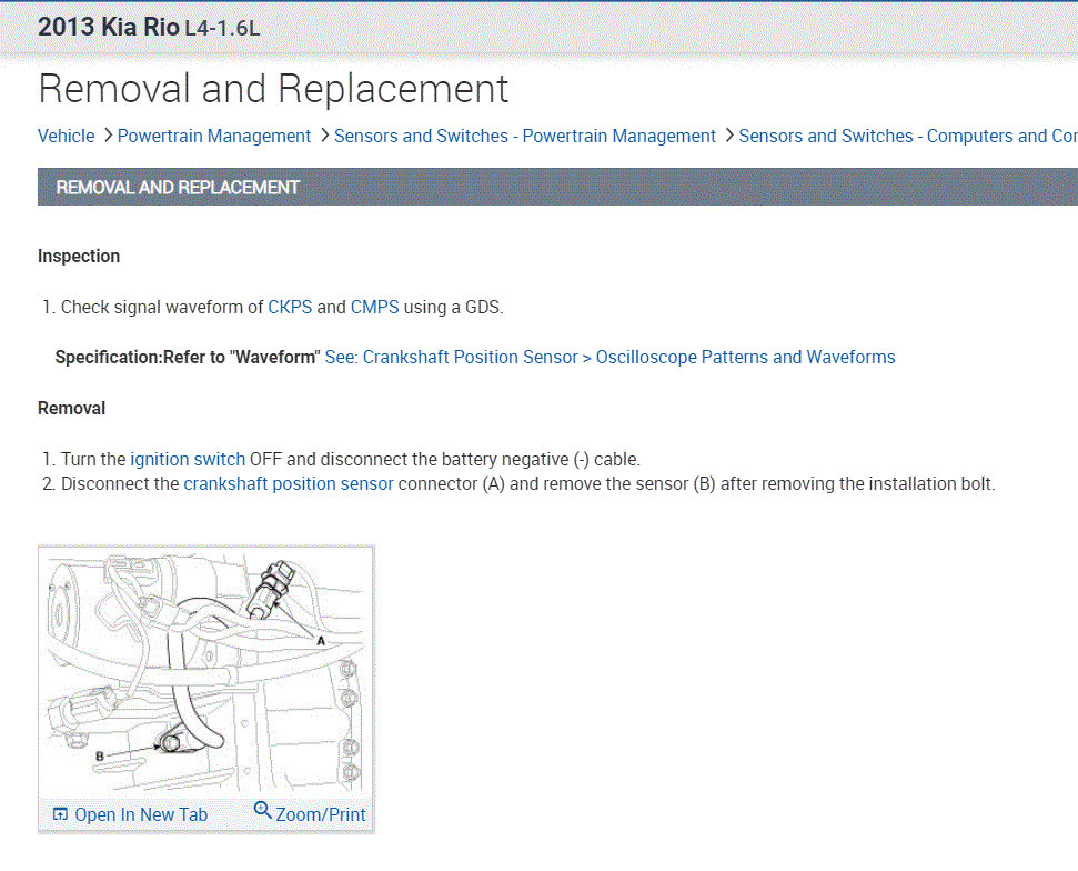

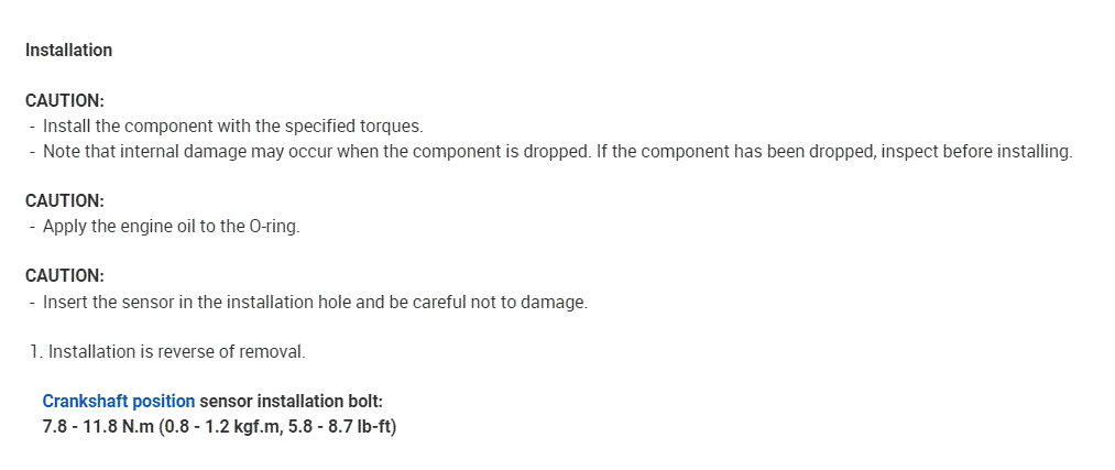

I am now led to believe it is the crank sensor.
Mar 21, 2022 at 2:14 AM
  • 110,248 POSTS

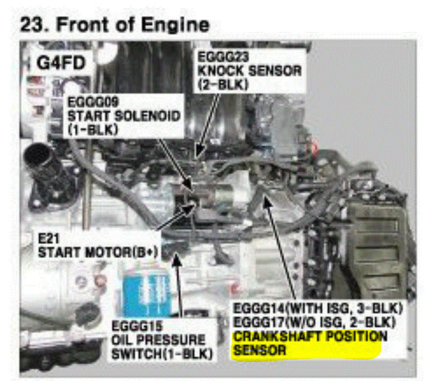

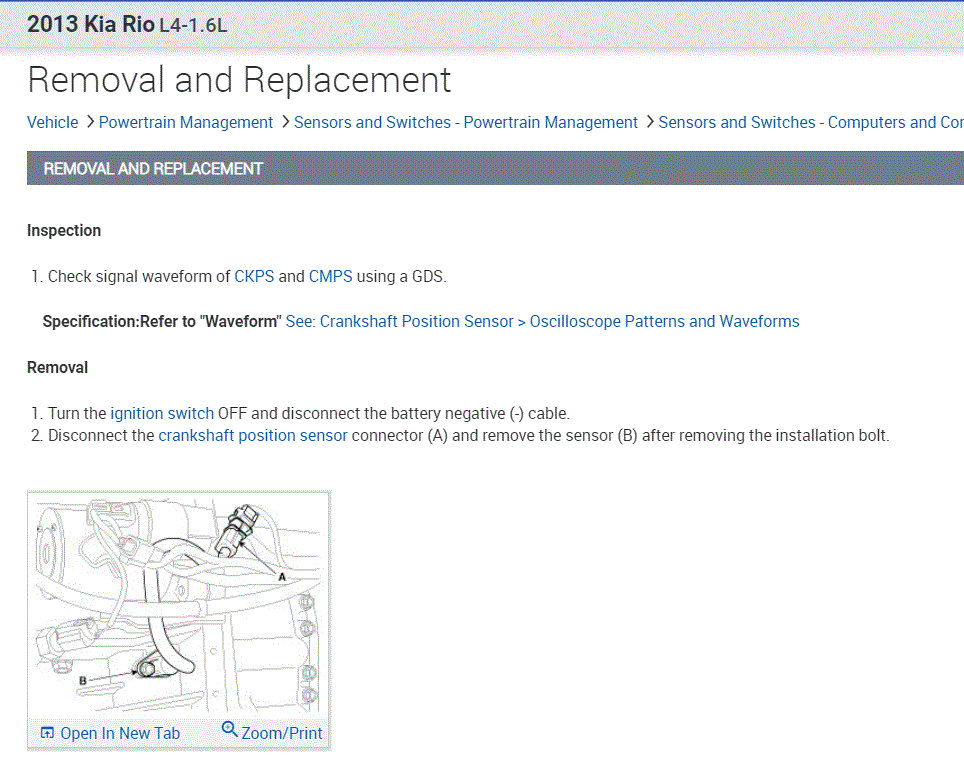

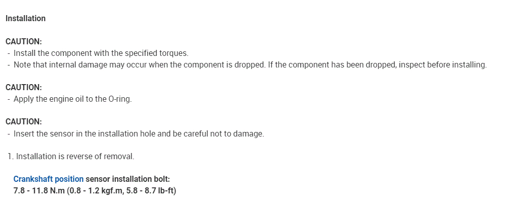

If it is the crankshaft position sensor, you will not have spark to the spark plugs. Is that happening? Also, if you have a live data scanner, it will not produce an RPM signal when cranking the engine. If there is a tachometer in the vehicle, pay attention to see if it moves a bit when cranking. If it doesn't, the sensor is my first suspect.
Or here is a link that explains how to check for spark:
If there is no spark, here is a link that explains in general how to replace the sensor:
If you look below, pic 1 shows its location. The remaining pics are the directions specific to your vehicle for replacement.
Let me know what you find. Also, let me know if you have questions or if I can help in any way.
