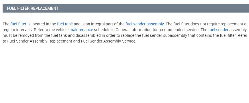

Where exactly is the fuel filter located?
Nov 27, 2019 at 9:31 PM
Good morning,
There is no external fuel filter for servicing. The filter is part of the fuel pump assembly in the fuel tank.
