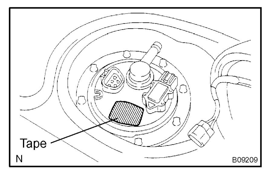

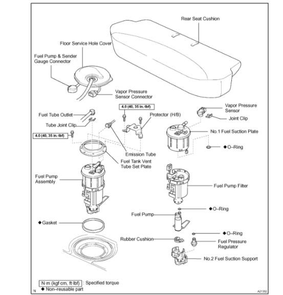

Good day gentlemen, I'm a little unsure about the location of the fuel filter for the car listed above. I'm about to change the fuel pump motor and i'm assuming the fuel filter is together with the fuel pump assembly yea?
if so may you direct me to the fuel filter and replacement procedures if possible. i greatly appreciate your help in advance.
Jan 5, 2021 at 1:04 AM
Good morning,
The filter is part of the fuel pump itself and is not sold separately.

1. REMOVE REAR SEAT CUSHION
2. REMOVE FLOOR SERVICE HOLE COVER
a. Take out the floor carpet.
b. Remove the service hole cover.

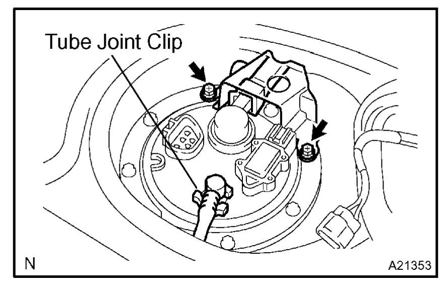

3. DISCONNECT FUEL PUMP & SENDER GAUGE CONNECTOR
4. REMOVE PROTECTOR (H/B)
a. Remove the 2 bolts and protector.
5. DISCONNECT FUEL TUBE
a. Wash away the mud, dust and foreign matter on the fuel suction plate with water.
b. Pull off the tube joint clip from the fuel suction plate.
c. Disconnect the fuel tube from the fuel pump assembly.
d. Affix tape to the port to prevent dust contamination.
e. Prevent the disconnected fuel tube from damage or foreign matter contamination by covering it with a vinyl bag.

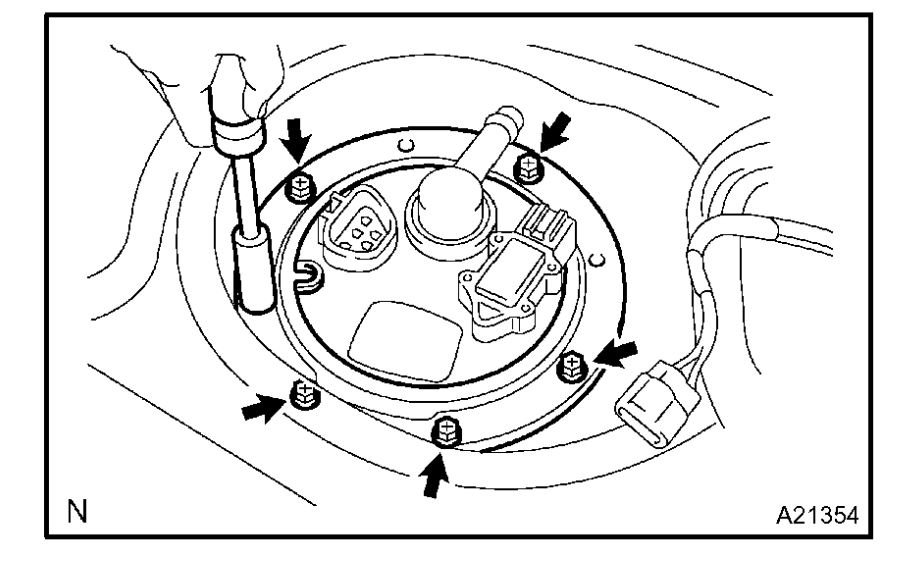

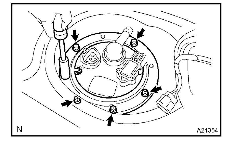

6. REMOVE FUEL PUMP ASSEMBLY FROM FUEL TANK
a. Remove the 6 bolts and fuel tank vent tube set plate (H/B).
b. Remove the 8 bolts and fuel tank vent tube set plate (S/D).
c. Pull out the fuel pump assembly.
NOTE:
Do not damage the fuel pump filter.
Be careful not to bend the arm of the sensor gauge.
d. Remove the gasket from the pump assembly.
