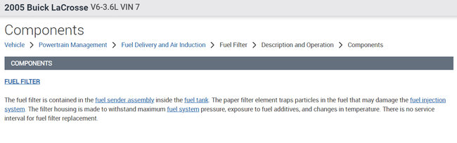

Where is it located exactly the fuel filter?

Hello and thanks for your question,
The fuel filter is made into the fuel pump assembly in the gas tank. At least this is what I am finding on my end. You will need to drop the gas tank and remove the fuel pump assembly to remove the paper filter attached. At that point I would just replace the pump with a new assembly. Let us know if you want to move forward on replacement instructions, it can be a bit involved.
