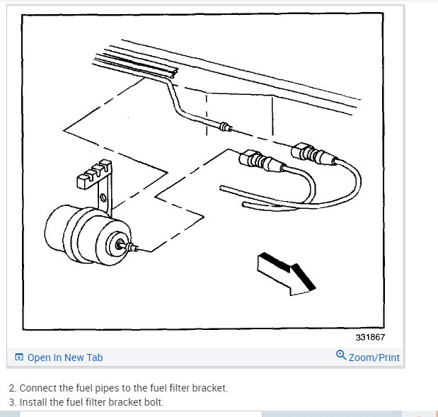

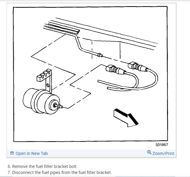

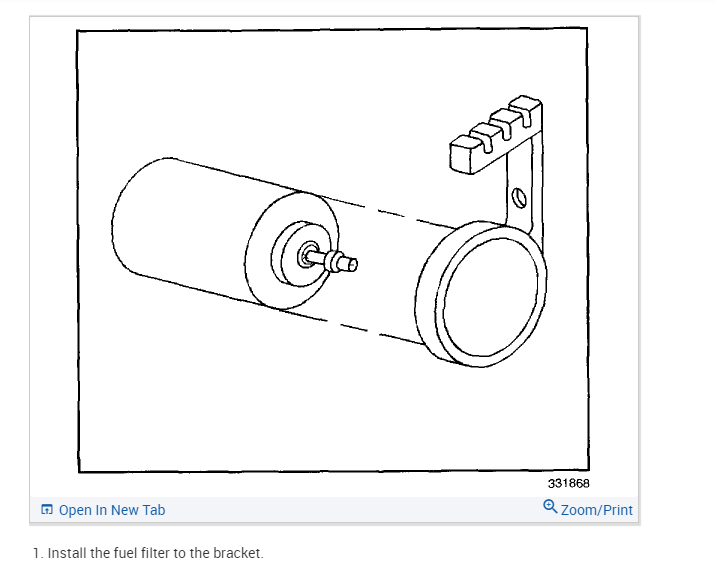

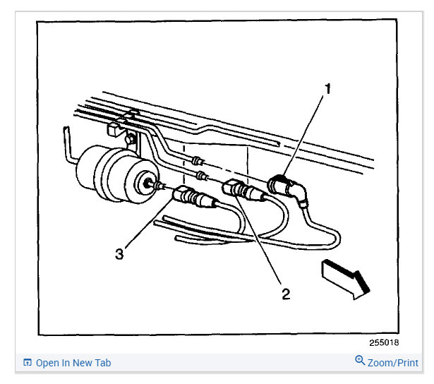

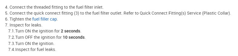

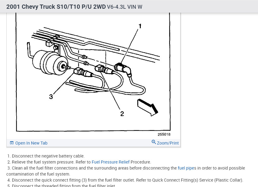

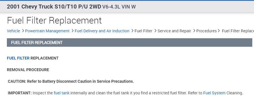

It seems like my truck isn't getting fuel, it will turn over but not start. Upon manually putting additive in carburetor, it will verify start.
Jul 14, 2022 at 8:39 AM
  • 110,248 POSTS

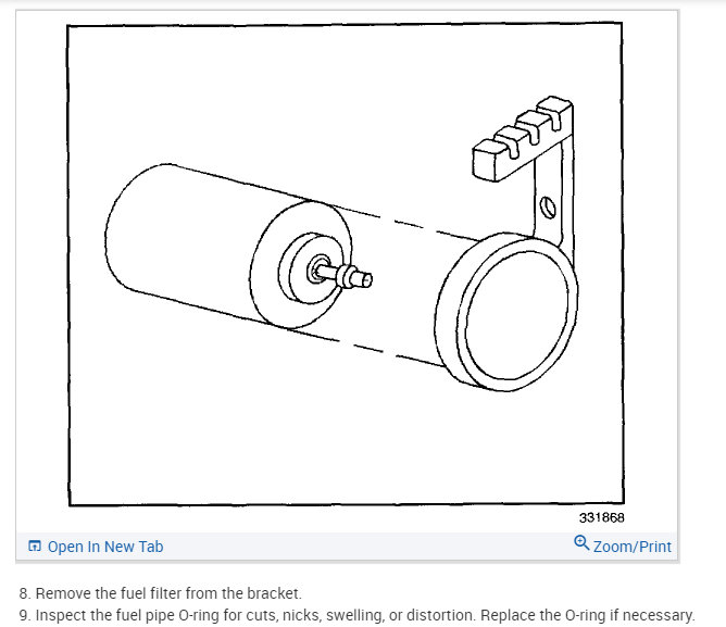

When you get it to start, will it continue to run, or does it stall after a few seconds? If it continues running, there is a good chance it isn't the fuel filter, so let me know.
As far as the filter, it is located on the frame rail, driver's side. I attached the directions for removal and replacement specific to your vehicle below.
joe
