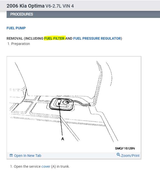

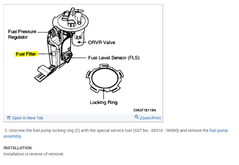

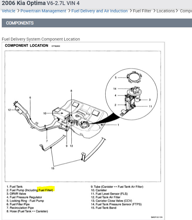

I am replacing the fuel filter on the car listed above LX model. I need to know where the fuel filter is located.
Monday, February 28th, 2022 AT 12:55 PM
4 Replies
SQM
MECHANIC
6,383 POSTS

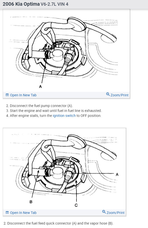

This vehicle does not have an inline fuel filter.
The filter is mounted on the fuel pump, located in the fuel tank.
It can be accessed through the service port that is located in the trunk. You will see the access port after removing the carpet.
I have attached diagrams below for your reference.

Okay. Can I replace the fuel filter or do I need to replace the whole pump?
Monday, February 28th, 2022 AT 1:11 PM
RACER8X
MEMBER
4 POSTS
My car has a stutter when I hit an incline and when I try to give it gas it won't go.
Monday, February 28th, 2022 AT 1:15 PM
SQM
MECHANIC
6,383 POSTS
Yes, you can just replace the filter that is mounted on the pump.
