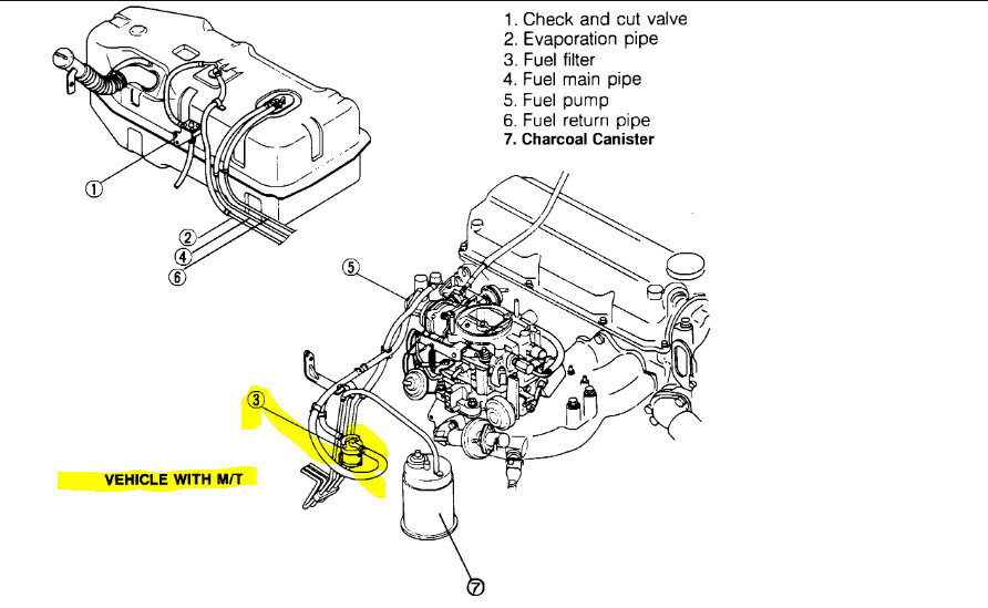

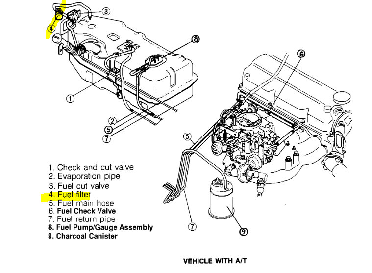

Where is the Fuel filter located?
1989 MAZDA B2200
98,000 MILES
LSIEDOW17
The truck listed above has a carburetor, where can I find the fuel filter?
Jul 9, 2023 at 6:07 AM
  • 110,240 POSTS
Based on if it has an automatic or manual transmission, it is located in different places. If you look at pic 1 below, it shows it near the fuel tank. That is where an automatic transmission fuel filter is located. In pic 2, it is under the hood on a manual transmission vehicle.
https://www.2carpros.com/articles/how-to-change-a-fuel-filter
Let me know if this helps.

Very helpful. Thanks much, especially for the diagrams.
