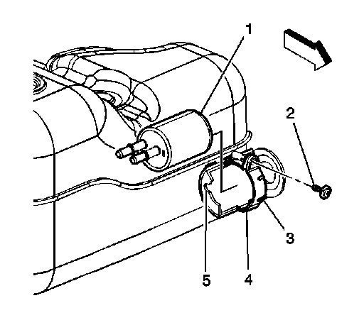

I am trying to find my fuel filter, so I can change it. Thanks.

It is on the tank. Here are the directions for replacement. The attached picture shows location.
______________________
FUEL FILTER REPLACEMENT
REMOVAL PROCEDURE
IMPORTANT: Inspect the fuel tank internally and clean the fuel tank if you find a restricted fuel filter.
1. Relieve the fuel system pressure. Refer to the Fuel Pressure Relief Procedure.
2. Raise the vehicle. Refer to Vehicle Lifting.
3. Clean all the fuel filter connections and the surrounding areas before disconnecting the fuel pipes in order to avoid possible contamination of the fuel system.
4. Disconnect the quick connect fittings from the fuel filter.
IMPORTANT: The quick connect retaining clips will remain with the fuel filter.
5. Cap the fuel pipes in order to prevent possible fuel system contamination.
6. Remove the fuel filter bracket screw (2).
7. Remove the fuel filter (1) from the bracket.
INSTALLATION PROCEDURE
1. Install the fuel filter (1) into the bracket. Ensure that the fuel filter inlet tube is engaged in the fuel tank bracket orientation slot (5).
IMPORTANT: New quick connect retaining clips will be supplied with OEM replacement fuel filters (1).
2. Install the fuel filter bracket screw (2). Ensure that the fuel tank bracket orientation key (4) is engaged in the strap (3) slot.
NOTE: Refer to Fastener Notice in Service Precautions.
Tighten the screw to 1.5 N.m (13 lb in).
3. Remove the caps from the fuel pipes.
4. Connect the quick connect fittings to the fuel filter.
5. Lower the vehicle.
6. Connect the negative battery cable.
7. Raise the vehicle. Refer to Vehicle Lifting.
8. Inspect for leaks.
1. Turn ON the ignition, with the engine OFF for 2 seconds.
2. Turn OFF the ignition for 10 seconds.
3. Turn ON the ignition, with the engine OFF.
4. Inspect for fuel leaks.
