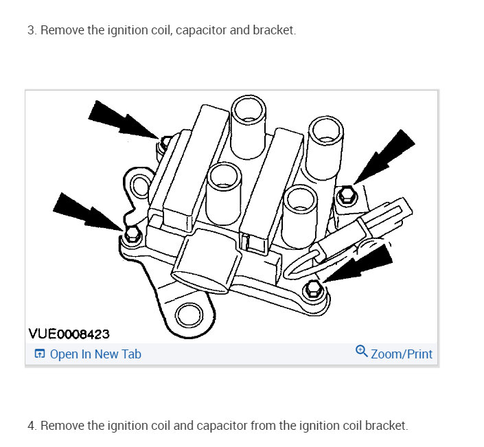

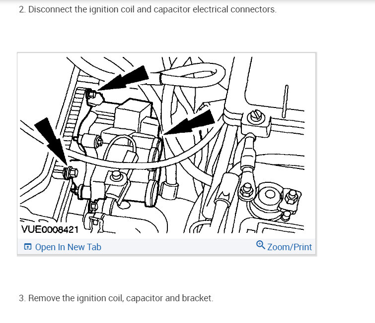

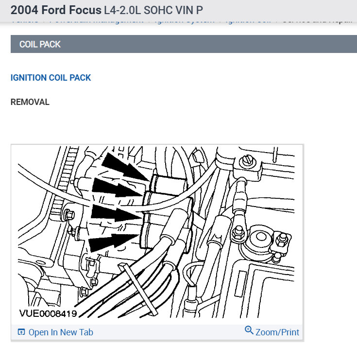

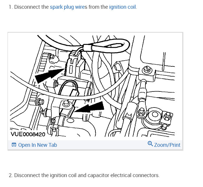

It sounds like you need to change out the spark plugs and ignition coils which are under the most load when the engine is cold. We should run the codes though here is a guide that will help.
Here is a guide to help walk you through the tune up process with instructions below to show you how on your car:
https://www.2carpros.com/articles/how-to-tune-up-a-car-engine
You should service the throttle body as well.
