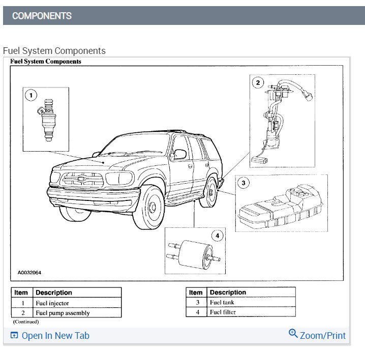

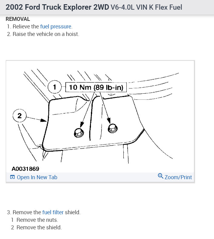

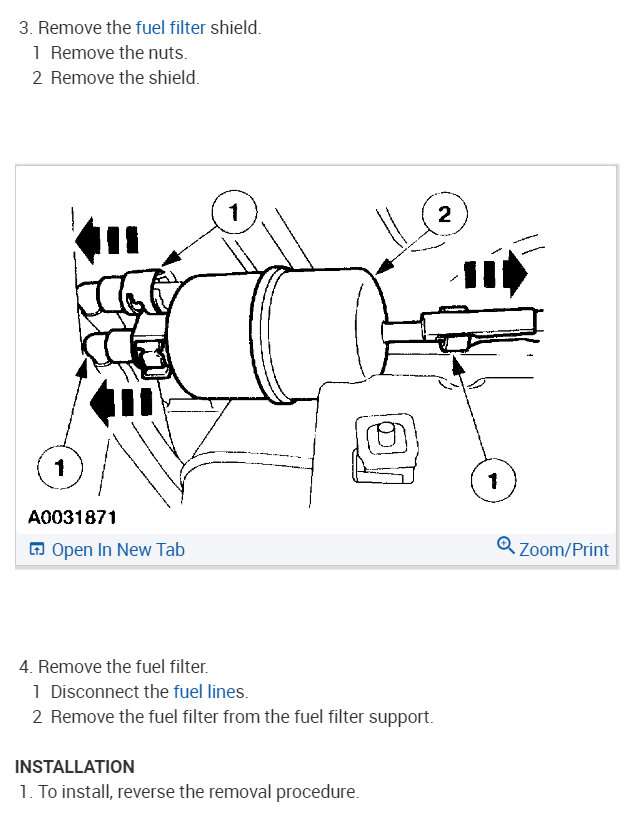

Need to change my fuel filter, please help.
Oct 27, 2023 at 8:10 AM
Experienced Mechanic
55,554 POSTS
Sure, here is a guide to help walk you through the steps with instructions below for your car:
https://www.2carpros.com/articles/how-to-change-a-fuel-filter
This video can help as well:
https://youtu.be/wi6kzRjk5to?si=7EMx2p1VXHrHHJPh
Check out the images (below). Please let us know if you need anything else to get the problem fixed.
