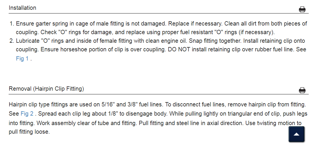

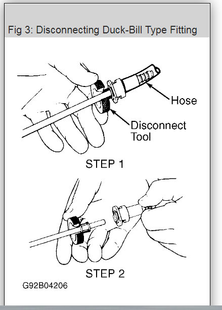

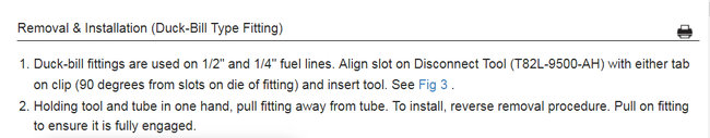

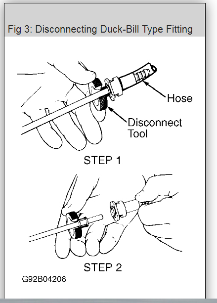

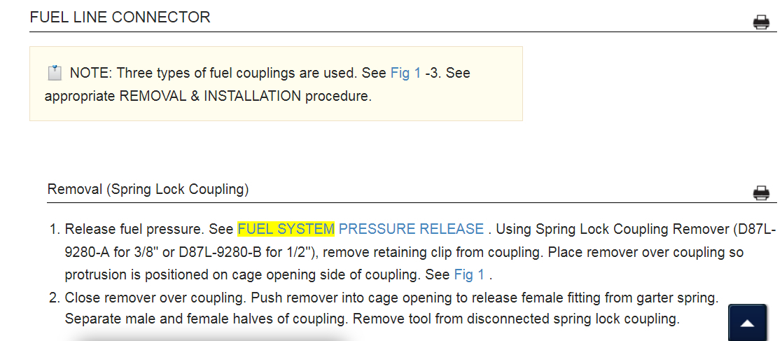

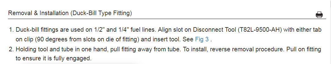

Where is the fuel filter located?
Apr 6, 2019 at 11:40 AM
SCGRANTURISMO
  • 4,897 POSTS

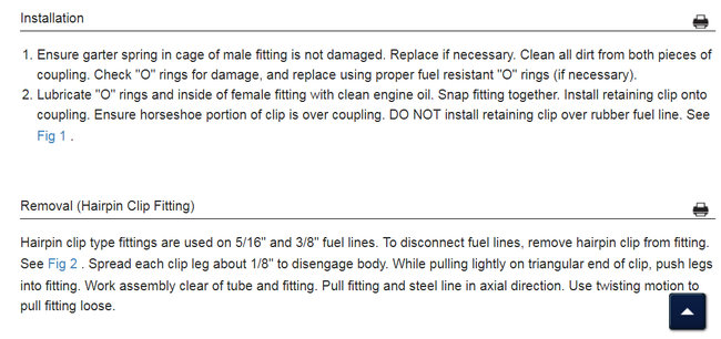

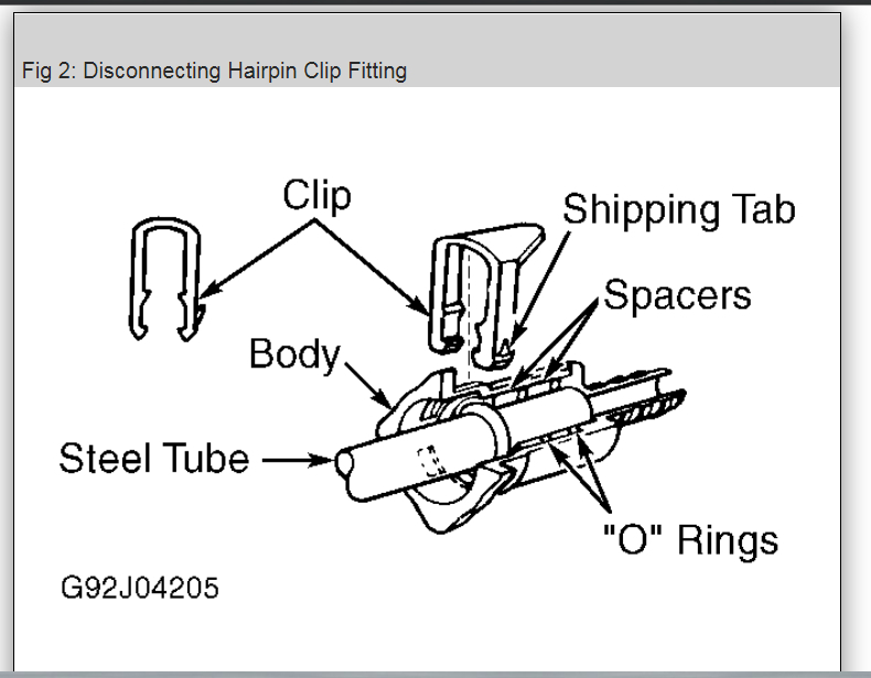

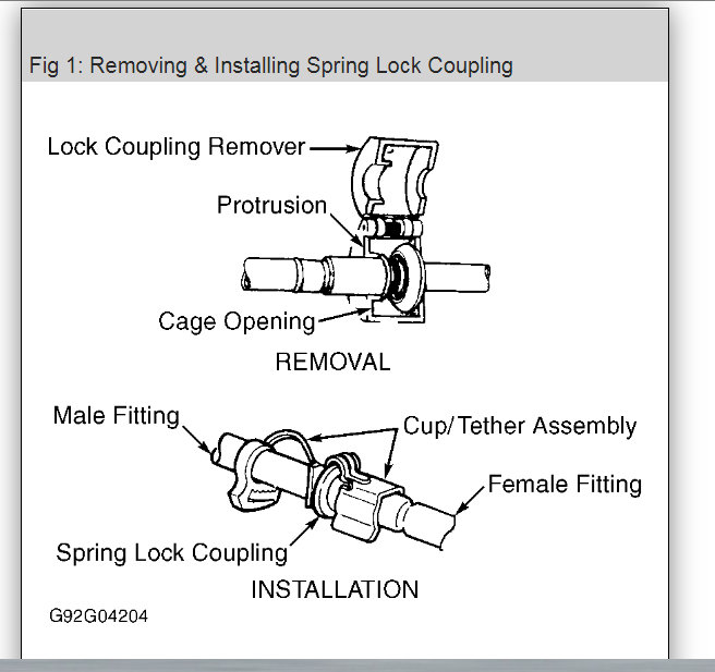

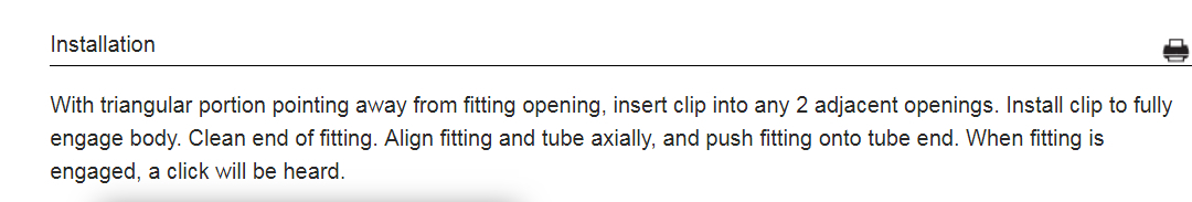

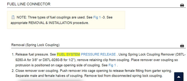

I have included the information that you requested down below in the diagrams. I have included not only the location but the removal and installation of all three different fuel filter types that your vehicle may have. Please feel free to ask any other car questions that you may have. That's what we are here for.
Thanks,
Alex
