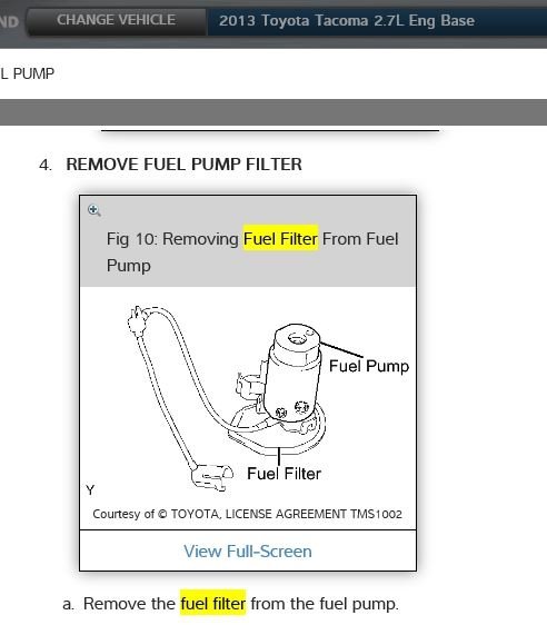

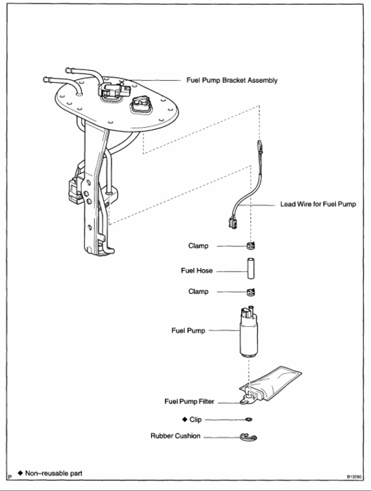

Where is located on the vehicle?
Feb 11, 2019 at 12:08 AM
PATENTED_REPAIR_PRO
  • 1,853 POSTS
Shown on the diagram below the fuel pump is located in the gas tank.
Feb 11, 2019 at 1:29 AM
MIKE RAMEY
Thank you for the information. so there is no inline fuel filter?
Feb 11, 2019 at 9:37 PM
PATENTED_REPAIR_PRO
  • 1,853 POSTS
You are welcome and no there is not an inline fuel filter. The older trucks had one under the manifold pipes but these trucks only have one as part of the pump assembly.

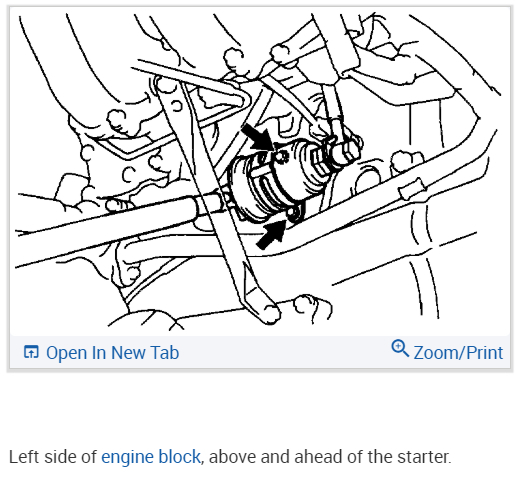

JACOB.M.HOUSE
where is the fuel filter located on a 2002 toyota tacoma with a 2.7 liter
Mar 6, 2021 at 2:31 AM (Merged)
  • 75,992 POSTS
Its in the fuel tank below the fuel pump. However, if you have the 2RZ-FE engine then you have a filter under the intake manifold as well.
The other engines only have one in the tank. I included info on this filter as well below. Please let us know if you have other questions. Thanks

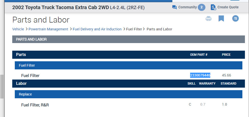

JDIZZ107978

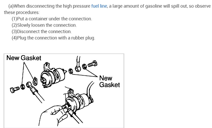

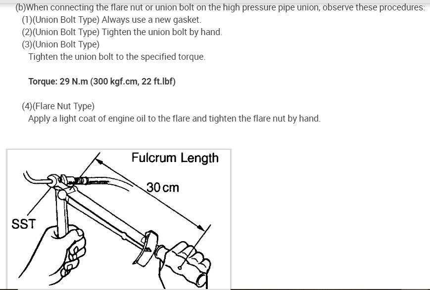

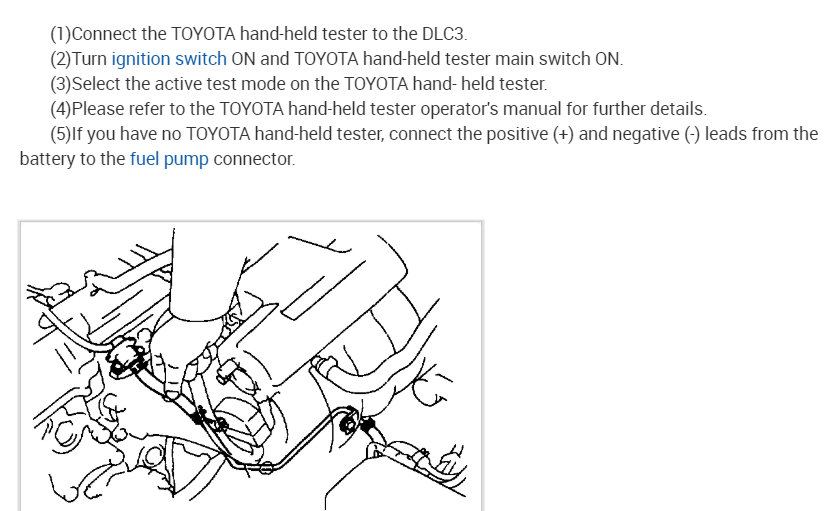

Can't find fuel filter. Please send images. Thanks

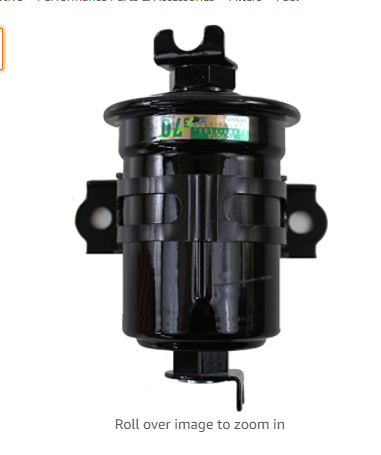

DANNY L
  • 5,648 POSTS

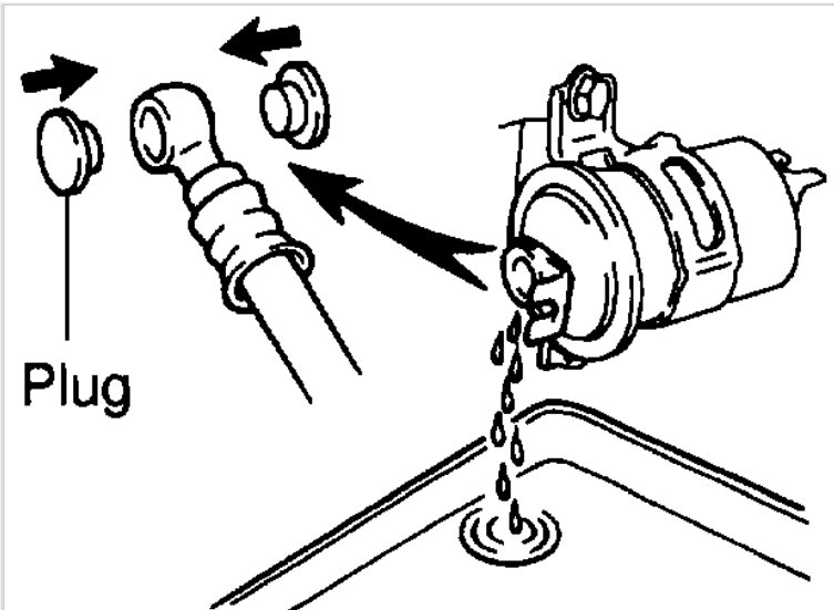

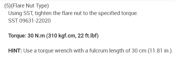

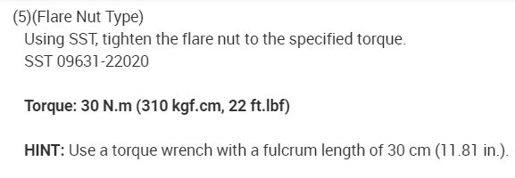

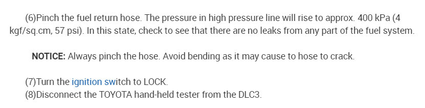

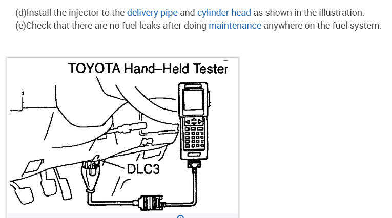

Hello,I'm Danny.
Here is a basic fuel filter tutorial for you to view for filter replacement:
https://www.2carpros.com/articles/how-to-change-a-fuel-filter
I've attached the location and picture steps on how to replace the filter for your truck below.Hope this helps and thanks for using 2CarPros.

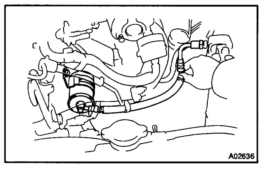

DANNY77762
the fuel filter is located up under the intake manifold, if you have big hands i wouldnt attempt to change it. you need 2 hands to work with it. good luck
