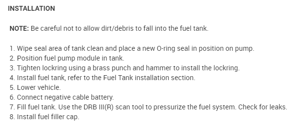

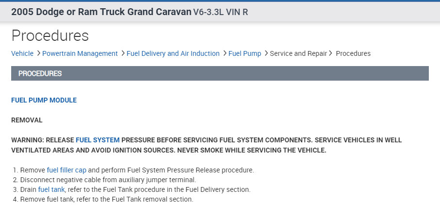

Some in the fuel pump others say on top of the fuel tank. Can youu tell me where?

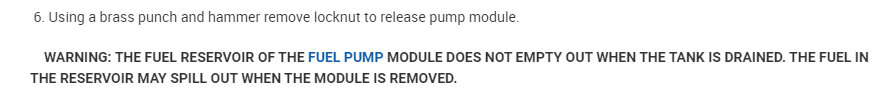

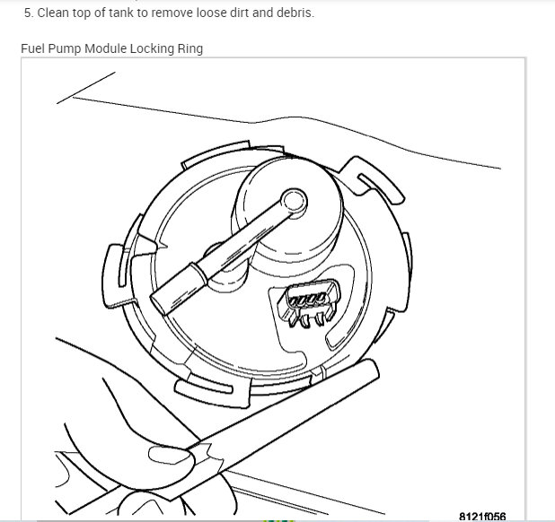

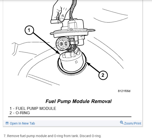

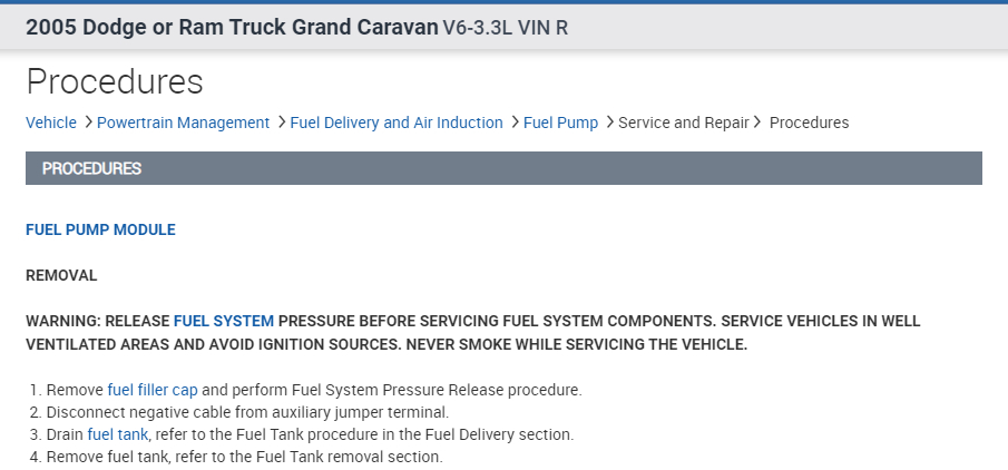

The fuel pump is inside the fuel tank. To access it, you need to remove the fuel tank. Once it is removed, the fuel pump and fuel pump module are removed as a unit from the tank.
If you look below, I attached the directions for replacing the pump. If you need help with the tank removal, let me know.
Also, take a look at this link. I feel it will be helpful. It explains in general how a pump is replaced.
