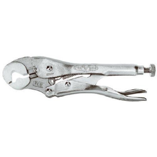

The bottom 14mm flare fuel line nut is rounded on one or more edges and will not turn with a 14mm flare wrench on the nut and a 19mm wrench on the filter. The top 17mm banjo bolt was removed with a breaker bar. The question is how to remove the rounded 14mm fuel line nut without breaking the fuel line to remove nut and then replace it?

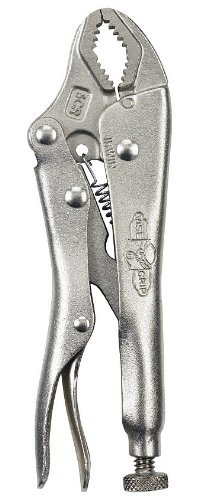

Have you ever used vise grips to remove a line nut?
I was not able to find any open-end extractor wrench locally at any of the parts or tools stores. They only have the extractor sockets and or closed-end grip-tite wrench set at Advanced. Do you know any local store that sells one?

I have used multiple tools when removing rounded fasteners from vice grips to just cutting the line and replacing a section to get things apart. My favorite ones for those are the ones pictured below. They grab more of the nut. The next option would be to just cut the line off as close to the nut as possible and re-flare the line with a new nut.
