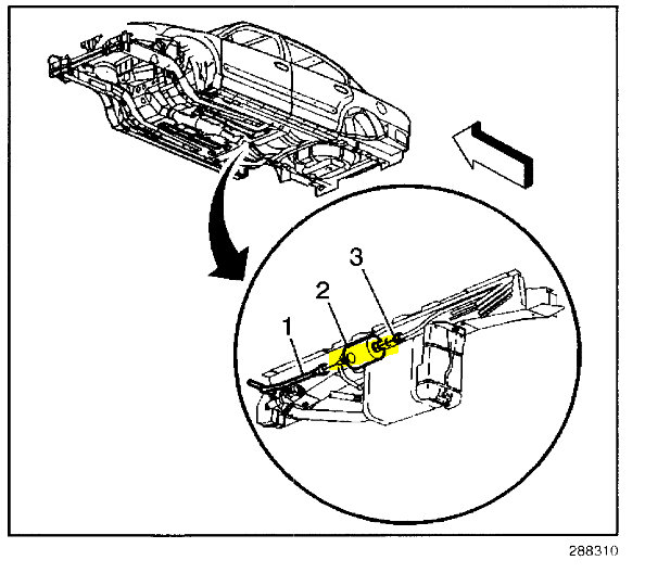

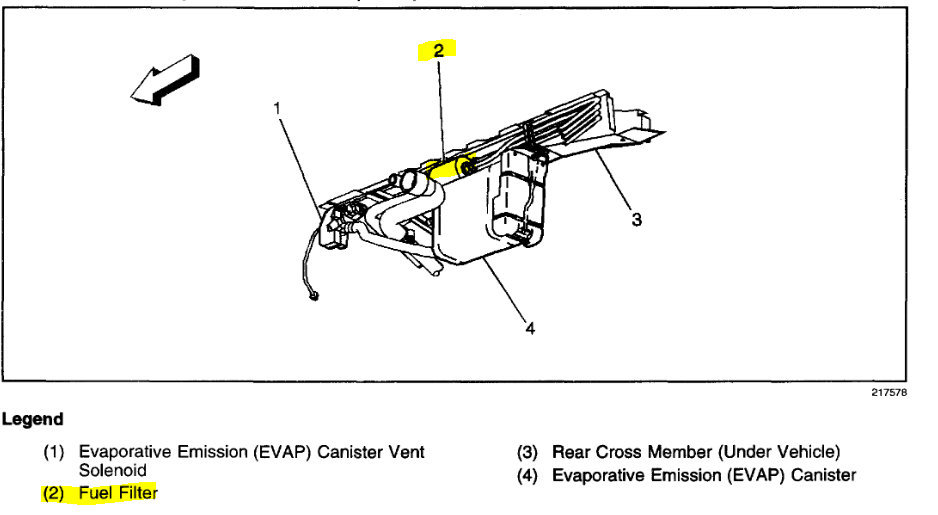

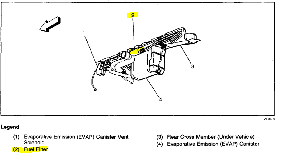

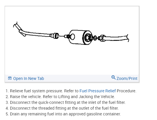

I would try this first to confirm it is a fuel issue. If, however, you want to replace the fuel filter first, I attached the directions specific to your vehicle below. The filter is near the charcoal canister under the vehicle. Also, here is a link you may find helpful as well:

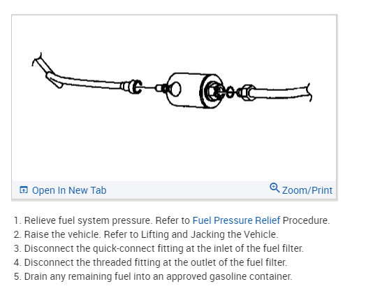

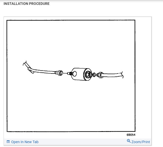

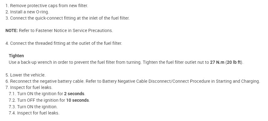

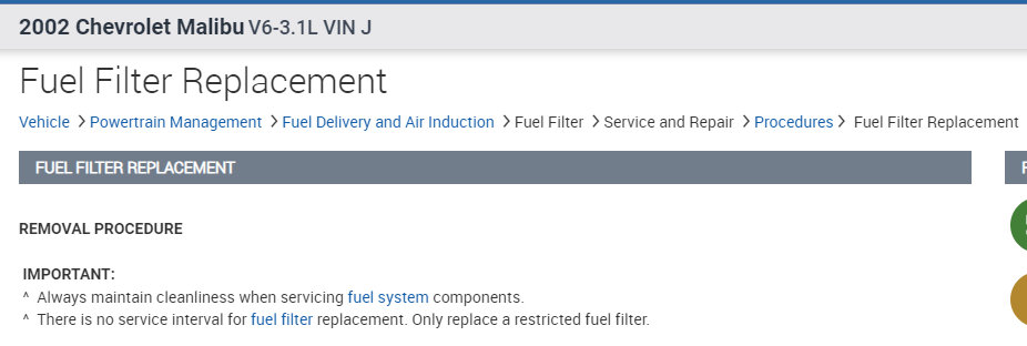

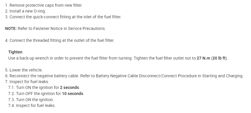

See pics below. Note: the first two pics are to help you locate the filter. The remaining pictures are the procedures for replacing it.
