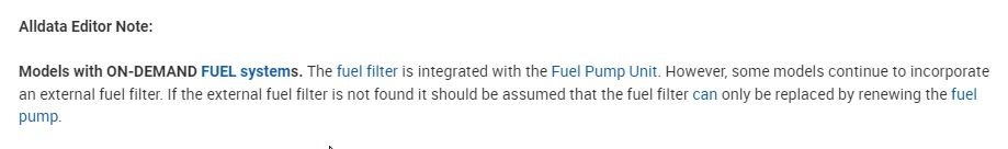

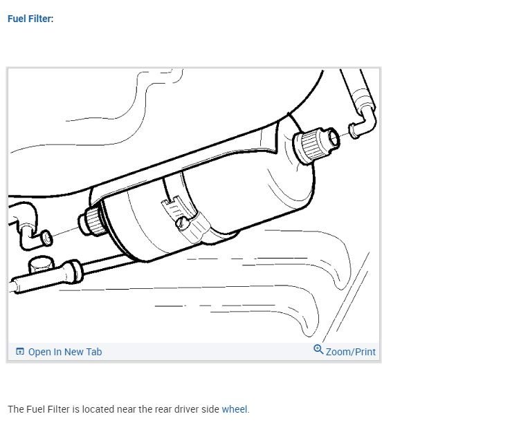

trying to locate to replace fuel filter 2004 s40 t5.

I attached the locations to the thread. Please note the second attachment because if you don't have a filter in the location on the first attachment then you only have one in the tank.
If you have just a filter in the tank then it does not require replacement unless the pump needs to be removed for another reason.
