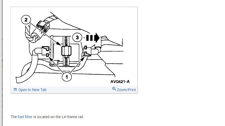

I just need a fuel filter replacement...
Jun 12, 2021 at 7:21 AM
I am not sure we have the correct engine noted. Was this supposed to be a 3.0L as this was the only option in this year? Plus there was not a turbo option.

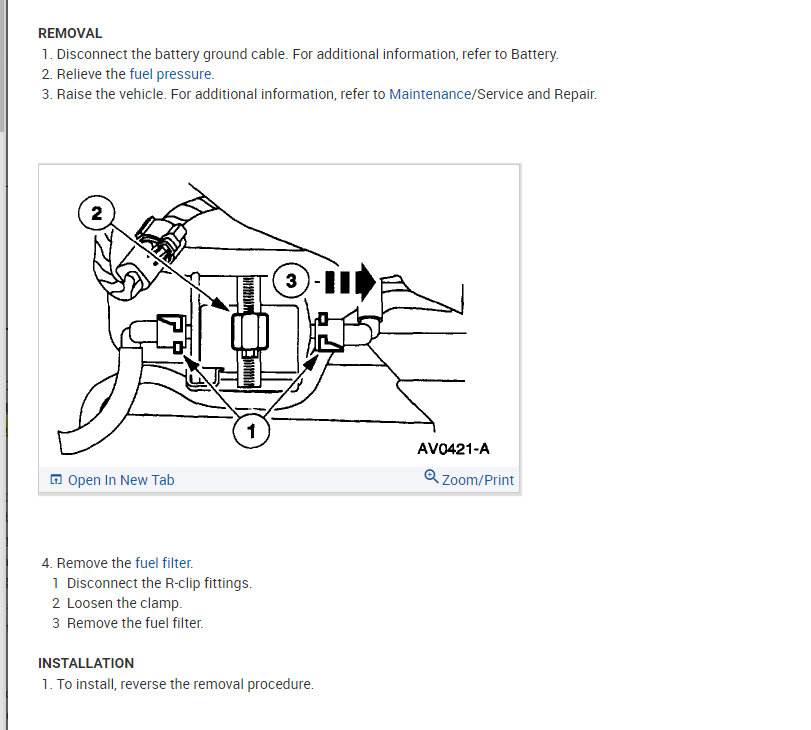

Here is a guide that will help with step by step instruction on how to do this as the manual is not detailed:
https://www.2carpros.com/articles/how-to-change-a-fuel-filter
I attached the info on this fuel filter below which will show your location. Please let us know if you have other questions. Thanks
