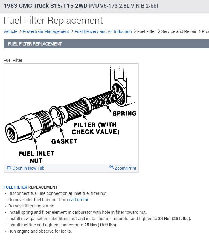

Where is filter in the truck listed above?
Jun 15, 2022 at 5:12 AM
SQM
Experienced Mechanic
6,383 POSTS
The factory fuel filter is located where the fuel line to attached to the carburetor.
See attached diagram for reference.
Let me know of any questions.
