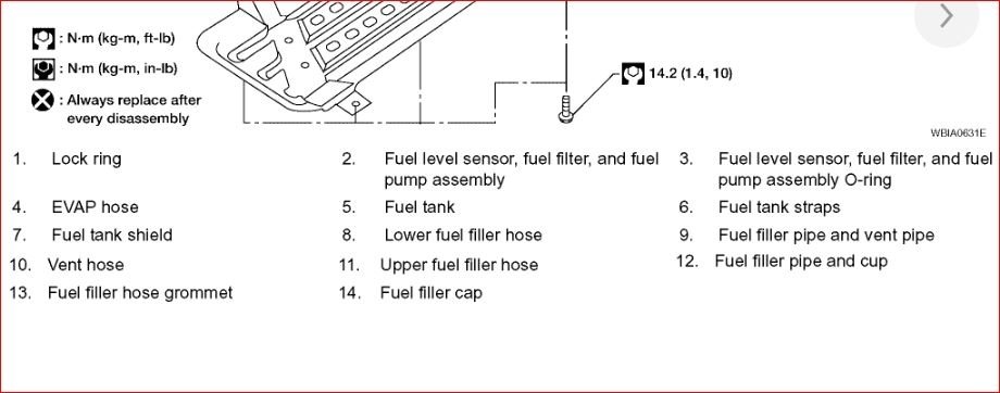

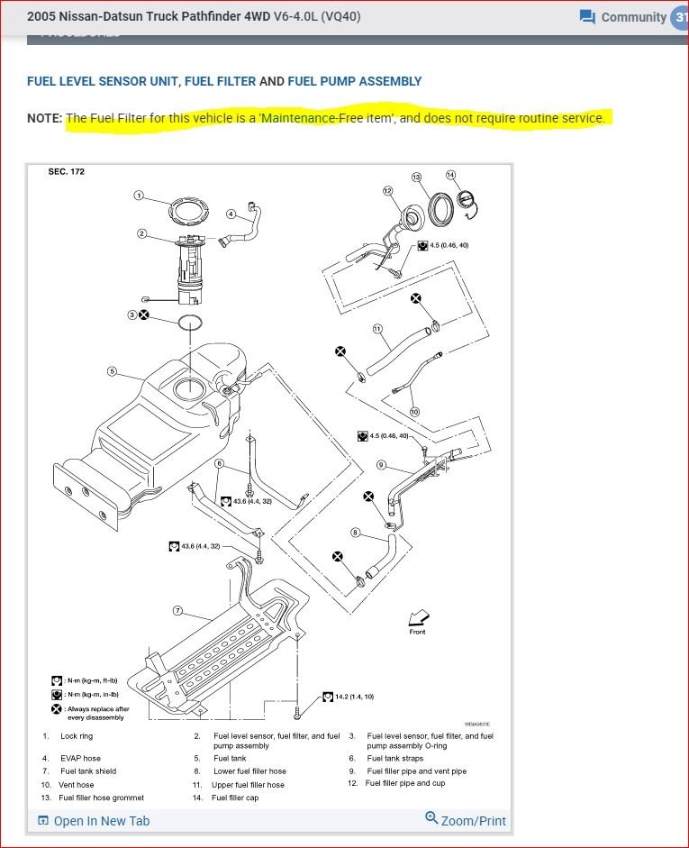

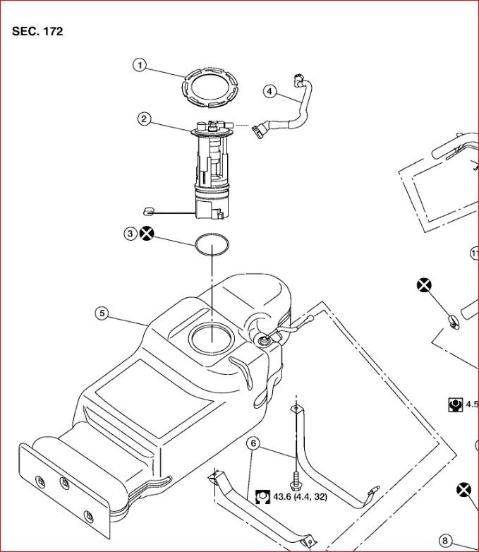

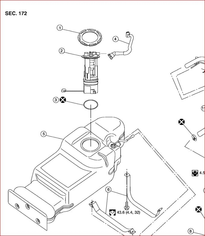

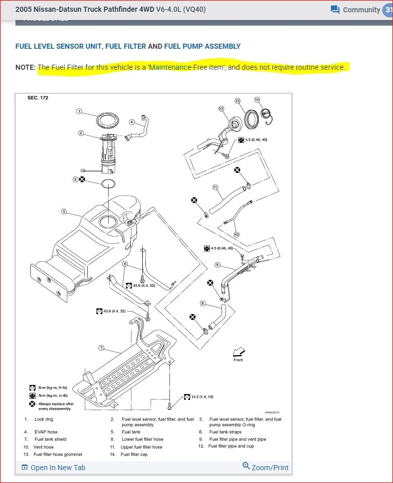

Where is the fuel filter located on my vehicle listed above?
May 22, 2019 at 10:24 AM
Hi Quicksilva08,
You don't have a serviceable fuel filter on this vehicle. It is part of the pump assembly and is only replaced if it is removed from the tank.
Please see the attachments for more details. Let me know if you have more questions. Thank you for using 2CarPros.
