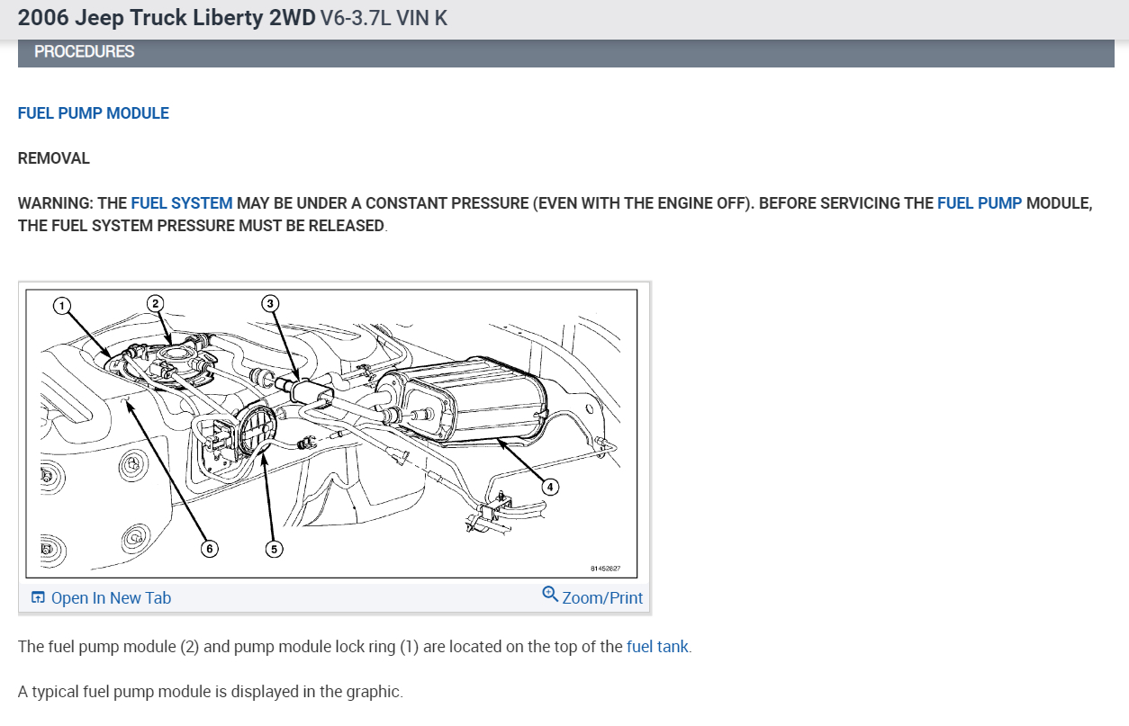

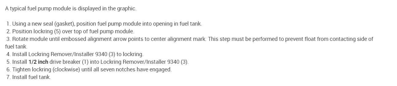

How do I get to the fuel filter?
2006 JEEP LIBERTY
100,000 MILES • 3.7L • AUTOMATIC
MNELSON08
  • 19 POSTS
Sep 26, 2022 at 5:47 AM
  • 55,427 POSTS

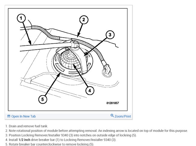

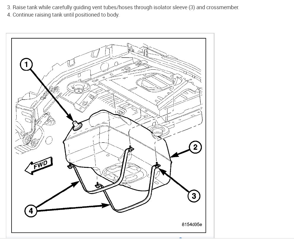

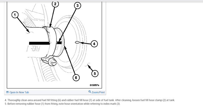

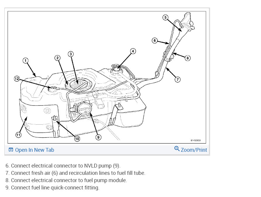

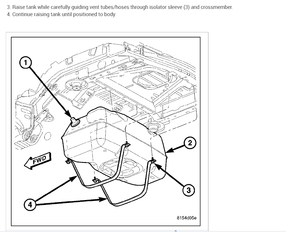

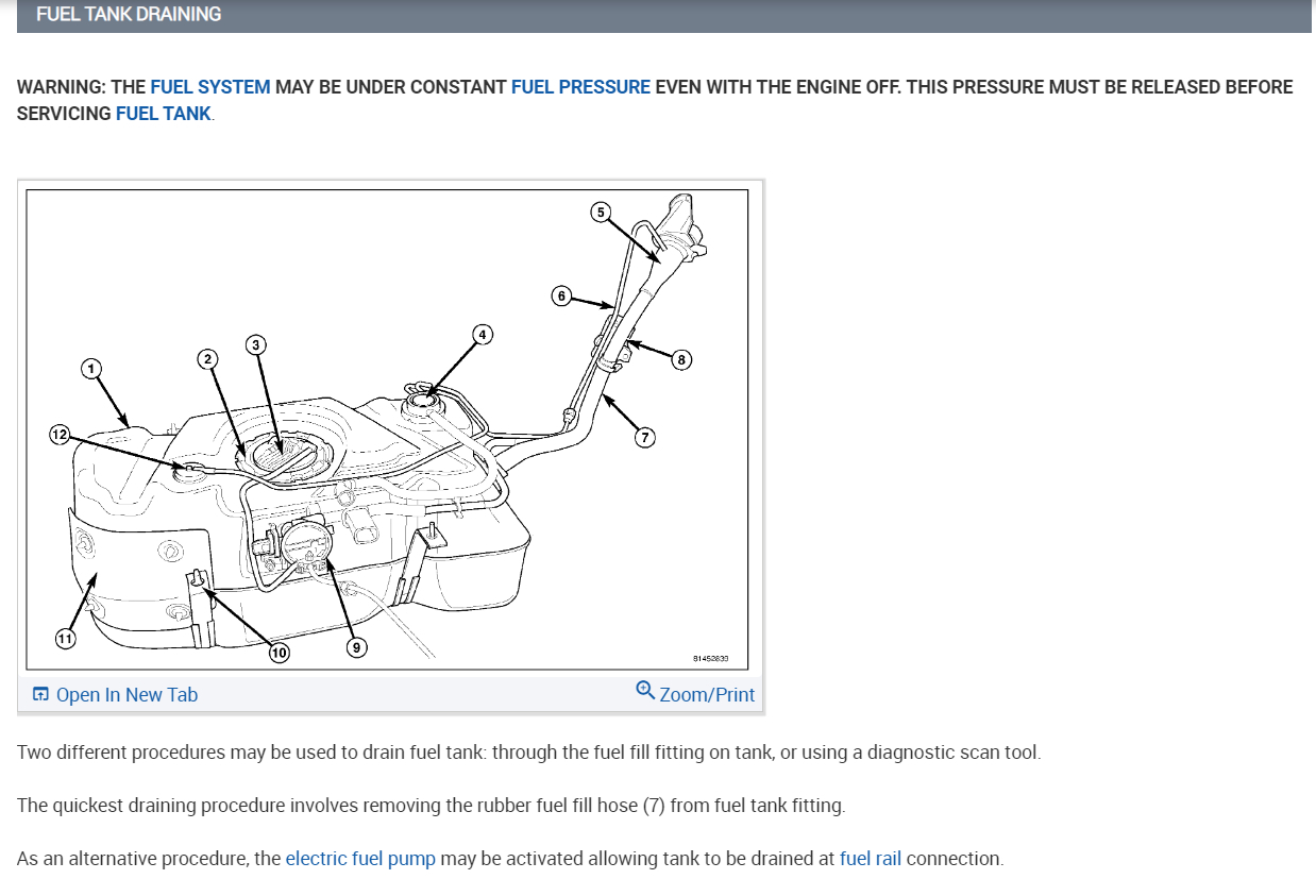

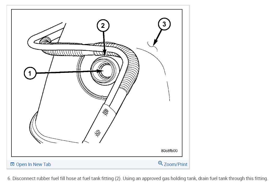

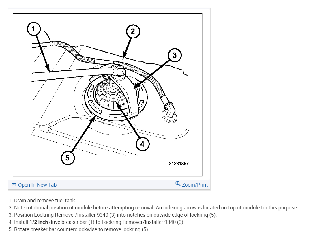

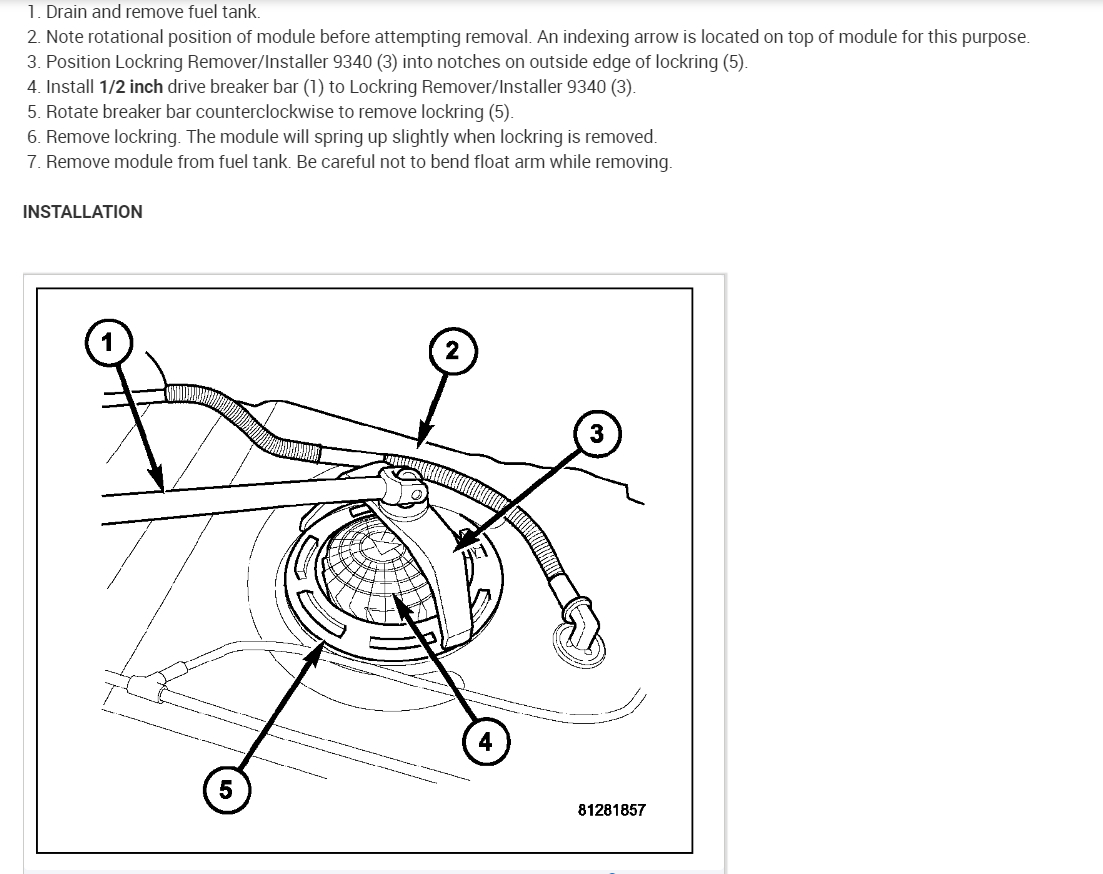

The fuel filter and fuel pressure regulator are combined within the fuel pump module assembly. They are not serviceable unless you replace the fuel pump. Here are the instructions in the images below on how to change the fuel filter and fuel pump out.
Here is a video to help drain the tank and check out the tips in the instructions below:
https://youtu.be/Q5MH2gnyFH0
Check out the images (below). Please let us know if you need anything else to get the problem fixed.
