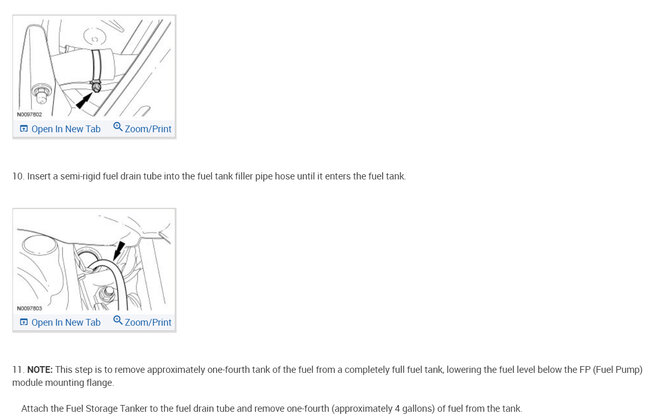

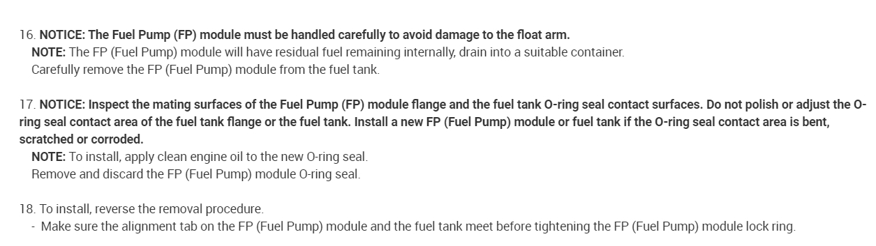

I believe my fuel filter is clogged. But I don't know exactly where it's located. A diagram would be greatly appreciated. thank you.
Aug 15, 2023 at 10:48 PM
  • 55,721 POSTS

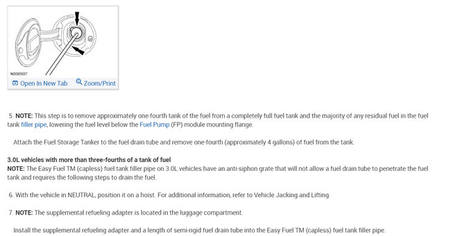

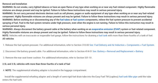

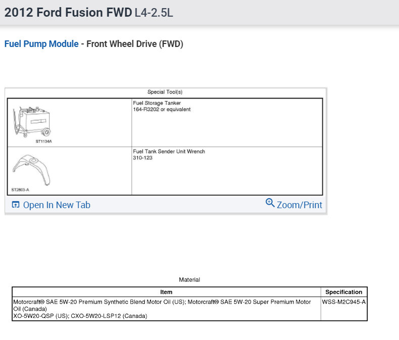

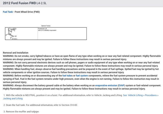

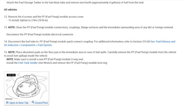

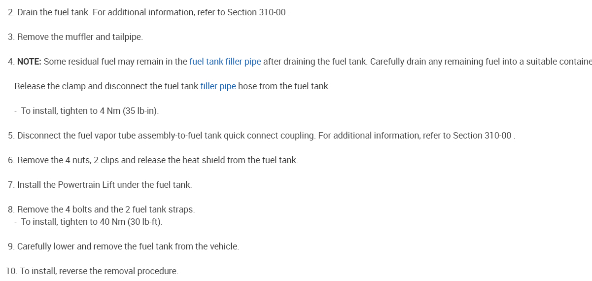

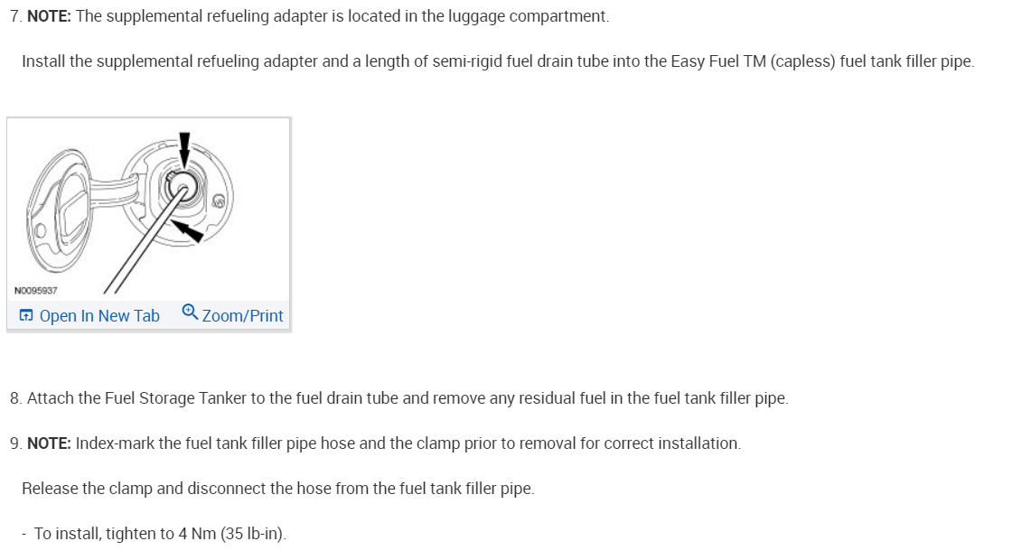

The fuel filter is in the tank attached to the fuel pump; here are the instructions on how to change the pump and filter out, which means the fuel tank will need to be removed. Please check out this video:
https://youtu.be/Q5MH2gnyFH0
Check out the images (below). Please let us know if you need anything else to get the problem fixed.
