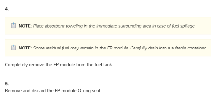

Cannot find fuel filter on car. Tried googling but get several different answers and not where anyone says.
Thank you for any help.

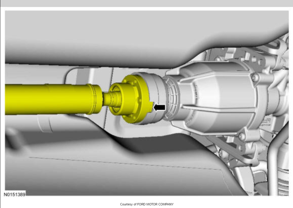

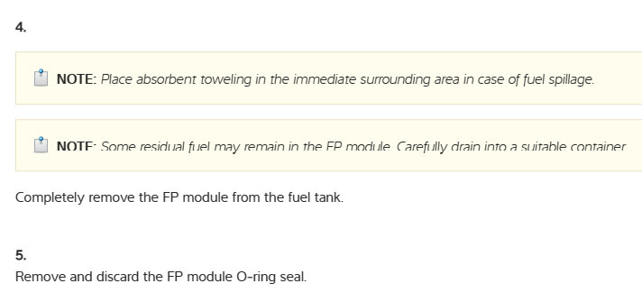

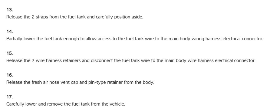

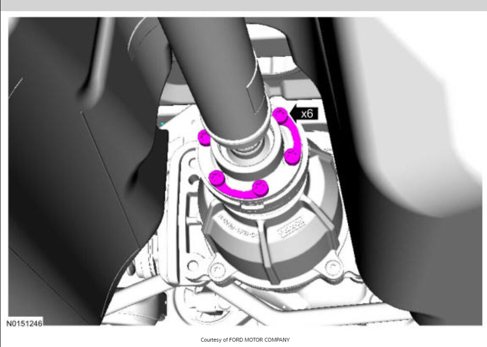

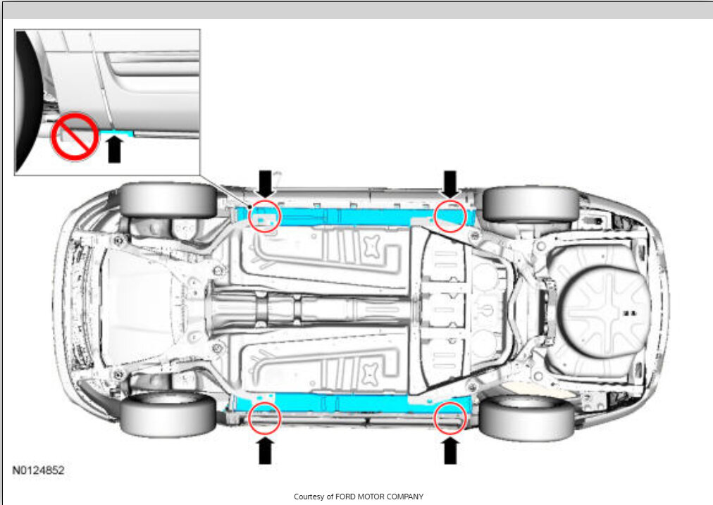

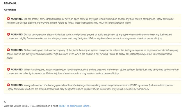

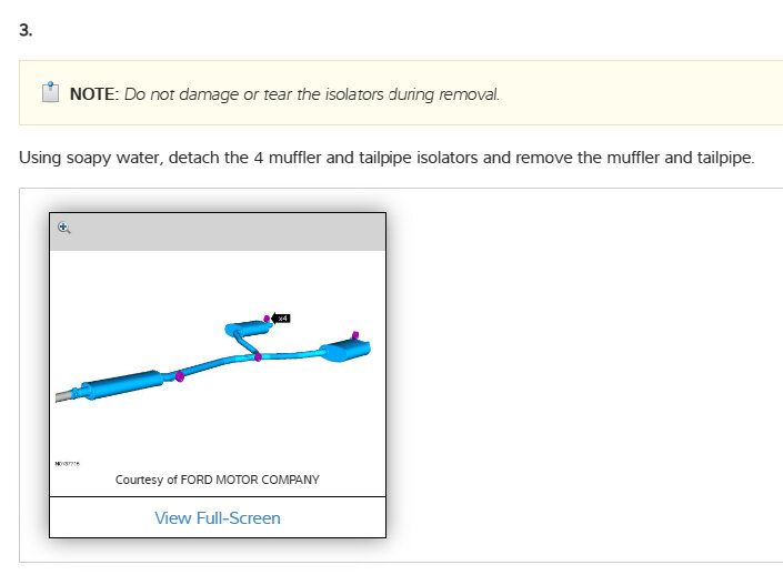

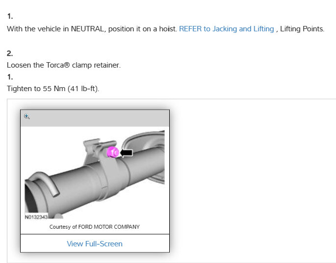

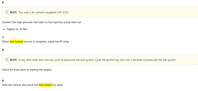

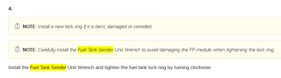

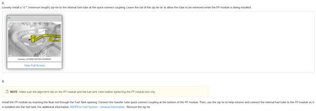

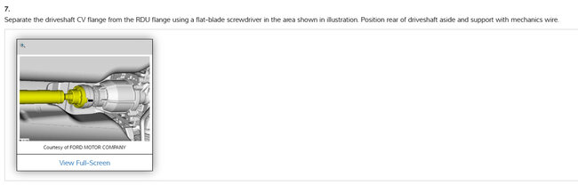

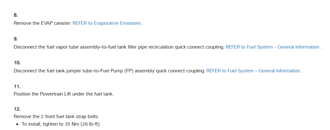

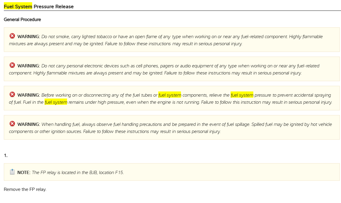

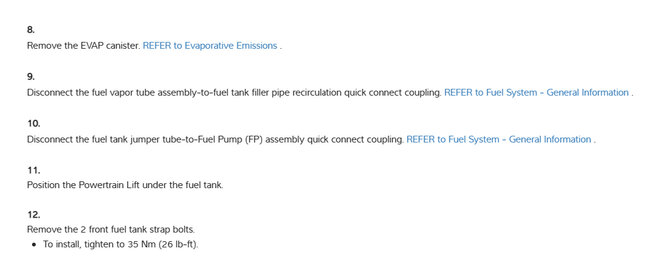

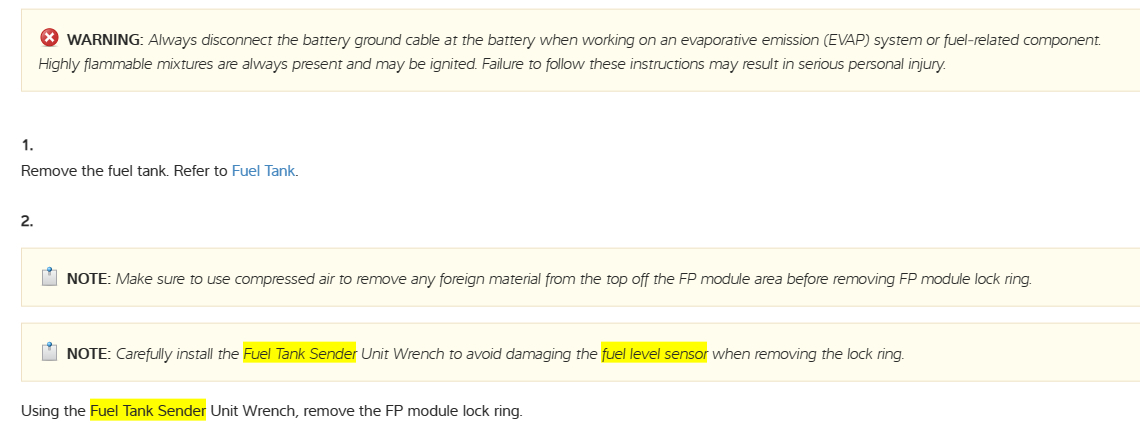

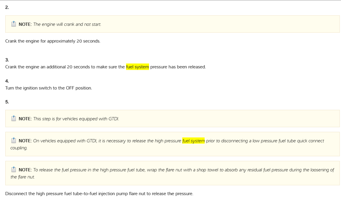

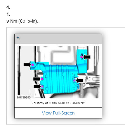

Good morning, JERRI FORREST,

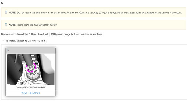

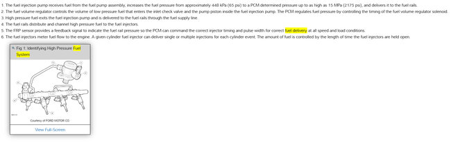

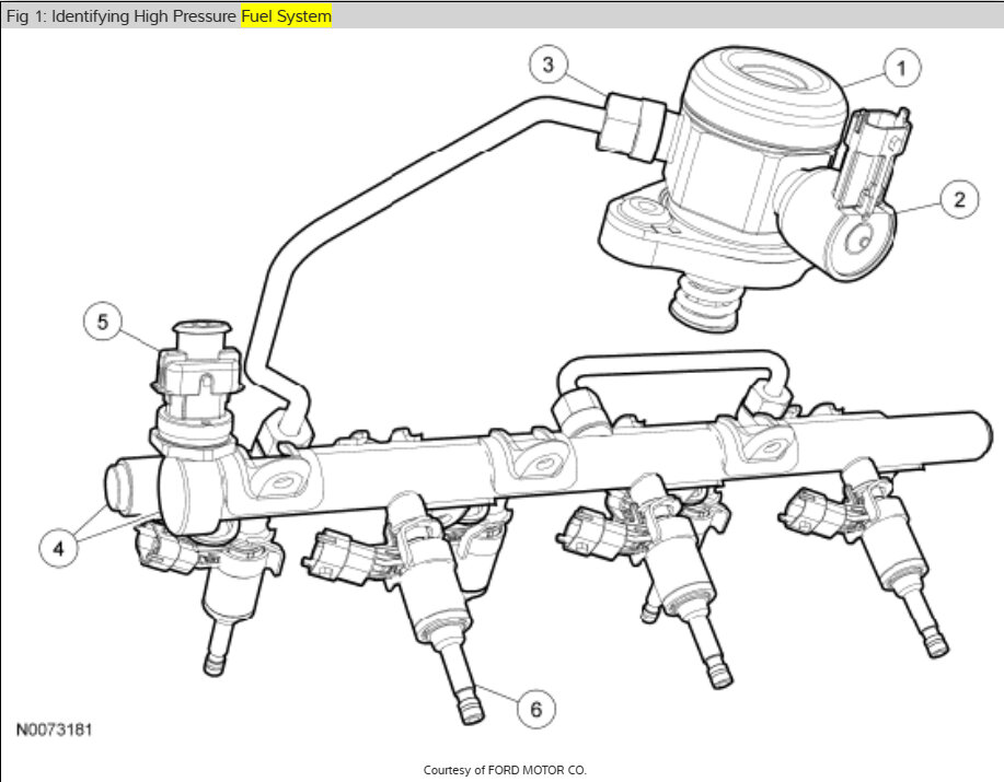

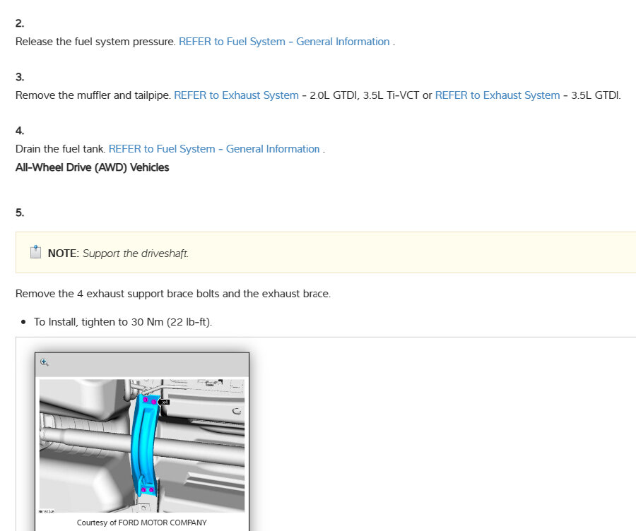

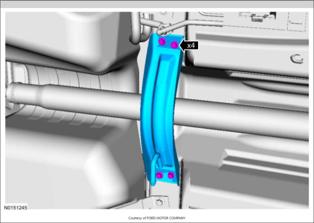

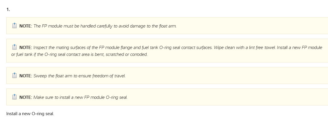

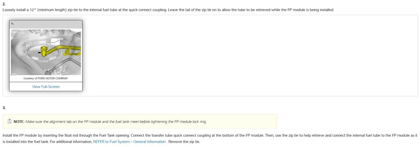

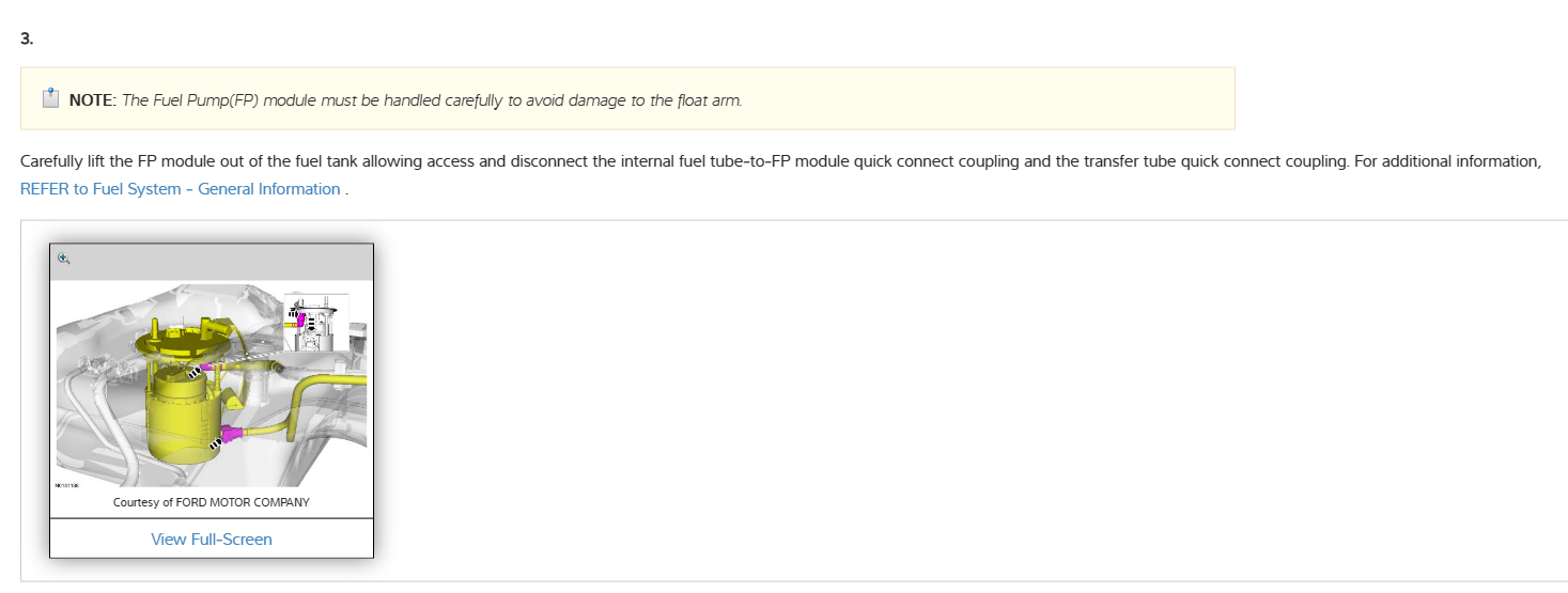

According to my information this vehicle is equipped with a lifetime filter and is not serviceable unless the fuel pump is changed.

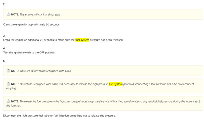

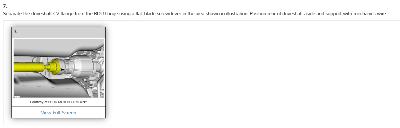

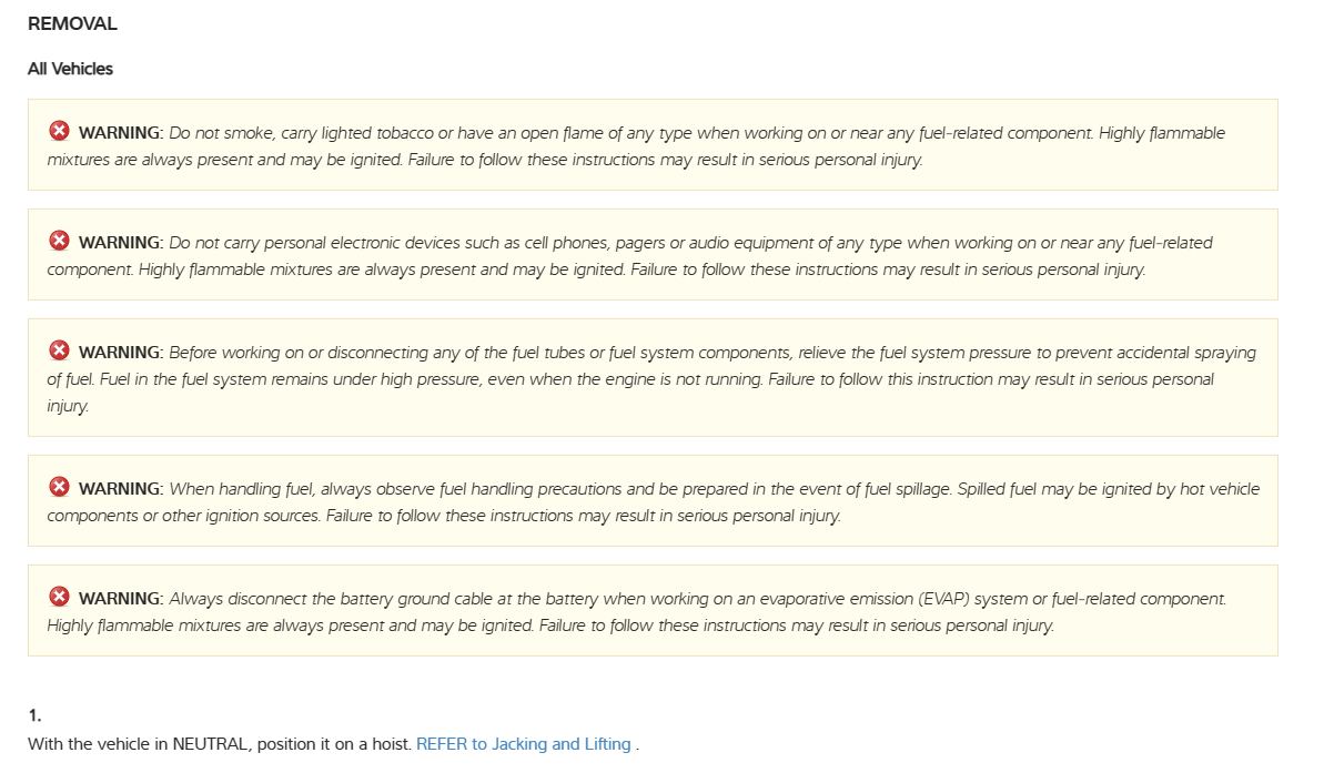

I am adding procedures for fuel pump removal, fuel tank removal, jacking and lifting points, muffler and tail pipe removal for 2.0L and 3.5L, emissions canister removal, as well as fuel pressure relief procedure in case you need it. Toque specs are included within instructions.
Please let me know if I can clarify anything or if you need any other information.
