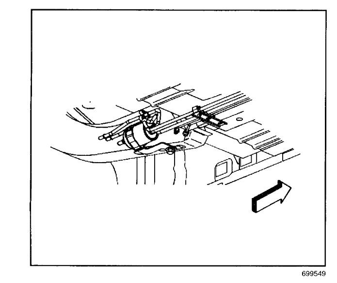

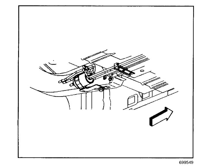

Where is the fuel filter located in my car? I have looked in all of these suggested areas and do not see it. Is it inside the fuel tank? If yes, how do I access it to change the filter myself?
Jul 17, 2019 at 2:11 PM
Good evening,
The filter is located just in front of the fuel tank under the car. This guide will help walk you through the repair with diagrams below to show you how on your car

  • 75,992 POSTS
The fuel filter is located on the fuel feed pipe, between the fuel pump and the fuel rail under the car toward the fuel tank. You will need to raise the car in the air to get to it.
Here is a guide that should help.
https://www.2carpros.com/articles/how-to-change-a-fuel-filter

JDL
  • 16,098 POSTS
Hello, my info shows, under the vehicle, rear of gas tank. You may have to safely raise and support the vehicle to get a look at it?

BLUELIGHTNIN6
  • 16,542 POSTS
It is under vehicle, center, below trunk area, rear of fuel tank, mounted in fuel line and Pontiac does not list a mileage interval to replace the fuel filter. If you suspect low fuel pressure than the fuel filter is a good place to start diagnostics.

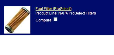

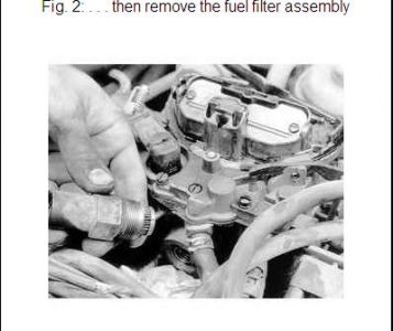

SANDYPED
Engine Mechanical problem
1981 Pontiac Grand Prix V8 Two Wheel Drive Automatic
my car won't turn over. could it need just a new fuel filter? If so where is it? Is it right up against the carb or under the car
Oct 14, 2020 at 12:40 PM (Merged)
JDL
  • 16,098 POSTS
hi, thanks for the donation, my info shows it is in the fuel line, next to carb. Are you saying it cranks good but won't start, or it won't even crank?
https://images.2carpros.com/forum/automotive_pictures/170934_81_pontiac_fuel_filter_1.jpg
https://images.2carpros.com/forum/automotive_pictures/170934_fuel_filter_picture_1.jpg
SANDYPED
Yes it does crank, it just is not getting fuel. can't even smell it.
JDL
  • 16,098 POSTS
You may be headed in the right direction. If you open the choke and look down throttle-bore while working the accelerator, can you see gas squirt? If not, possible problem with fuel pump-- filter--maybe you need to put a carb kit in it.
