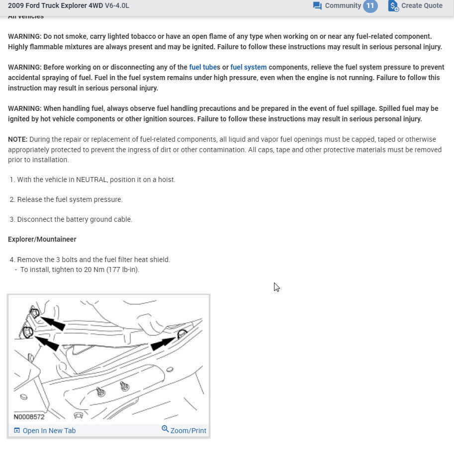

It is in the back of the truck by the tank. This video will help you remove the filter with instructions below to show you how to replace the fuel filter in your car.
https://youtu.be/Boi0DPXVHbM
and
https://www.2carpros.com/articles/how-to-change-a-fuel-filter
The procedure is below with some pictures.
WARNING: Do not smoke, carry lighted tobacco or have an open flame of any type when working on or near any fuel-related component. Highly flammable mixtures are always present and may be ignited. Failure to follow these instructions may result in serious personal injury.
WARNING: Before working on or disconnecting any of the fuel tubes or fuel system components, relieve the fuel system pressure to prevent accidental spraying of fuel. Fuel in the fuel system remains under high pressure, even when the engine is not running. Failure to follow this instruction may result in serious personal injury.
WARNING: When handling fuel, always observe fuel handling precautions and be prepared in the event of fuel spillage. Spilled fuel may be ignited by hot vehicle components or other ignition sources. Failure to follow these instructions may result in serious personal injury.
NOTE: During the repair or replacement of fuel-related components, all liquid and vapor fuel openings must be capped, taped or otherwise appropriately protected to prevent the ingress of dirt or other contamination. All caps, tape and other protective materials must be removed prior to installation.
1. With the vehicle in NEUTRAL, position it on a hoist.
2. Release the fuel system pressure.
3. Disconnect the battery ground cable.

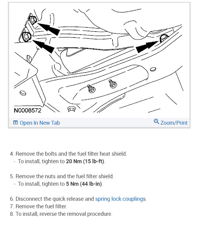

Explorer/Mountaineer

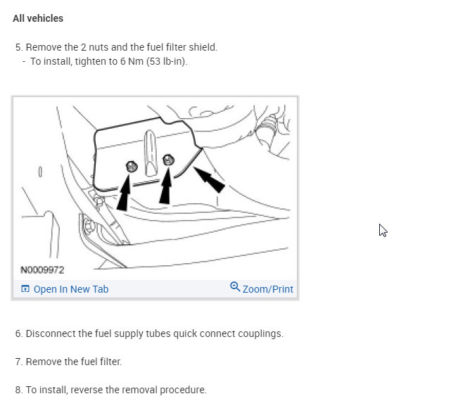

4. Remove the 3 bolts and the fuel filter heat shield.
- To install, tighten to 20 Nm (177 lb-in).
All vehicles
5. Remove the 2 nuts and the fuel filter shield.
- To install, tighten to 6 Nm (53 lb-in).
6. Disconnect the fuel supply tubes quick connect couplings.
7. Remove the fuel filter.
8. To install, reverse the removal procedure.

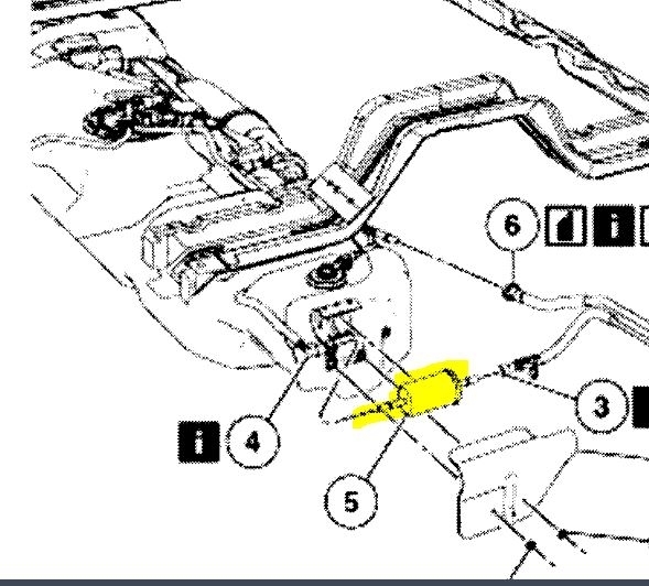

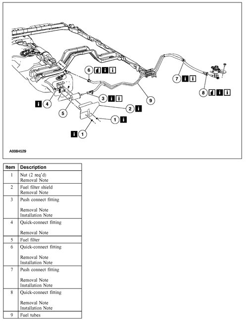

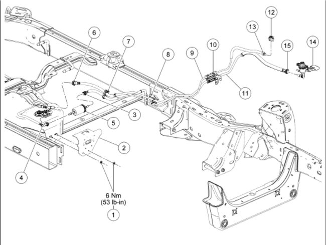

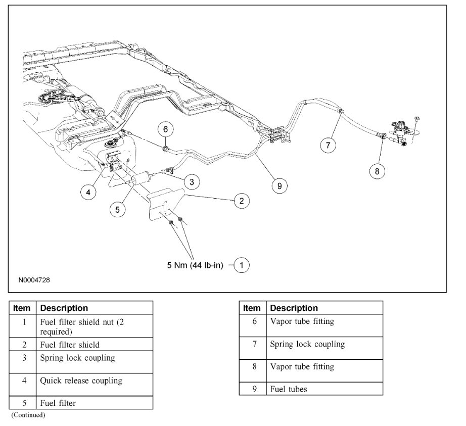

Hi Gary, welcome to 2CarPros.
You will find a diagram below showing the fuel filter location. The fuel filter is number 5. If you need any further help please let us know.
Rich.

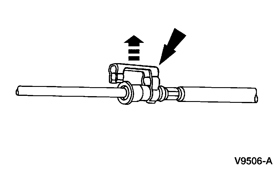

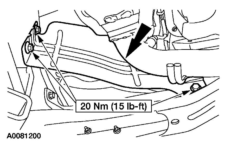

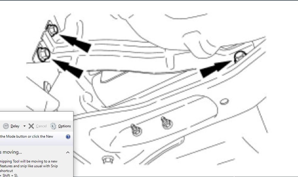

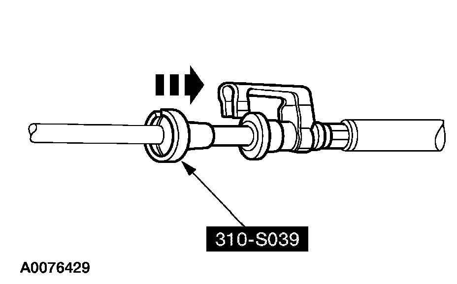

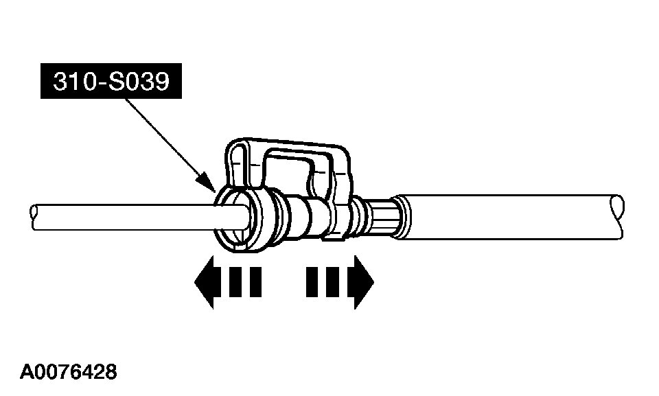

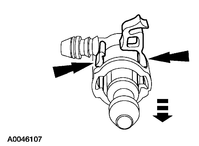

It is in front of the fuel tank behind a protection shield. See picture 1.
Here are the directions for fuel line/fuel filter replacement. The additional attached pictures correlate with the directions.

Disconnect Tool, Push Connect
pic 1
SPECIAL TOOL(S)
REMOVAL

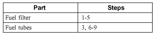

pic 2 and 3
5. Remove the parts in the order indicated in the illustration and table. To remove individual parts, only carry out the listed steps.

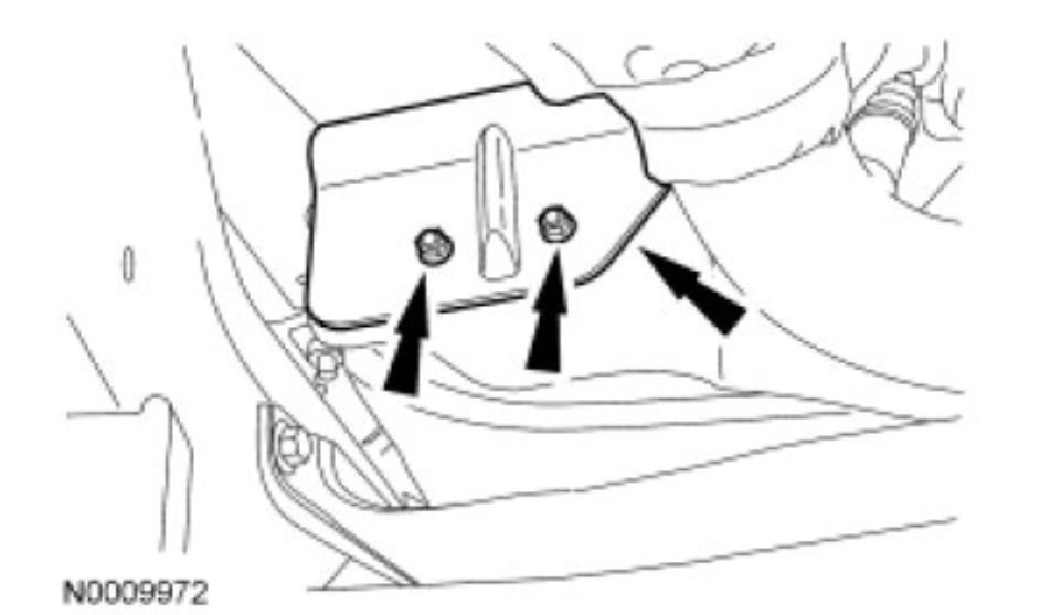

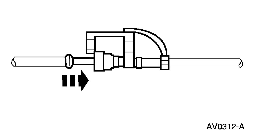

Items 1 and 2: Fuel Filter Shield and Nuts Removal Note
pic 4
1. Remove the nuts and the heat shield.

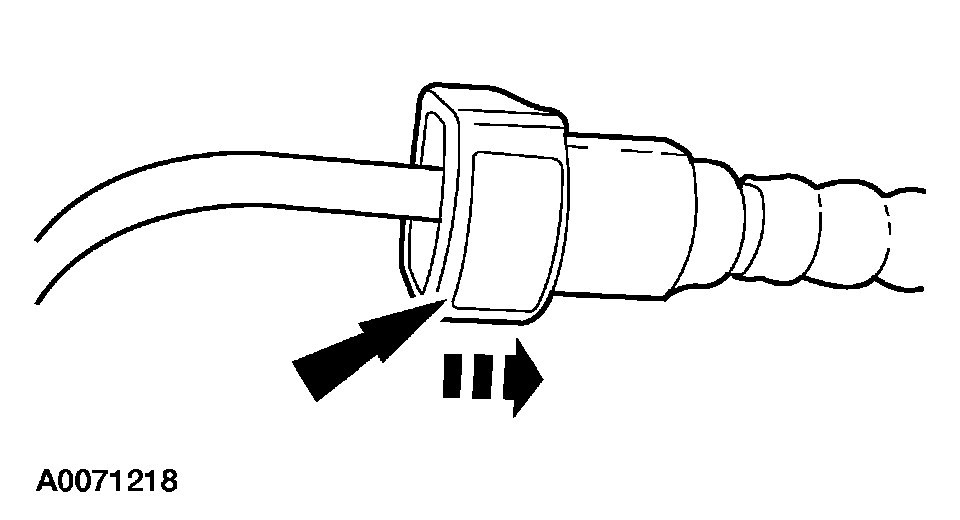

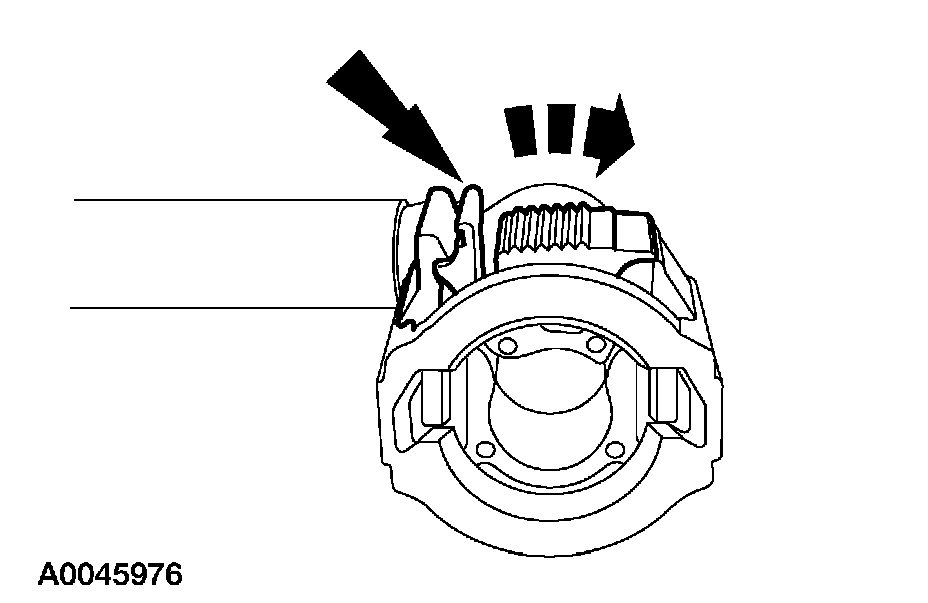

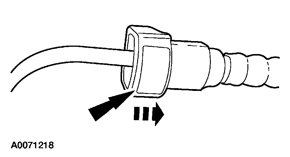

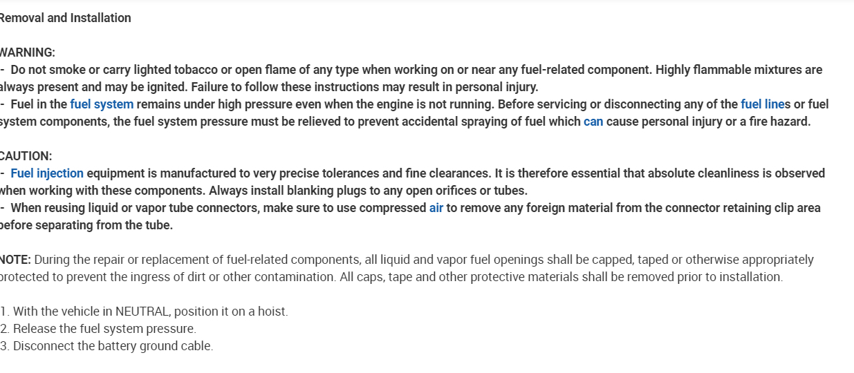

Items 3 and 7: Push Connect Fitting Removal Note
pic 5

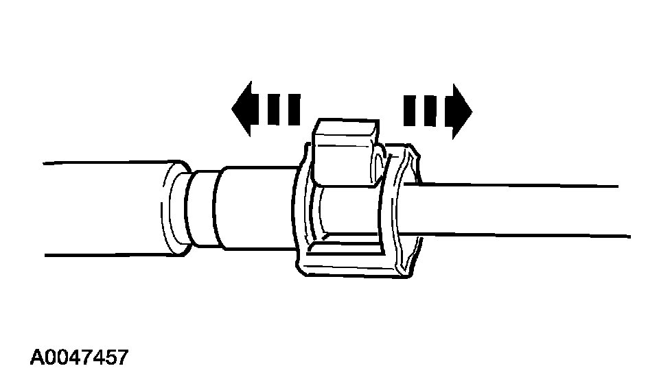

1. WARNING:
- Do not smoke or carry lighted tobacco or open flame of any type when working on or near any fuel-related components. Highly flammable mixtures are always present and may be ignited, resulting in possible personal injury.
- Fuel in the fuel system remains under high pressure even when the engine is not running. Before servicing or disconnecting any of the fuel lines or fuel system components, the fuel system pressure must be relieved to prevent accidental spraying of fuel, which can cause personal injury or a fire hazard.
If equipped, disconnect the safety clip from the fuel tube.

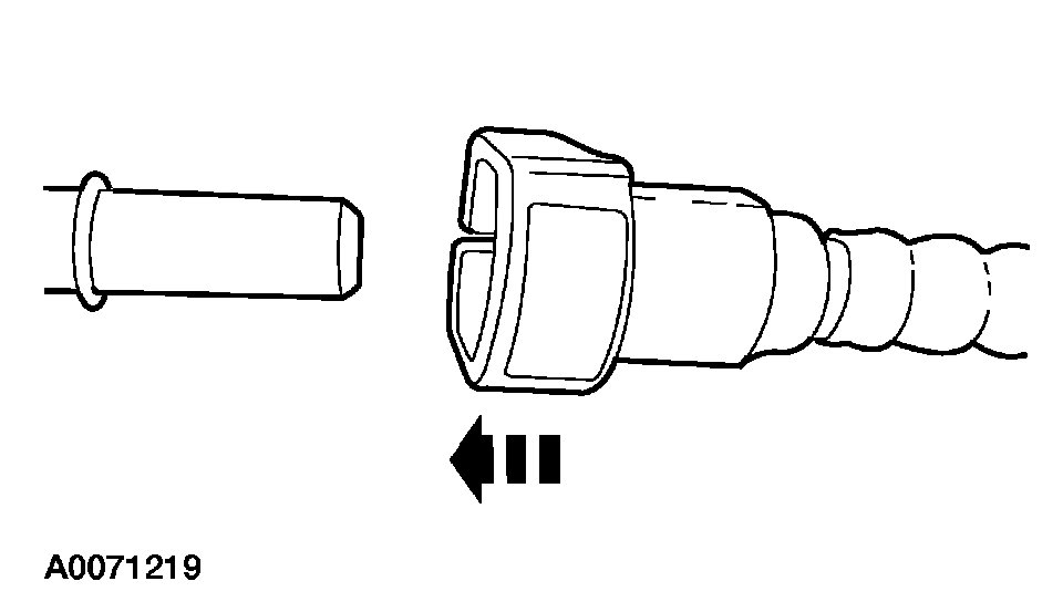

pic 6
2. Install the special tool and press it into the fitting.
pic 7
3. Separate the fittings.
