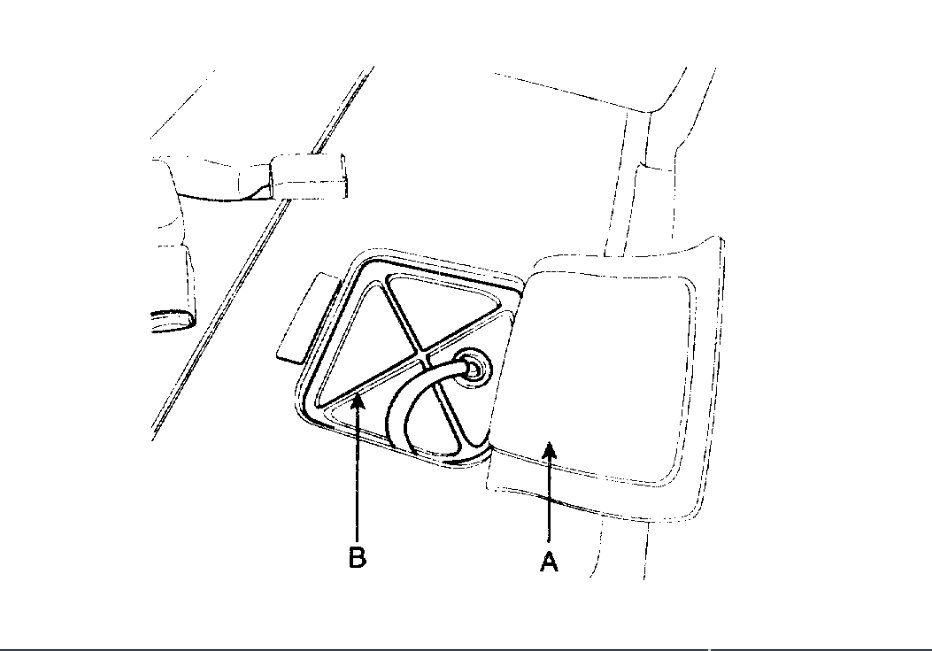

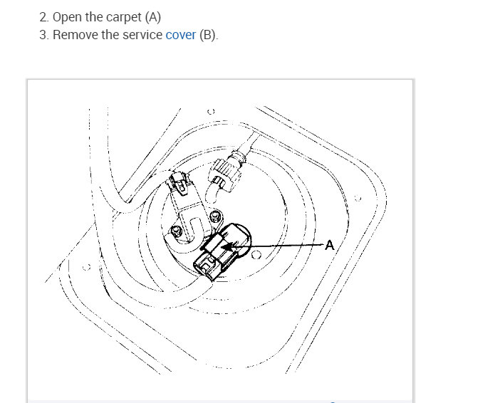

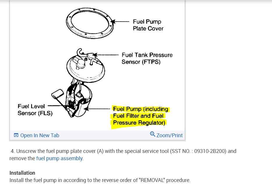

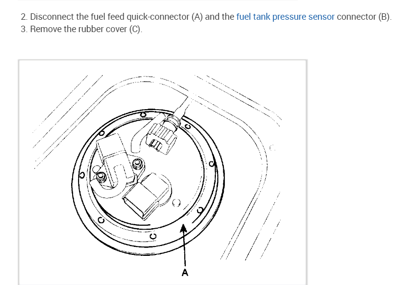

Where is the fuel filter?
Nov 21, 2019 at 11:50 PM
SCGRANTURISMO
  • 4,897 POSTS

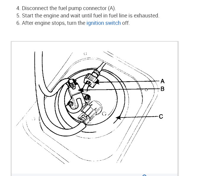

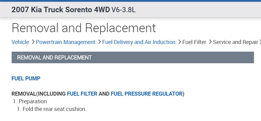

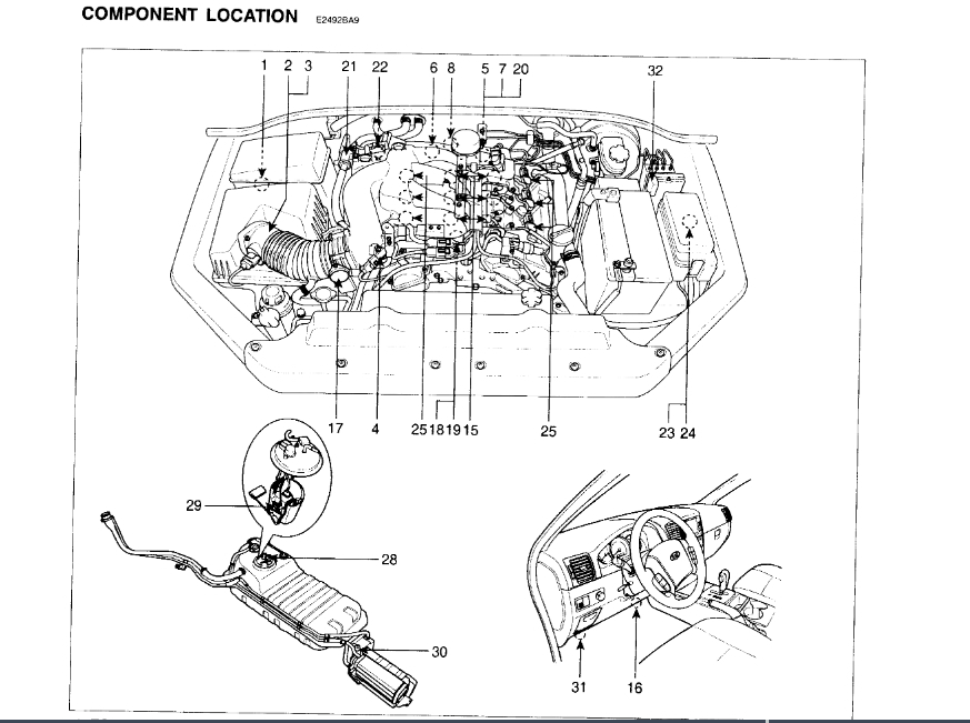

The fuel filter for your vehicle is an integrated part of the fuel pump assembly, which is located in the gas tank on your vehicle. In the diagrams down below I have included the instructions for the removal and installation of your vehicle's fuel pump assembly from the vehicle manufacturer for you. Please go through this guide and get back to us with how everything turns out, please.

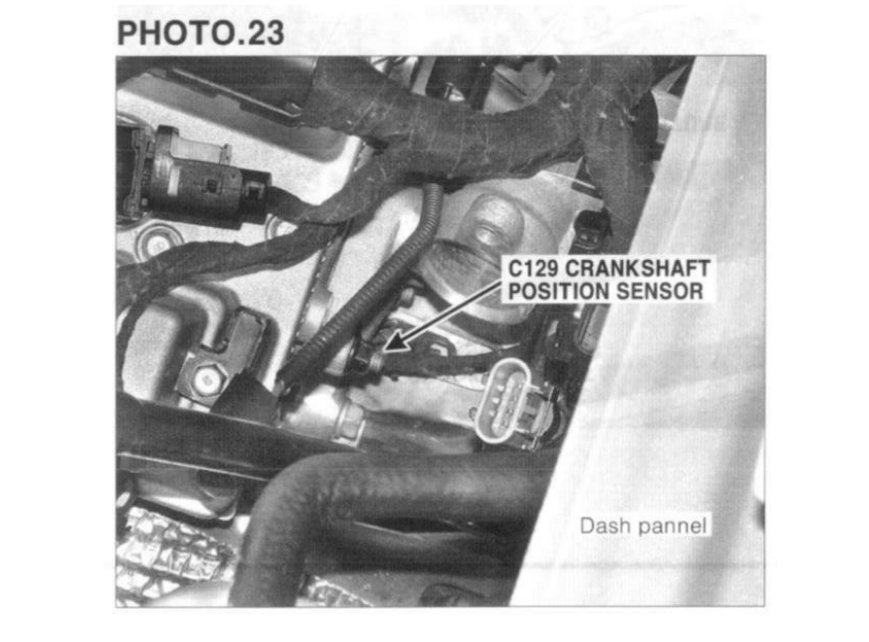

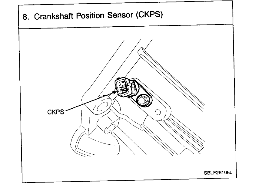

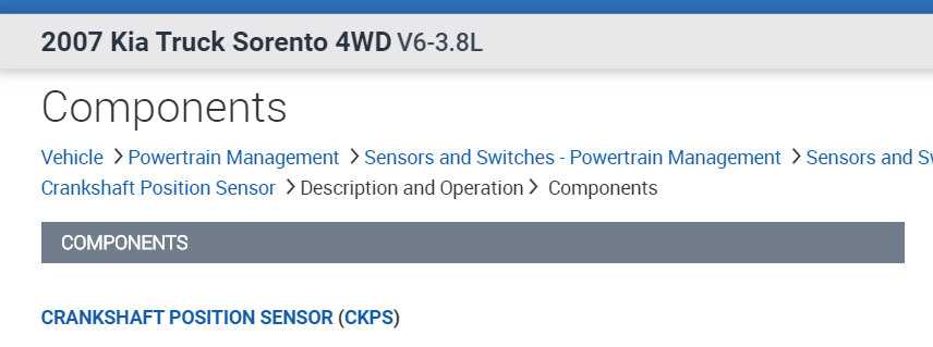

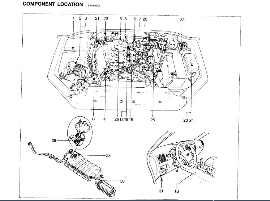

Okay, I just put a new fuel pump in but my car still not cranking but it will turn over.
Nov 22, 2019 at 12:21 AM
SCGRANTURISMO
  • 4,897 POSTS
Hello again,

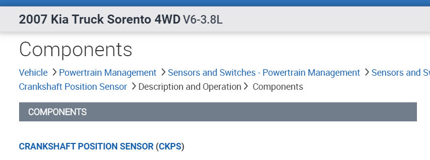

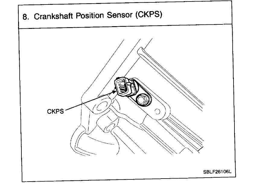

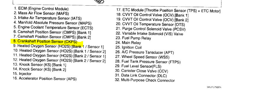

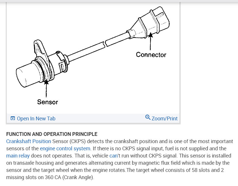

Okay, so this could be a problem with your vehicle's Crankshaft Position Sensor. To replace this sensor simply take out the bolt holding it in place and remove. Installation is reverse. Here is a generic guide below:
In the diagrams down below I have included the description and location of your vehicle's CKP for you. Please go through these guides and get back to us with how everything turns out.
