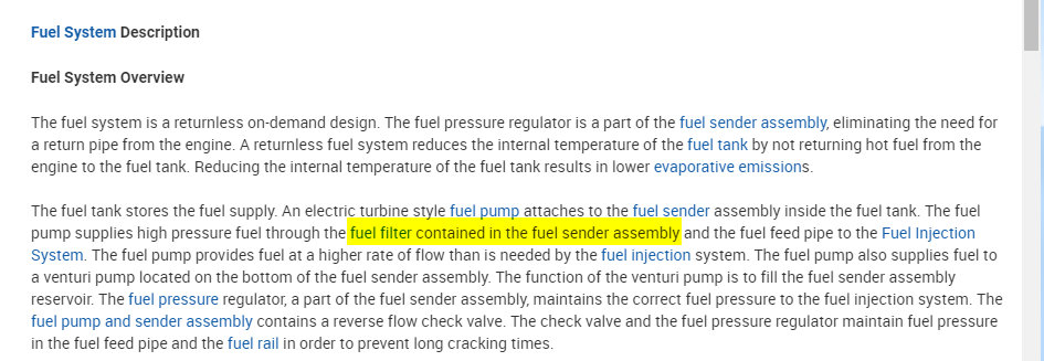

Where is the fuel filter located and can I just change it without changing fuel pump?
Jul 16, 2020 at 8:51 AM
Your filter is part of the fuel pump assembly in the tank. You do not need to change this unless you have to remove the pump for another reason.
I attached some info that explains this. Let me now if you have other questions. Thanks
